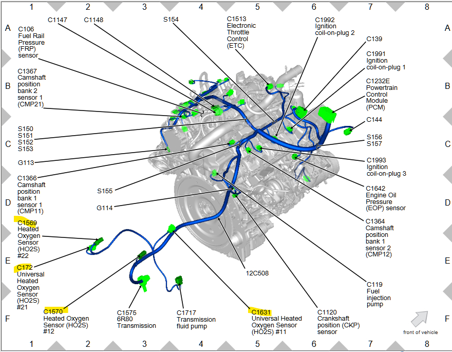

we basically want to know is the 6r80 the same in all, or are the electronics different on different 6r80 vehicles?
Oct 26, 2020 at 7:29 AM

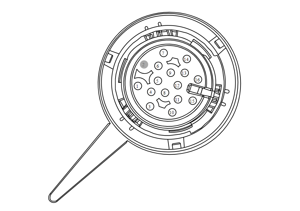

Okay, I attached the connector. They have to be the same. The transmission may be the same but the connector must be exact.
It is like the old GM 700R4. The connectors were different.
Connector:
C1575
Description
6R80 TRANSMISSION
Color
BK
Harness
12B637/12C508
Base Part #
part# N/A
Service Pigtail
See Below
Terminal Part Number Service Part Number Size
2R8T-14474-BA Not Available
NA Not Available
Pin Circuit Gauge Circuit Function Qualifier Terminal Part Number
1 RET33 (WH-VT) 20 SENSOR - TURBINE/TRANSMISSION SHAFT SPEED (TSS) - gasoline 2R8T-14474-BA
1 VET33 (WH-OG) 18 SENSOR - TURBINE/TRANSMISSION SHAFT SPEED (TSS) + diesel 2R8T-14474-BA
2 * * Not Used N/A
3 CET10 (BU-GY) 20 CTRL MOD. - POWERTRAIN # SOLENOID PRESSURE CONTROL (TCC) gasoline 2R8T-14474-BA
3 CET10 (BU-GY) 18 CTRL MOD. - POWERTRAIN # SOLENOID PRESSURE CONTROL (TCC) diesel 2R8T-14474-BA
4 VET32 (VT) 20 SENSOR - TRANSMISSION RANGE # PWM OUTPUT (TRP) gasoline 2R8T-14474-BA
4 VET32 (VT) 18 SENSOR - TRANSMISSION RANGE # PWM OUTPUT (TRP) diesel 2R8T-14474-BA
5 RE405 (GN-WH) 18 CTRL MOD. - POWERTRAIN # SIGNAL RETURN ENGINE (SIGRTN) 3.5L 2R8T-14474-BA
5 RE454 (YE-GN) 18 CTRL MOD. - POWERTRAIN # SIGNAL RETURN ENGINE (SIGRTN) 3.7L NA
5 RET42 (BN-BU) 18 SWITCH - TRANSMISSION SELECT SHIFT (SNS GND) diesel 2R8T-14474-BA
6 VET27 (BN-YE) 18 SENSOR - TRANSMISSION FLUID TEMPERATURE (TFT) diesel 2R8T-14474-BA
6 VET27 (BN-YE) 20 SENSOR - TRANSMISSION FLUID TEMPERATURE (TFT) gasoline 2R8T-14474-BA
7 CET25 (BU-GN) 18 CTRL MOD. - POWERTRAIN # TRANSMISSION SOLENOID POWER CONTROL (TSPC) 2R8T-14474-BA
8 CET16 (WH-BU) 18 CTRL MOD. - POWERTRAIN # SOLENOID SHIFT CONTROL (SSE) 3.7L NA
8 CET16 (WH-BU) 20 CTRL MOD. - POWERTRAIN # SOLENOID SHIFT CONTROL (SSE) 3.5L 2R8T-14474-BA
8 CET18 (GY-YE) 18 CTRL MOD. - POWERTRAIN # SOLENOID SHIFT CONTROL LOW-SIDE 1 (SS1) diesel 2R8T-14474-BA
9 CET05 (BU-GN) 20 CTRL MOD. - POWERTRAIN # SOLENOID PRESSURE CONTROL (SSA) gasoline 2R8T-14474-BA
9 CET05 (GN) 18 CTRL MOD. - POWERTRAIN # SOLENOID PRESSURE CONTROL (SSA) diesel 2R8T-14474-BA
10 CET08 (BN-WH) 20 CTRL MOD. - POWERTRAIN # SOLENOID PRESSURE CONTROL (SSD) gasoline 2R8T-14474-BA
10 CET08 (BN-WH) 18 CTRL MOD. - POWERTRAIN # SOLENOID PRESSURE CONTROL (SSD) diesel 2R8T-14474-BA
11 RET24 (BN-BU) 20 CTRL MOD. - POWERTRAIN # TRANSMISSION RANGE SIGNAL RETURN (TRGND) gasoline 2R8T-14474-BA
11 RET24 (BN-BU) 18 CTRL MOD. - POWERTRAIN # TRANSMISSION RANGE SIGNAL RETURN (TRGND) diesel 2R8T-14474-BA
12 LE111 (VT-GN) 18 CTRL MOD. - POWERTRAIN # BUFFERED POWER SUPPLY SENSORS (VBPWR) diesel 2R8T-14474-BA
12 LE111 (VT-GN) 20 CTRL MOD. - POWERTRAIN # BUFFERED POWER SUPPLY SENSORS (VBPWR) 3.5L 2R8T-14474-BA
12 LE111 (VT-GN) 18 CTRL MOD. - POWERTRAIN # BUFFERED POWER SUPPLY SENSORS (VBPWR) 3.7L NA
13 CET07 (GY-OG) 20 CTRL MOD. - POWERTRAIN # SOLENOID PRESSURE CONTROL (SSC) gasoline 2R8T-14474-BA
13 CET07 (GY-OG) 18 CTRL MOD. - POWERTRAIN # SOLENOID PRESSURE CONTROL (SSC) diesel 2R8T-14474-BA
14 CET06 (GN-BN) 20 CTRL MOD. - POWERTRAIN # SOLENOID PRESSURE CONTROL (SSB) gasoline 2R8T-14474-BA
14 CET06 (GN-BN) 18 CTRL MOD. - POWERTRAIN # SOLENOID PRESSURE CONTROL (SSB) diesel 2R8T-14474-BA
15 RET04 (YE-OG) 20 CTRL MOD. - POWERTRAIN # SENSOR OUTPUT SHAFT SPEED (OSS) gasoline 2R8T-14474-BA
15 VET26 (BN-GN) 18 SENSOR - OUTPUT SHAFT SPEED (OSS) diesel 2R8T-14474-BA
16 CET09 (YE-VT) 20 CTRL MOD. - POWERTRAIN # SOLENOID PRESSURE CONTROL (LPC) gasoline 2R8T-14474-BA
16 CET09 (YE-VT) 18 CTRL MOD. - POWERTRAIN # SOLENOID PRESSURE CONTROL (LPC) diesel 2R8T-14474-BA
