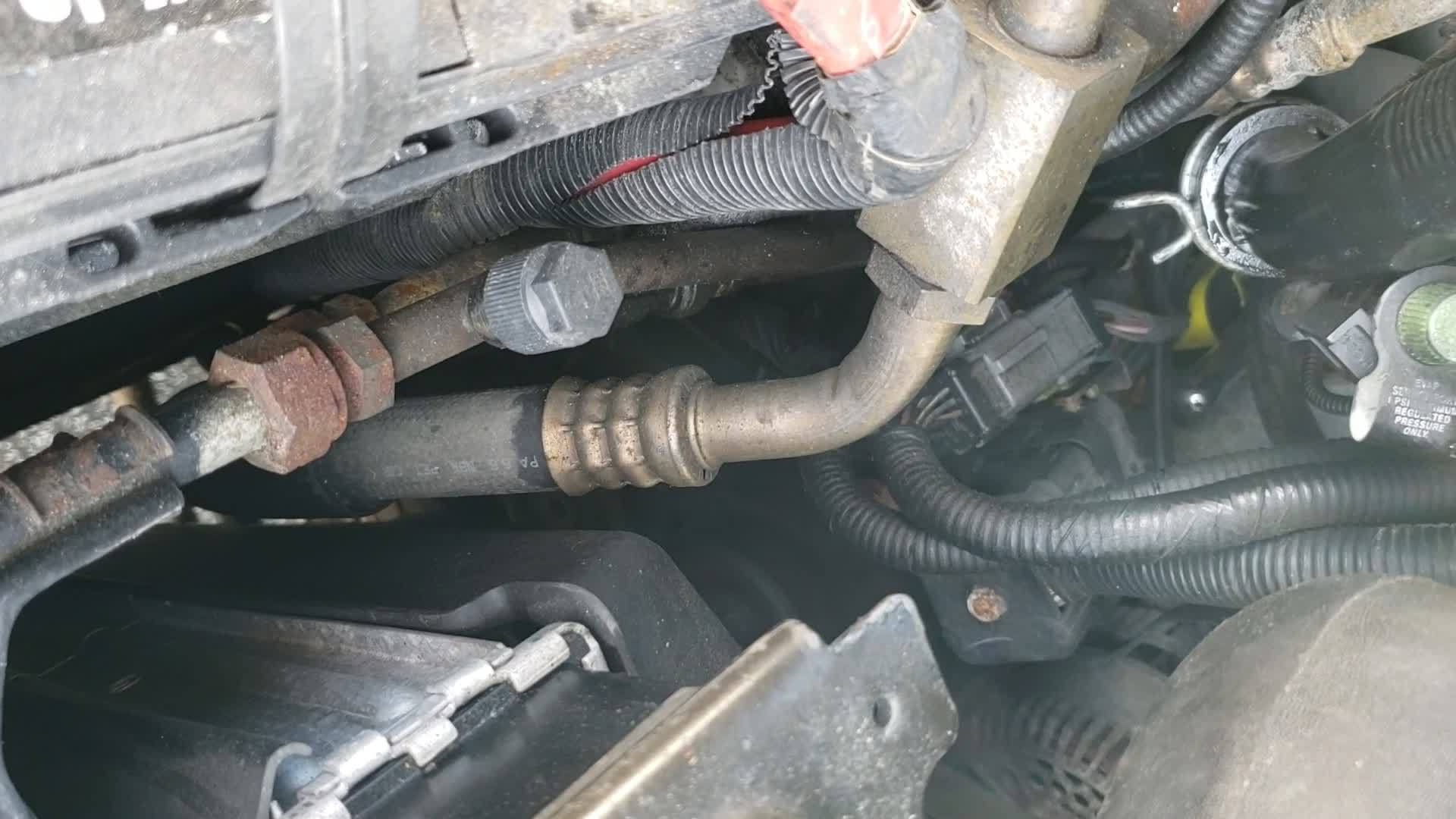

Hi, I purchased an E150 conversion van and noticed a knock that one mechanic said was catalytic (somewhat common from my research) and another said it was a rod knock (wallet visibly scared). I'm hoping its the catalytic converter. The knock does seem to speed up when gas pedal is pushed. I have driven it about 70 miles (city and highway) and have not lost oil pressure and no lights have come on. I did an oil change immediately with synthetic 5w20 and the old oil looked fine. I can't find exactly where the noise is coming from. Please let me know what you think. Thank you

Sorry to be the bearer of bad news but converters will not be a constant even tempo tapping like that especially if it gets faster as you apply throttle. They will rattle some and can thunk if the internals have failed but they don't sound like that. That is internal engine parts making that noise. Most likely a bad rod bearing. The good news is that you could check them and even change them out if the crankshaft is still okay without pulling the engine. You just need to unbolt the mounts and jack the engine up to get the clearance needed to get the pan off. Then you could check the clearances in the rods and mains. Before that though I would get a mechanics stethoscope and give a listen top and bottom to verify it isn't something cam related, it doesn't sound like it is but before you made a decision to tear it apart I would check it close.

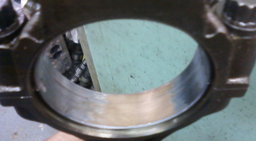

Below is what bearings that are worn look like or worse they have grooves cut into them which means the motor was only a short time away from locking up.

Doubtful given the location of the knocking and how loud it is combined with the tempo. Timing chains usually rattle as the links drag on the case. However that is why I said to get a stethoscope and use it to listen to the engine. You can hear where the issue is that way. A fast way to check without doing much would be to pull the plugs one at a time. If the sound stops or gets much less on a given cylinder you know it's rod knock.
