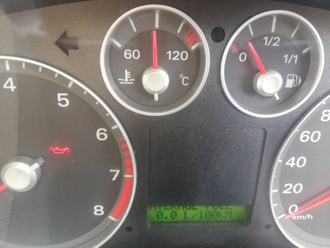

I was driving and it just cut off and didn't want to start again but only cranking. I took off terminal for few minutes and put it back to reset since the display unit was showing different than gauge on fuel gauge. And yes it did respond but still keep on cranking like it short of petrol.
Please help me.

Yes we found that we missing the spark. but when they put it to diagnosing devices it shows no fault.
