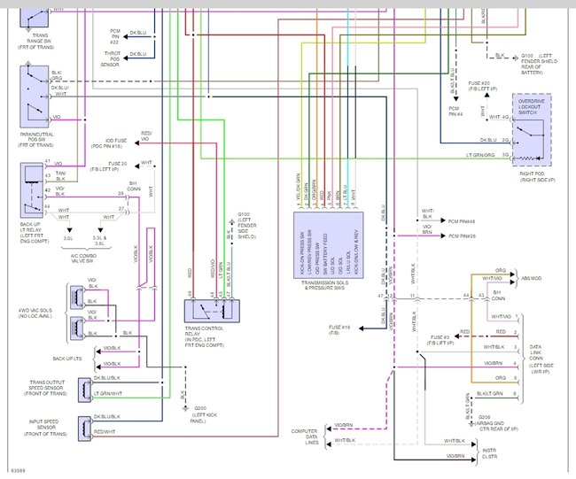

can the shift solenoid on a 41te transmission be checked either on or off the vehicle?

On the car. what are the symptoms and do you have any codes?

symptoms include limp mode

I don't have a transmission scanner, so how can the shift solenoid be checked and tcm be checked with a vom ?

Check the input and output sensors also check the connections at them... there has been many issues with them..does your speedometer work

checked connections at in,output sensors seem fine no corrosion.yes speedo works

If u have a ohm meter check to see if the sensor has a open circuit

ok so which sensor

All of them you can find, you are looking for an open circuit in any of them.
Please run some tests and get back to us so we can continue helping you.

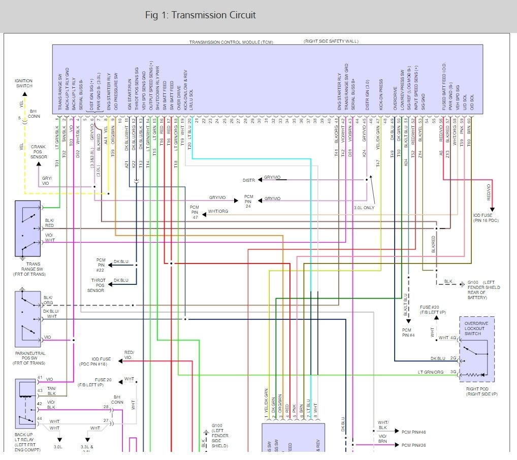

Hey Dodgepodge,
Like I dream of Jeannie, love it cant belive that didn't work. Here is a complete wiring diagram so help with all that blinking and swearing.
Please let us know what you find so it will help others.
