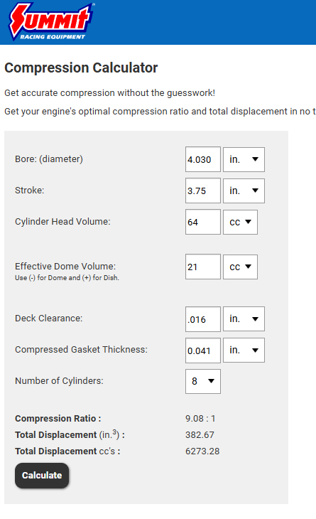

I've been watching Ryan's videos on building the 383 engine. I've got an '85 Chevy K20 that currently has a tired 454 in it. I want to build a 383 for it but I've never built an engine before. I asked Ryan a question about building a 383 truck engine on his latest 383 video and he said that this build would be perfect for a truck application, but he said that I'd want to lower the compression to about 9:1 and put in a different cam. So, my questions are, exactly what do I do to lower the compression? Is it a matter of just putting in different pistons and if so, exactly what pistons do I need and exactly what cam do I need? Thank you.

Thank you so much for watching the 383 series! So for lowering the compression ratio you either need a bigger combustion chamber in the heads or bigger dished pistons.
To decide on which to do check out this awesome compression calculator from Summit Racing https://www.summitracing.com/popup/calcsandtools/compression-calculator?srsltid=AfmBOor9OVeILCrtBhOANTvZvfXQiMxU7D7B85aI_YPnNPpKLJ2HGuih
If you use the same cylinder heads I am using, you can put these pistons in and get 9:1 which could run on 87 pretty easily and have good power still. https://www.summitracing.com/parts/uem-kb101-030/make/chevrolet
Just double check the wrist pin size and the cylinder bore!
For a camshaft something like this would be a good bet for a truck 4x4 application https://www.summitracing.com/parts/sum-1102/make/chevrolet
I have uploaded the calculator to show what it would look like with this combo.
Also here are the heads I plan on using, we have not gotten to this part on the build. https://www.summitracing.com/parts/SUM-162112
Good luck on your build, let me know how it goes!

Thank you for directing me in the right direction. This is probably a silly question but, the stroke on the pistons you're installing in the series is 3.750 in. and the stroke on the pistons you suggested to me is 3.480 in. That's not a bad thing, right? Thanks
Dec 10, 2024 at 7:33 AM
RYAN L
  • 272 POSTS
It would change the wrist pin height and affect the total volume of the cylinder a bit. My apologies. These should be everything right https://www.summitracing.com/parts/uem-kb121ktm-030/make/chevrolet but again check the wrist pin diameter. With these your compression ratio should be high 8's which is still solid for a street truck.
