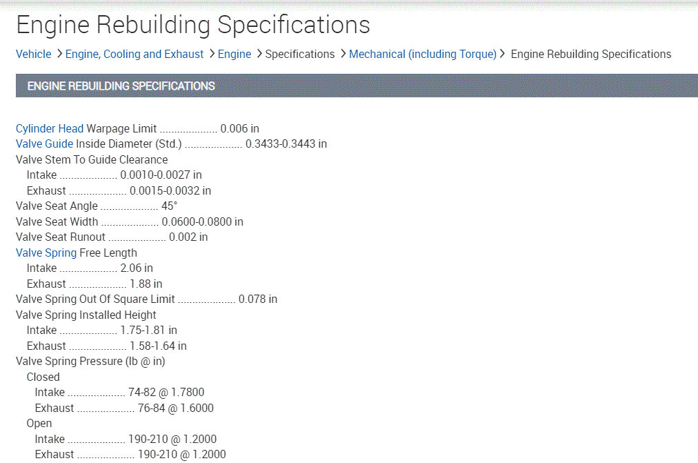

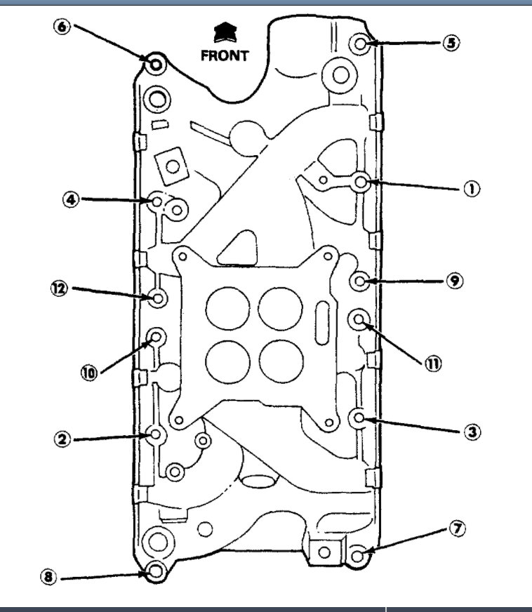

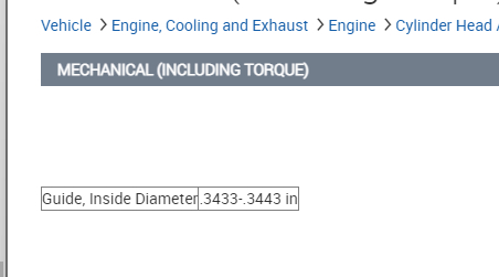

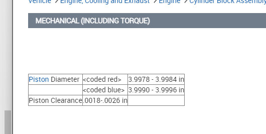

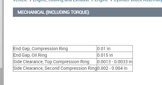

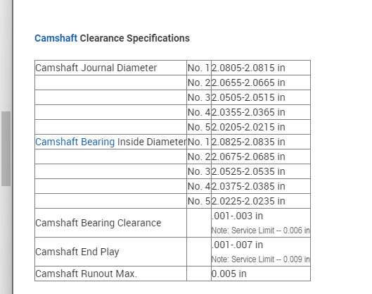

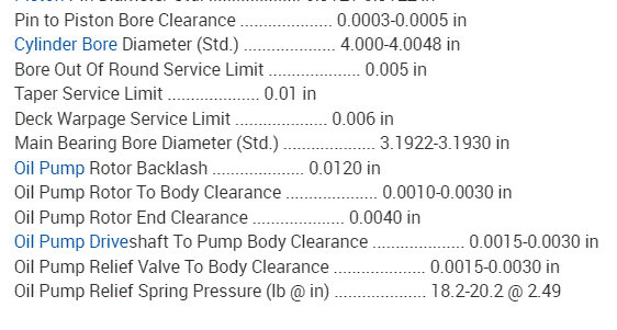

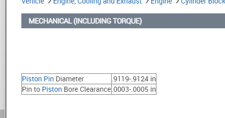

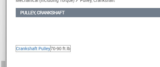

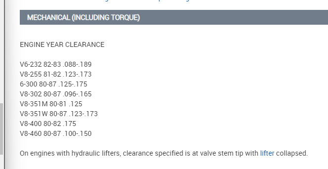

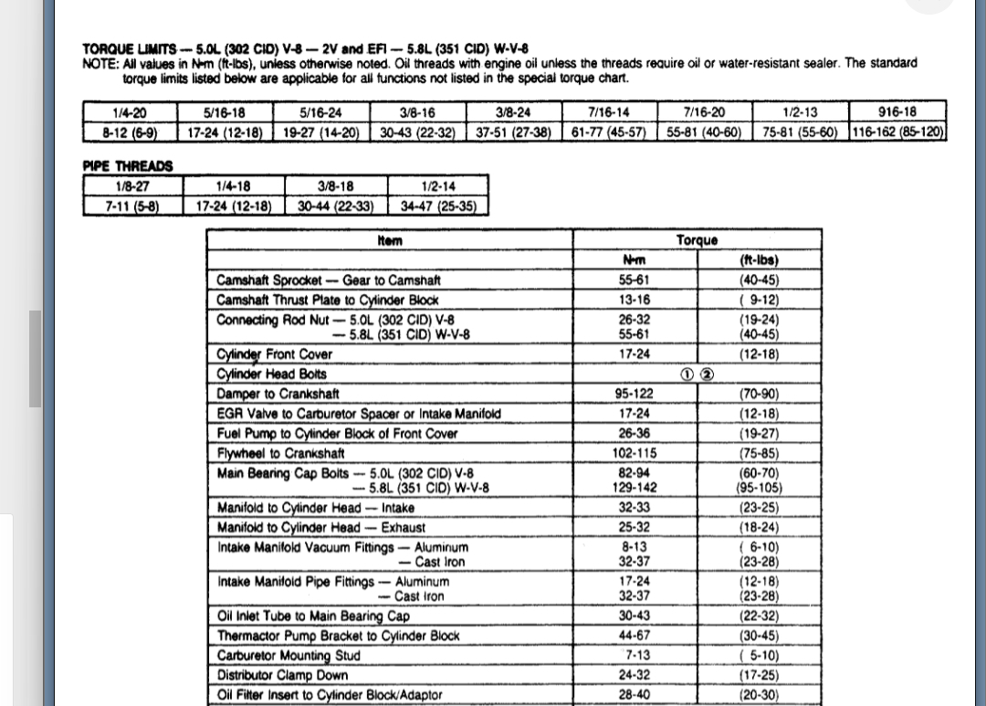

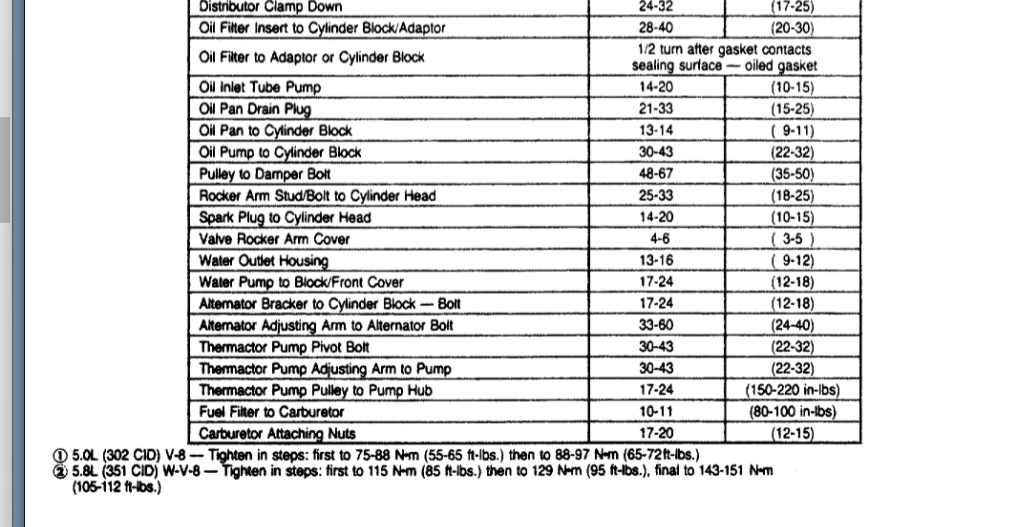

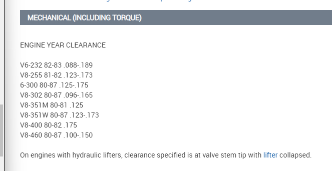

Hey Joe, I completely understand and honestly respect that you do that a lot more as far as what I'm wanting is pretty much just complete rebuild guide. Torque specs, clearances, timing. It's for a v8 create motor. I really do appreciate you guys you're amazing!

You are very welcome. People like you are appreciated here as well. I hope the truck is still running good. As far as the rebuild, do you have a year and model vehicle? For example, is it a 5.8L (351ci) from a 1987 F-150? I just need to get the right info. The model year is important, and if I remember correctly, you said it was a 5.8L.

Hey Joe, I apologize the year is 89 and you are correct it is 5.8L.

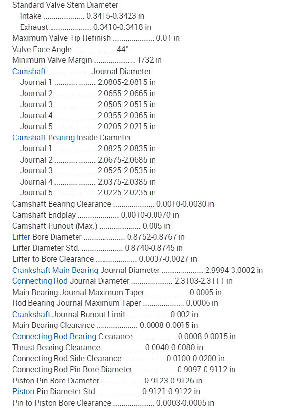

First, I have to apologize. Because of the model year, I have no rebuild directions. I had to go to 1996 to get the rebuild specifications, which I attached.
Here is what I suggest. I will help you through this one step at a time if needed. I really feel bad I don't have the specifics for you.
Let me know how I can help.
See pics below for rebuild specifications.
Nov 15, 2021 at 1:06 PM

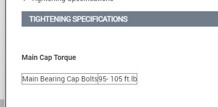

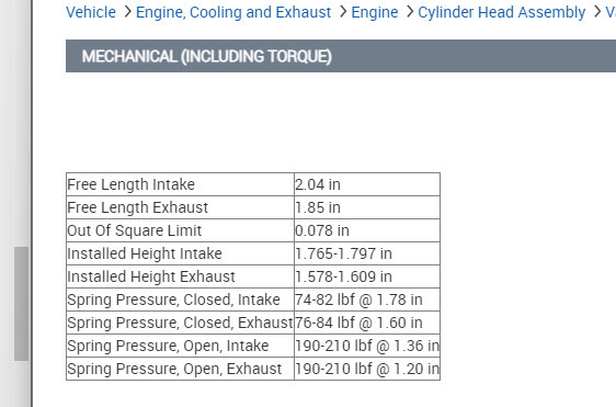

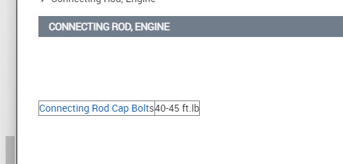

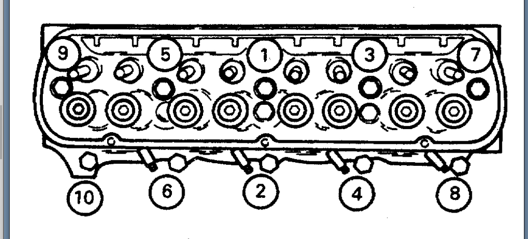

I don't really need a rebuild guide as I know how to build it was just looking for specs on torque and measurements. As always, I appreciate what you guys do and how quick you all reply. Thank you!
Nov 15, 2021 at 1:18 PM
Hi Justin,
Joe may not be on tonight so here are as many of the torque specs that I could think are related to what you may be doing.
Please run through this and let me know if we missed something and we can find it and send it over.
Nov 16, 2021 at 8:23 AM
