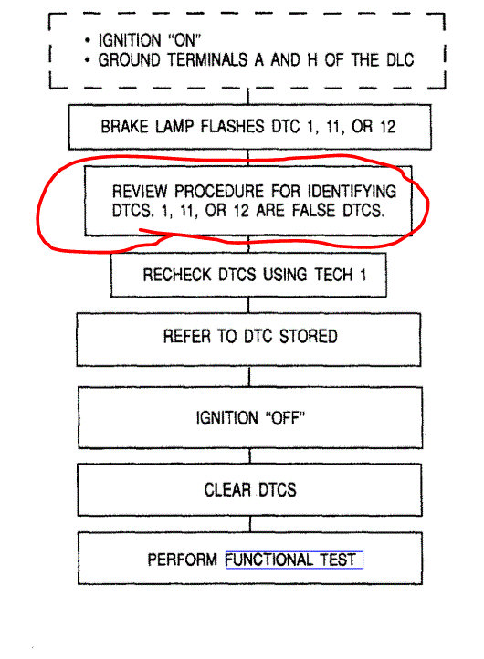

  • 110,236 POSTS
According to the manual, code 12 is a false code. Take a look at the attached pic. That is what I find when looking for a code 12. Are you certain that is the number?

  • 110,236 POSTS
Basically, I attached the pic so you could see, according to Alldata, there is no relevant code for 12. Have you checked for a good ground and power to the PCM?

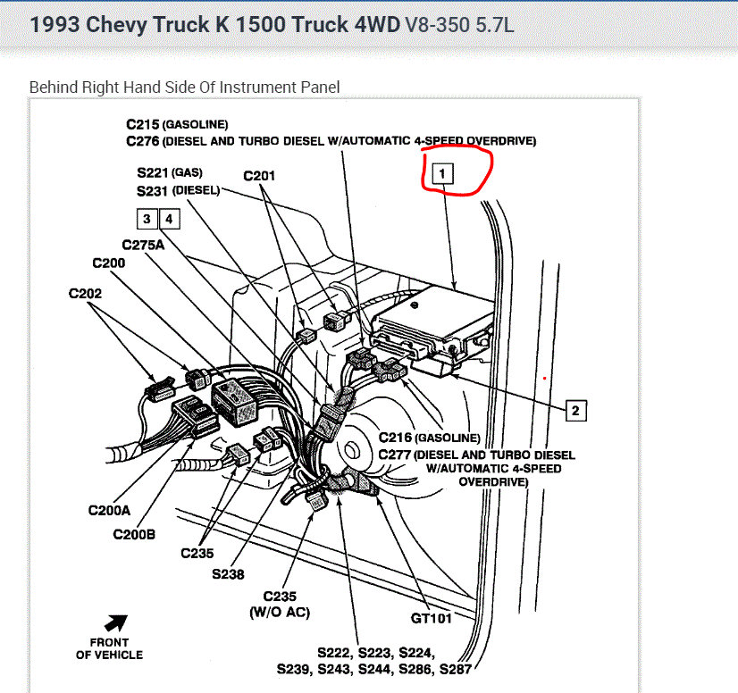

  • 110,236 POSTS
First, before you unplug or reconnect any control module (PCM) make sure the battery is disconnected. You can reconnect the battery after the component is disconnected or reconnected.
I attached a pic of the location of the PCM. To start, first locate and confirm the connections are tight. If they are, disconnect the battery and then unplug the PCM. Check for corrosion, dirt, or any damaged pins.
Let me know what you find.
