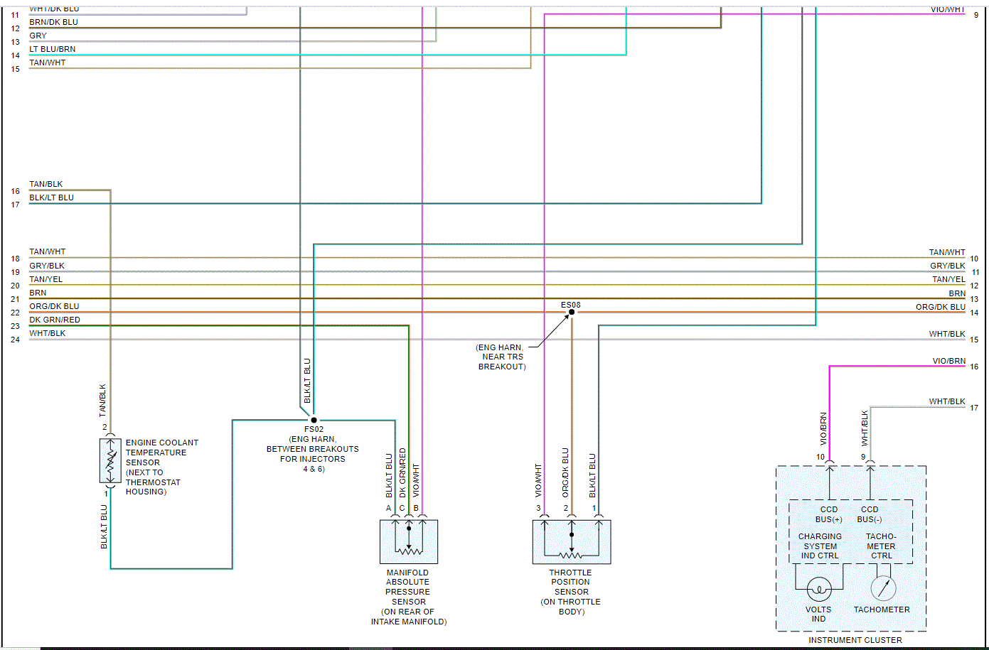

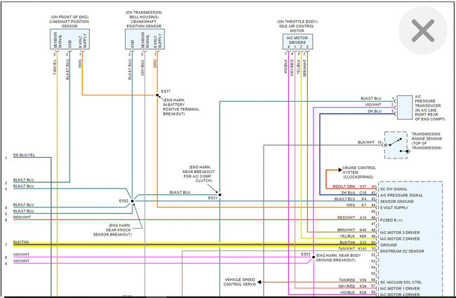

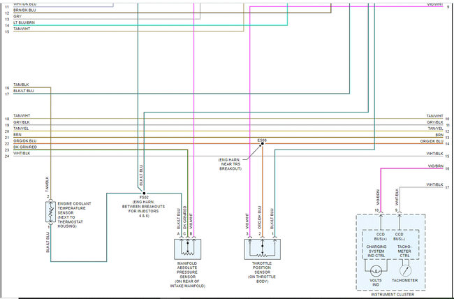

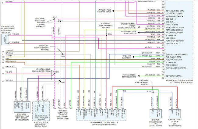

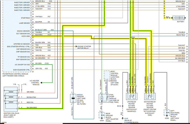

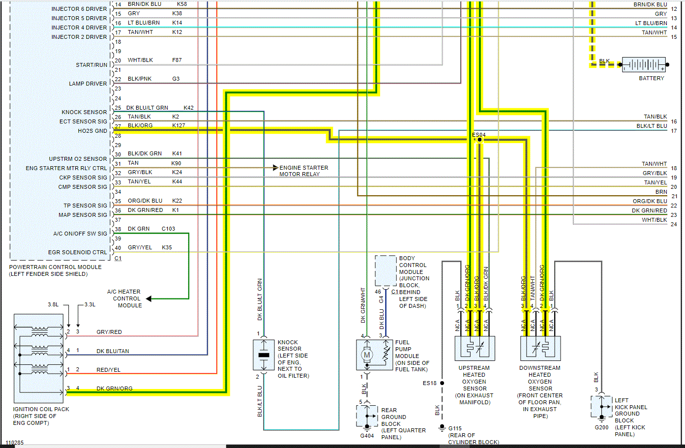

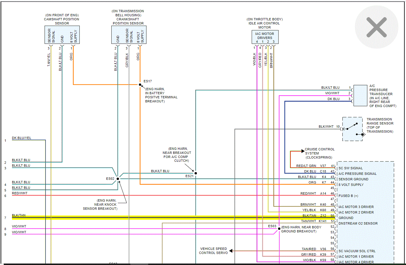

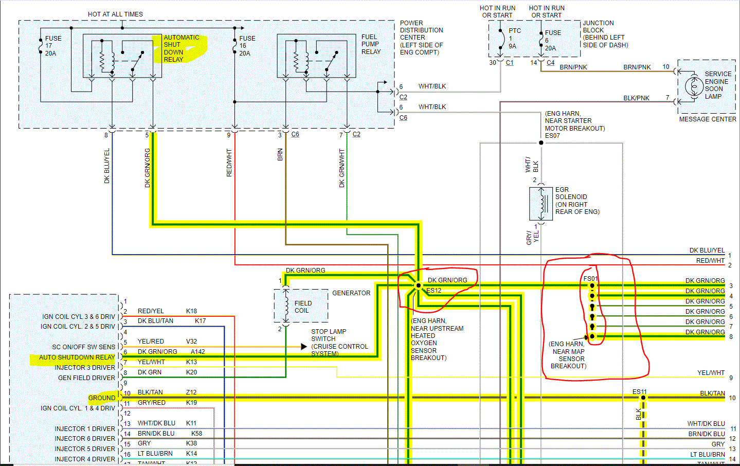

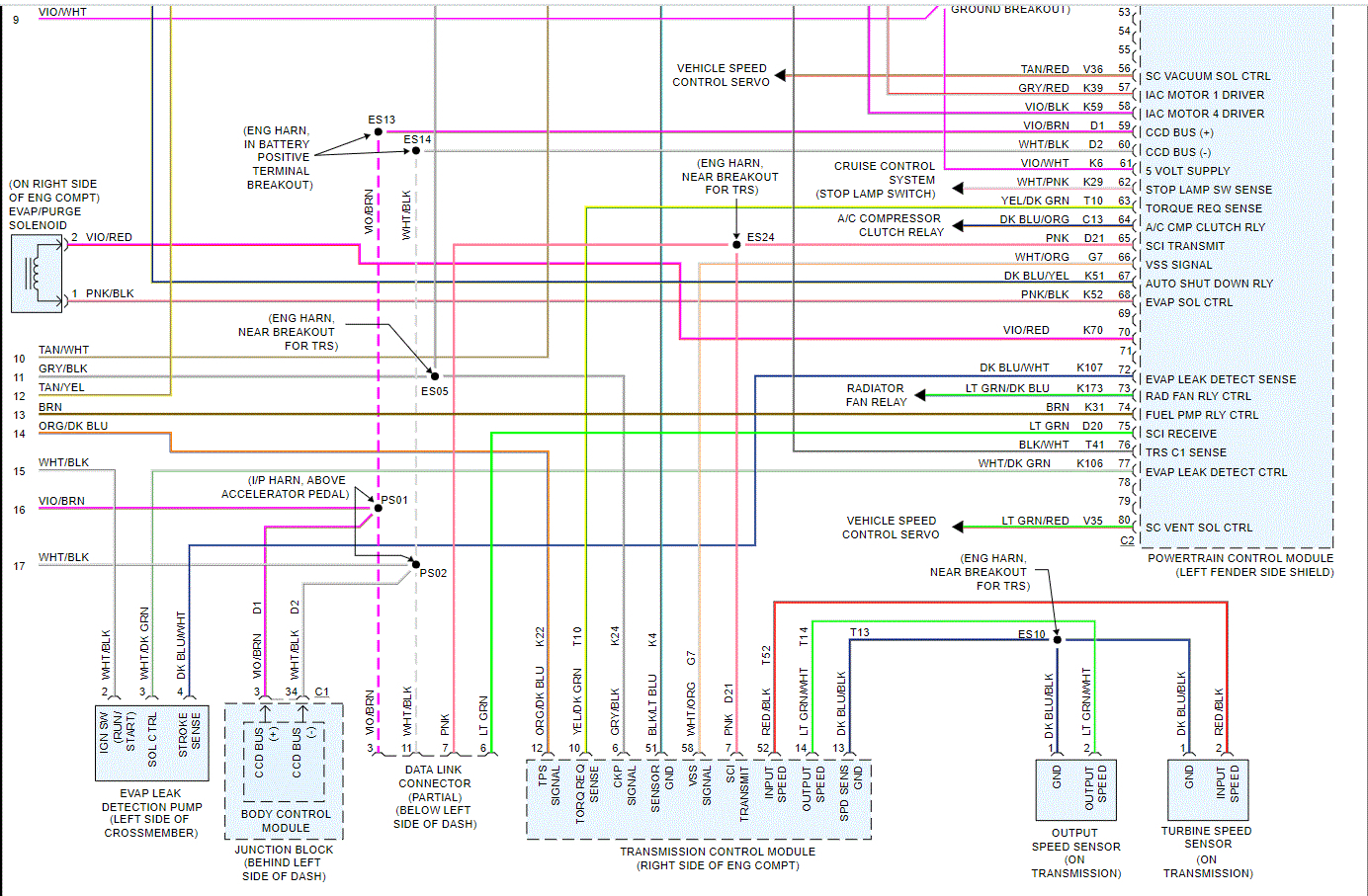

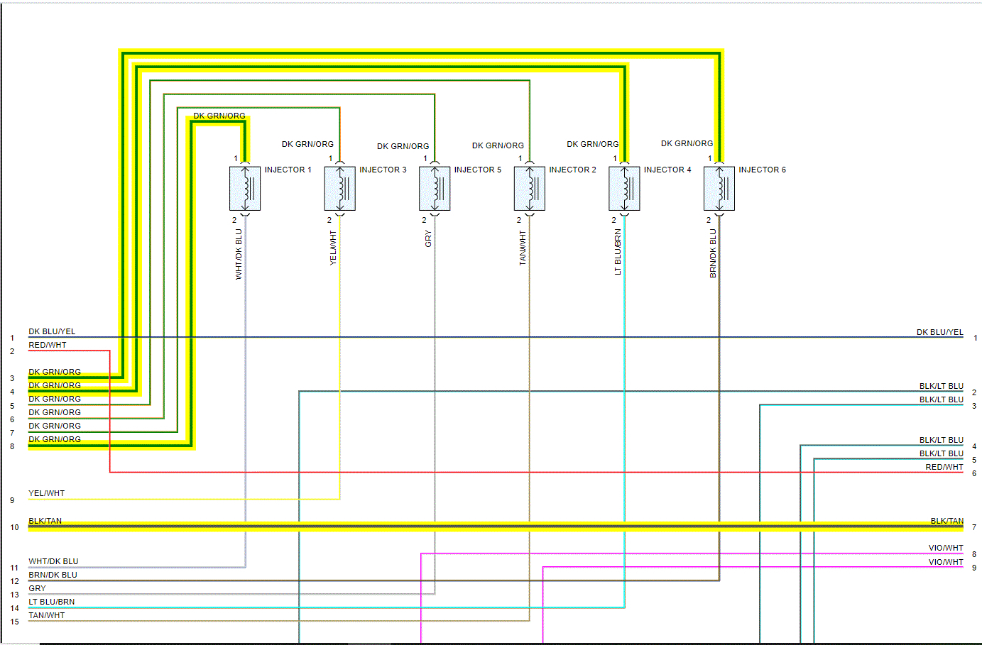

Something is telling me we have a connection issue. I attached the entire wiring schematic below for the powertrain management system. I highlighted everything related to the ASD (automatic shut down) system. If you haven't already, switched that relay with one in the relay box having the same part number.
If that doesn't change anything, I need you to seek the splices I have highlighted in pic 1 and check to see if they are in good condition. If they are bad, it shuts down the injectors and ignition coils.

I'll check it out. I bought a Haynes, used manual. Used to love these things. I bought a new ASD relay month ago. Swapped with trans relay, no change. I'll check out the wiring. Geeeez. Thank you much.
