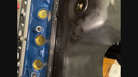

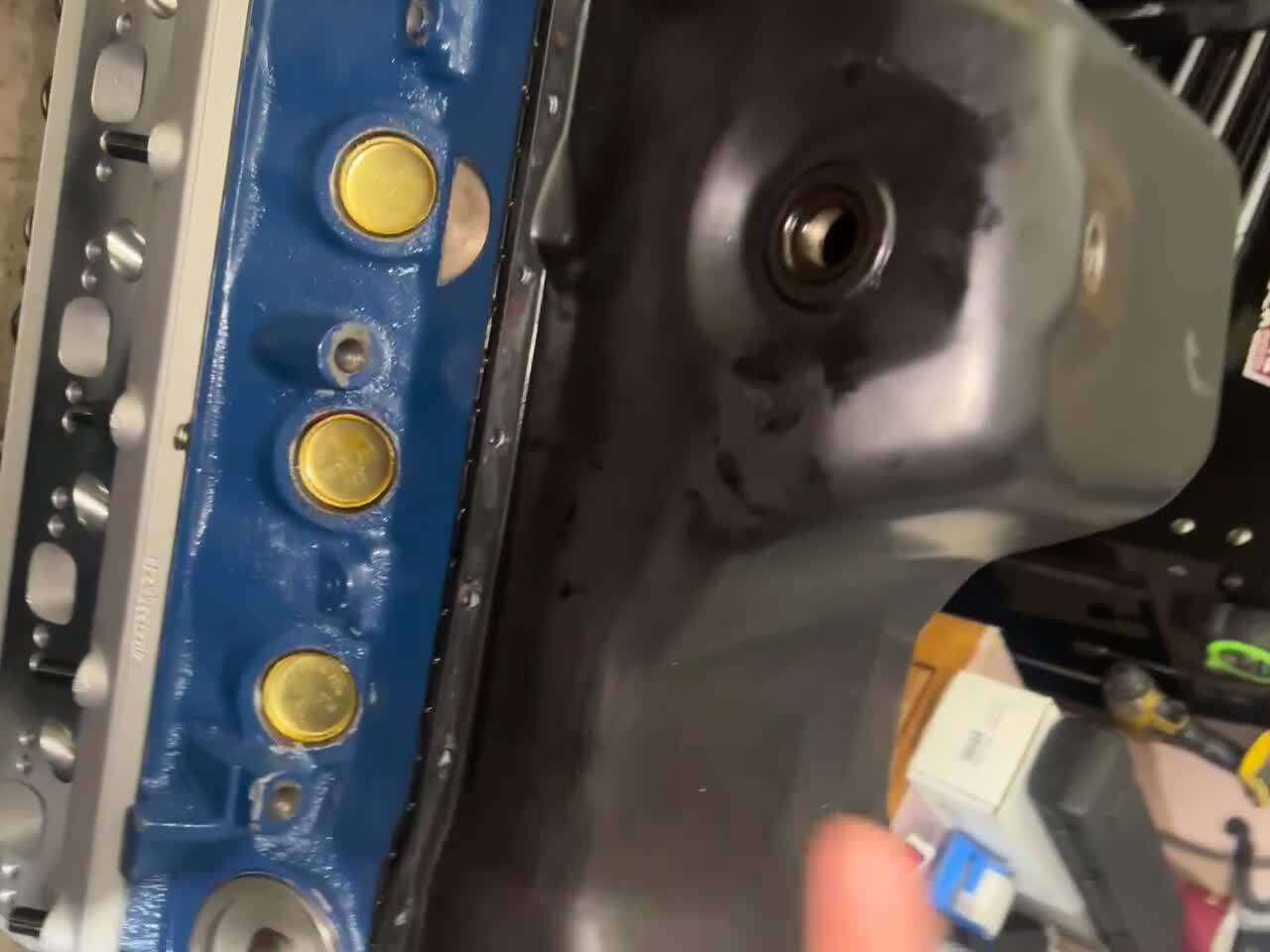

Hey Ryan, quick question is there supposed to be a gap between the oil pan and the oil filter tube? I installed a high flow oil pump and new oil tube but I’m getting a small gap in between.
Apr 21, 2023 at 12:01 PM
RYAN L
  • 273 POSTS
Any chance you can post a picture of what you mean? I want to make sure I am on the same page as you so I can answer as accurately as possible.

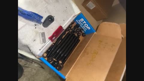

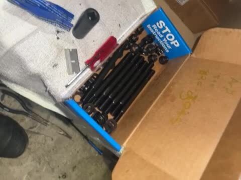

Hey Ryan, question for my arp bolts I only got qty of 10 step washers that I installed in the bottom, I was wondering if the step washers only go on the bottom. Or do I need to install them for all 20 holes?
May 1, 2023 at 11:07 AM
FOXBODY.302K
  • 21 POSTS
Oil pan clearance .
May 1, 2023 at 11:31 AM
RYAN L
  • 273 POSTS
Hey there!
So, it looks like you got sent the wrong stud kit. The kit you have there is for a Ford but for an inline 6 application.
Here is the link for that:
https://www.summitracing.com/parts/arp-152-4201
What you need is this kit that has 1/2 inch to 7/16 inch reducers because you have high performance aftermarket heads. I ran into the same problem with my AFR heads on my build. https://www.summitracing.com/parts/arp-154-4005/make/ford
So, return that first kit and order the second one.
For the clearance on the pickup .250 inch to .500 inch is ideal. Typically, if you are using the pick up that came with the pan you are fine.

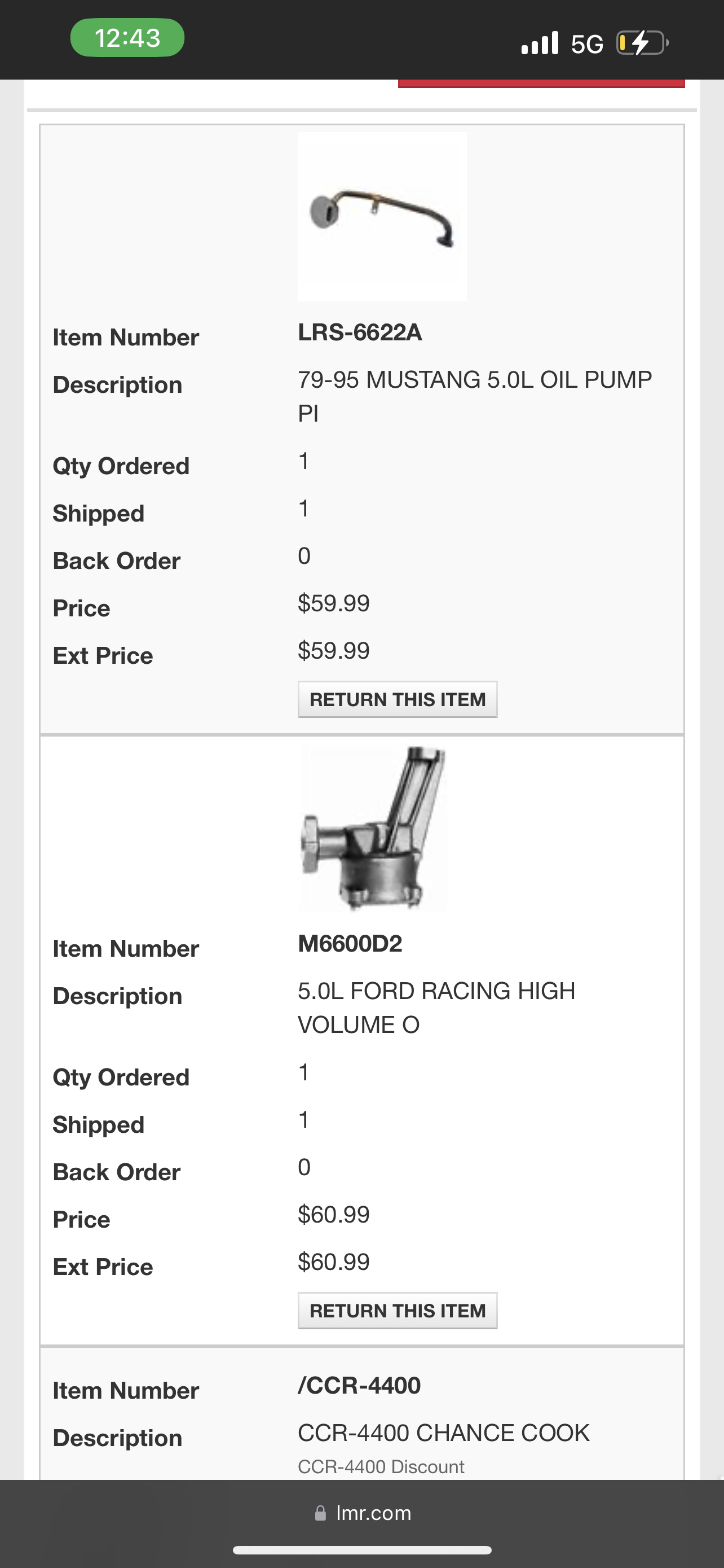

Got it. So, I should order the second link for 1/2 - 7/16.? And I’m using the same tube just ordered it new. And a high flow oil pump .
May 2, 2023 at 4:21 AM
RYAN L
  • 273 POSTS
Correct!
Can you link me the oil pump? Just want to make sure it has the same installed height as the stock unit. It should but it does not hurt to double check.
Best,
Ryan
May 2, 2023 at 4:57 AM
FOXBODY.302K
  • 21 POSTS
Got them from LMR .
May 2, 2023 at 5:44 AM
RYAN L
  • 273 POSTS
Yeah should be fine, but you can look in your bottom oil drain bolt and see if there is about a half inch gap.

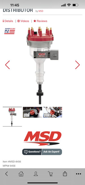

Hello Ryan. So, I was wondering if you may know what distributor will be a good one to go with the setup that I have? Will the MSD be a good one to run?

Love all the MSD stuff. I have spoken with a guy that worked at MSD and he said their Street Fire line is budget friendly but works the exact same as their top of the line. I have one in my Camaro and love it. Just make sure you get one for a SBF and that the gear on your camshaft is compatible with the gear on your distributor.

No worries, Ryan. Thank you for getting back to me. Congrats to your buddy’s wedding and also, I want to thank you for answering all my questions about my build I highly appreciate it couldn’t do it without you. So, I have this MSD distributor which I was wondering if it’s a good one to run for the setup I went with.
•b303 cam
•summit racing heads part # SUM-162SBF185WIN
•trick flow forged pistons part # TFS-51404000
•rocker arms trick flow TFS-51400510
May 11, 2023 at 4:51 PM
RYAN L
  • 273 POSTS
No problem! That is what I am here for! Thank you!
So that depends if you are running EFI on your build. That unit has a computer controlled advance curve which is cool but you need the right computer. If that is what you are running, then this unit is perfect!

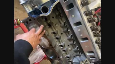

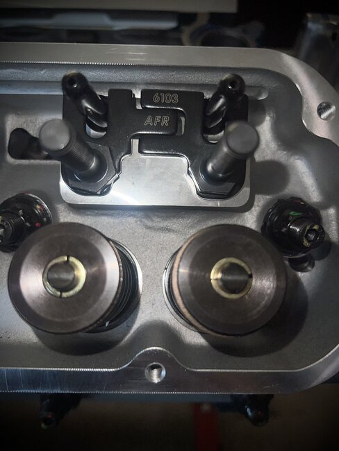

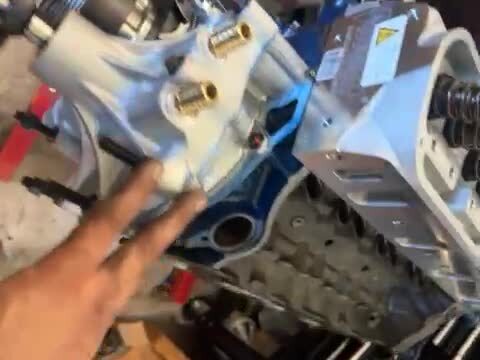

Hey Ryan , I had a question so I’m installing my rocker arms I was wondering if my guide plate lettering needs to be facing down ??
Jun 13, 2023 at 8:58 AM
FOXBODY.302K
  • 21 POSTS
This is what I have so far.
Jun 13, 2023 at 11:02 AM
RYAN L
  • 273 POSTS
Hey great question! I had to look it up because off the top of my head I would had said up. But past me said this https://youtu.be/DVVW_mgo1YE?t=192 face down. So, I would have read that out of the directions that came with the heads so that is got to be it. You might want to double check yours just in case they changed it for some reason although I do not see why they would. Thanks for using 2CarPros!
