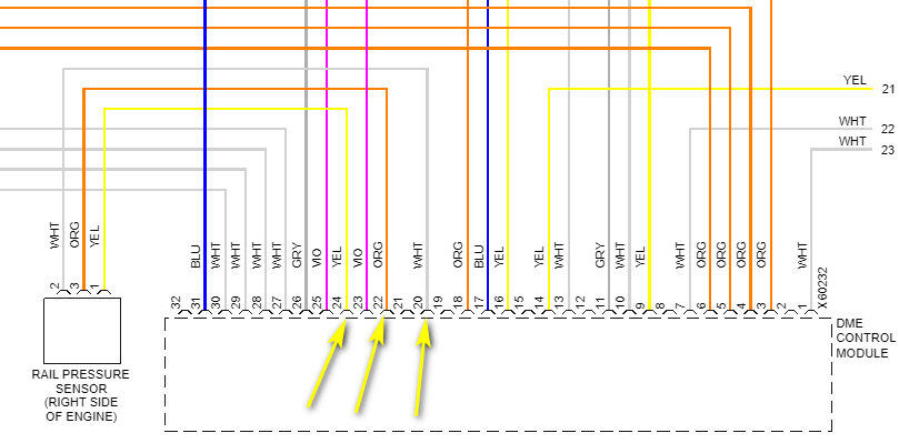

so, i have the vehicle listed above, i replaced the timing chain and it started ran good. when i was driving it began to overheat. so, i had to replace thermostat housing and recovery tank. put it all back together now it is giving me a P2848 dme fuel pressure sensor problem. runs bad and idles rough gets hot quick?

Code 2848 relates to P0190 - fuel pressure sensor open circuit.
Suggest checking that the connector is plugged in correctly, check that there are no lose pins or broken wiring back to the DME.
A good article:
https://www.pelicanparts.com/techarticles/MINI_R56/92-FUEL-Fuel_Rail_Pressure_Sensor_Replacement/92-FUEL-Fuel_Rail_Pressure_Sensor_Replacement.htm
See wiring diagram below.
Regarding the overheating issue, did you bleed/burb the cooling system properly?
