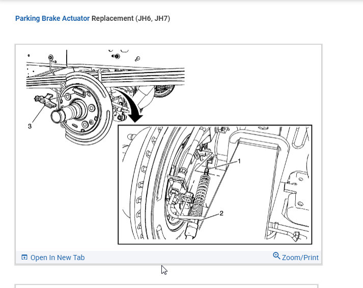

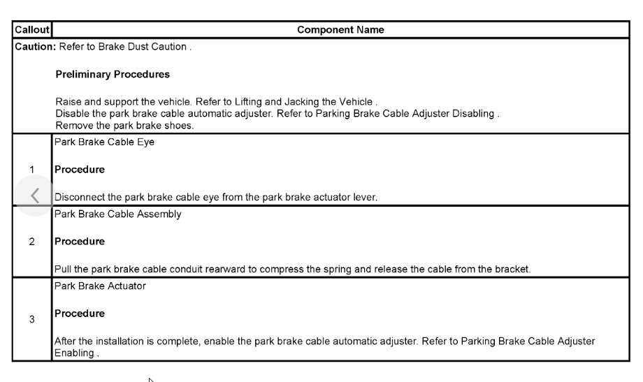

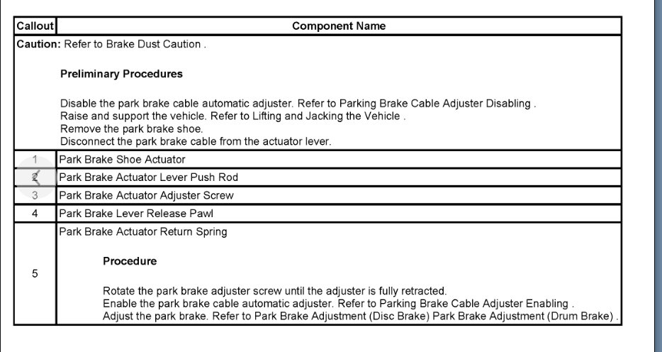

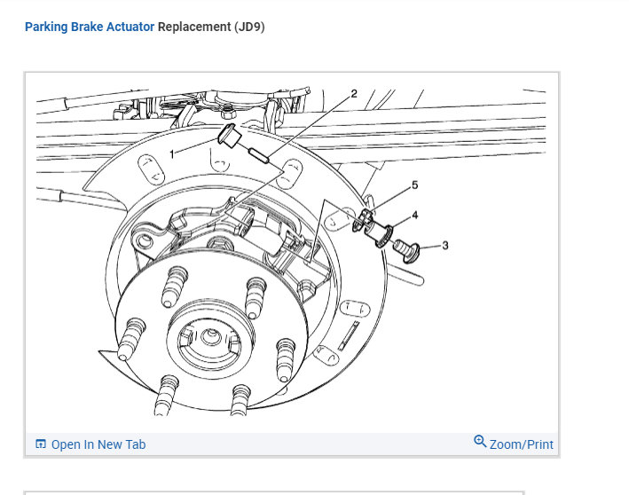

Truck listed above is 2500hd. The E brake pads won't expand on setting pedal, on passenger side. Cable extends and contracts at backing plate, though. I think the actuator is seized. How is it removed? E brake pads can be replaced without pulling the axle out. Is the same true for the actuator assembly?

Here are two videos to handle both 2500, 3500 and 1500 parking brake shoe replacements with diagrams below to help as well.
https://youtu.be/EMxfb9X3ywE
and
https://youtu.be/uo1RnATyEok
I attached the process for the actuator on both models as I am not sure how yours is equipped. You do not have to take the axle out. Let me know if you have questions. Thanks

My 2500hd has the JH6 format brakes, so the second set is it.
