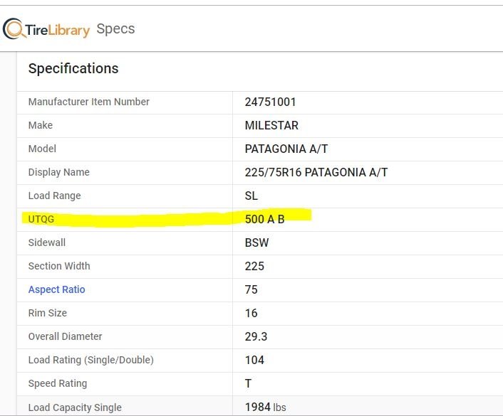

Hi again:
Those tires are more of a highway tire, but they do have an all season rating. They are very similar to the Goodyear in design.
Here is a key element to look for when selecting. The tire's tread wear (UTQG) is a very good indicator of how many miles you can get from a tire. The tires you indicated above both are over 600 which is good. The lower the number, the less miles you will get. If they go under 400, don't waste your money.
I live in the north to some degree as well, PA. I understand your concern. If I had to chose from the two above you sent, I would most likely go with the first one you listed. Please keep in mind, it isn't an aggressive tire for snow.
I attached a pic. In the picture, I highlighted the tread wear (AKA) UTQG rating so you know what to look for. The tire listed has a 500 rating which isn't bad for as aggressive it is.
Let me know if I can help.
