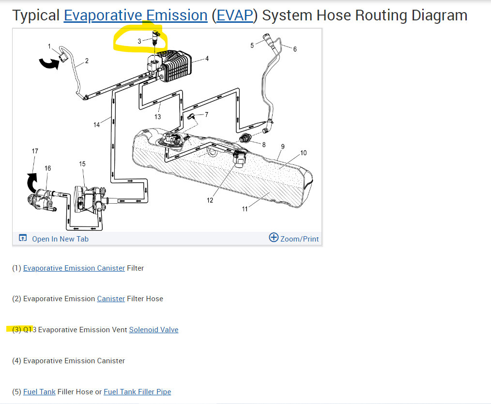

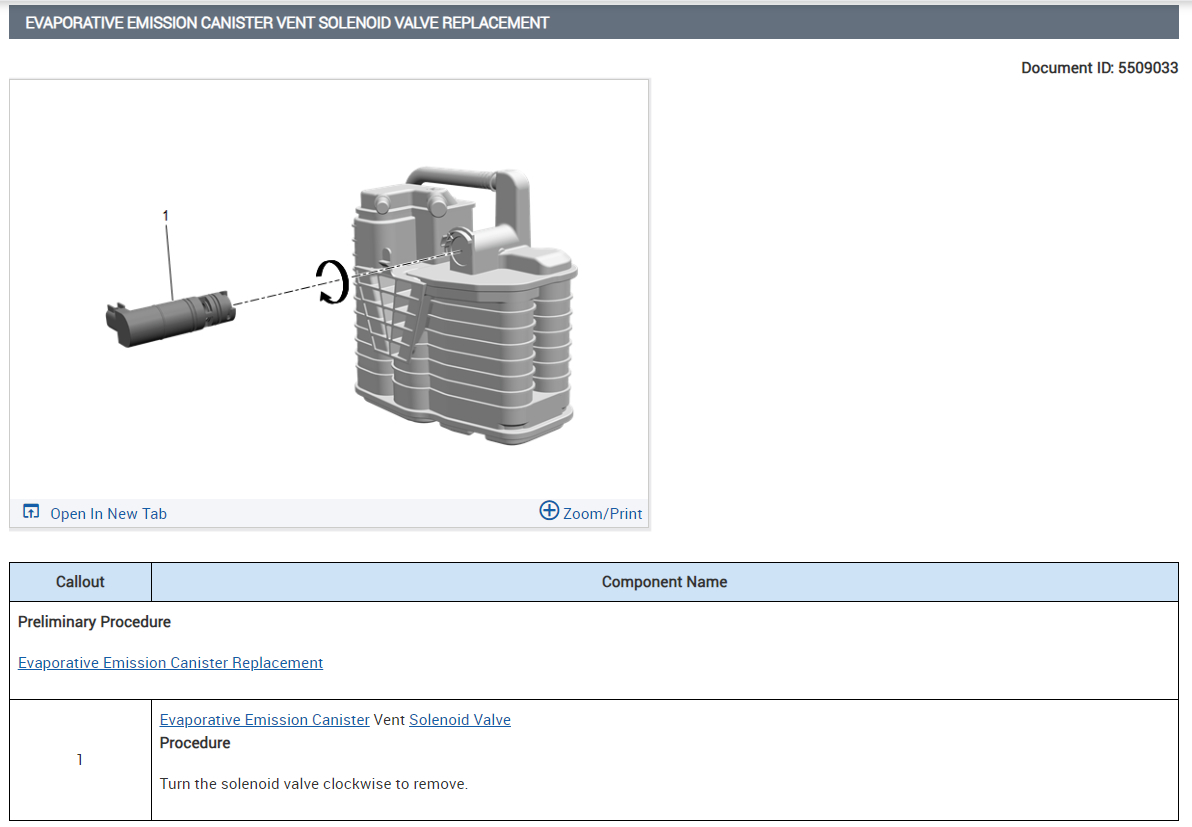

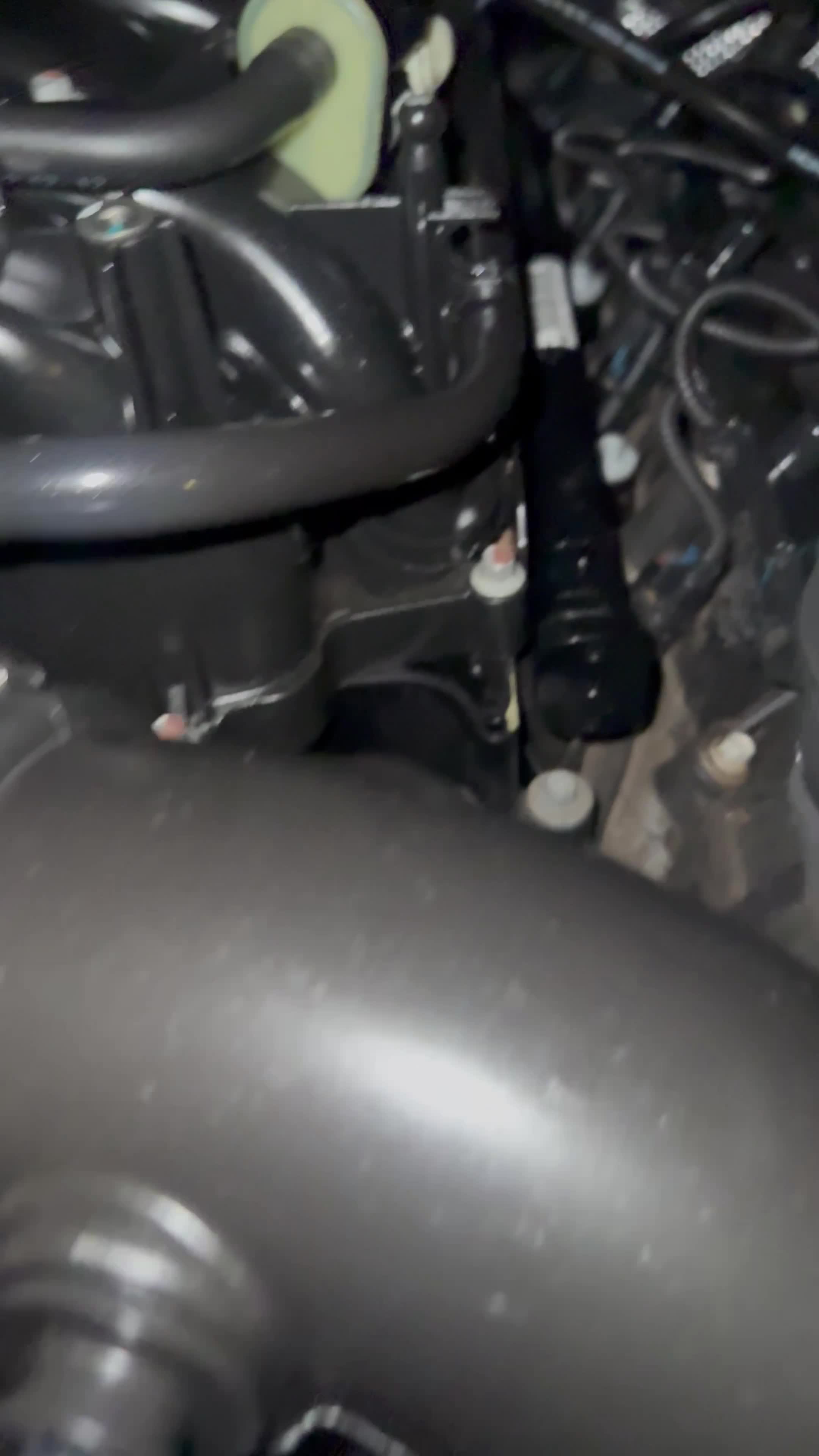

Looking for the location of the vapor canister vent valve on the vehicle listed above with a 1.4 motor.
Dec 13, 2023 at 12:23 AM
AL514
Experienced Mechanic
5,697 POSTS
Hello, the vent solenoid is right on the Evap canister, it twists out of the canister. I'll post a diagram of its location.
https://www.2carpros.com/articles/evap-system-code-repair
