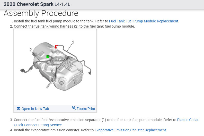

How to change the fuel pump?
132,077 MILES
GRACIEJ

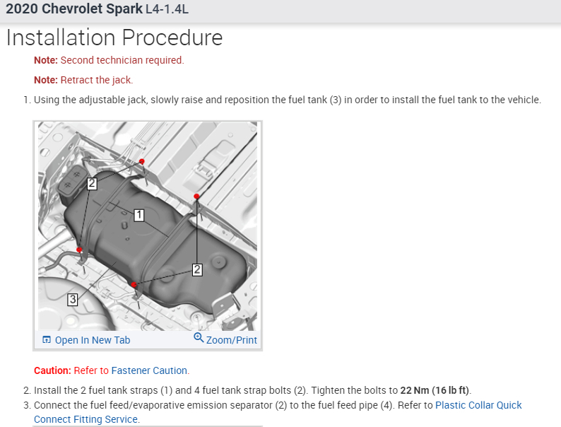

And where is the fuel pump reset button on the car listed above LS model?
Jan 1, 2023 at 4:29 AM
SQM
  • 6,383 POSTS

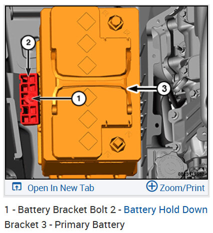

If the fuel pump is not operational, it could be due to a faulty fuel pump relay, bad pump or wiring issues.
There is not a reset button for the fuel pump.
What exact issue are you experiencing?
Is the engine just cranking over but not starting?
One way to tell if it is a fuel related issue is by spraying starting fluid into the intake and trying to start. If the engine starts for a few seconds and shuts off, that tells you the issue is due to fuel.

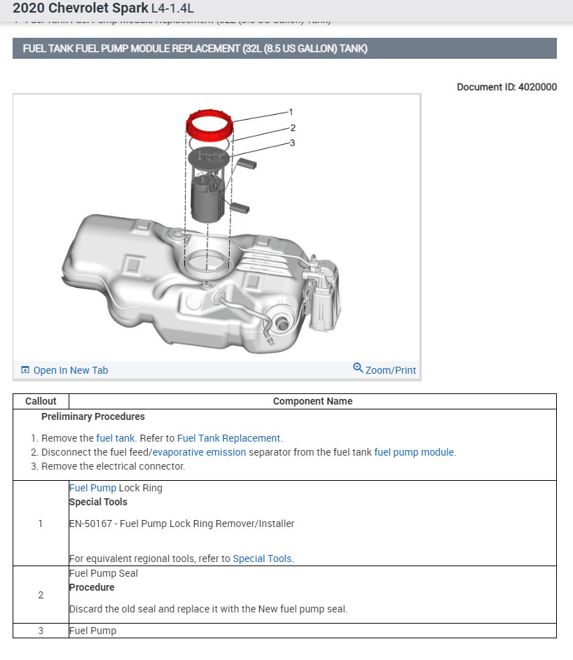

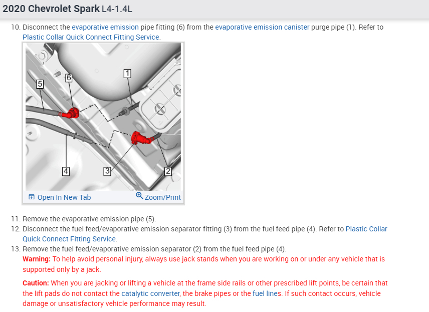

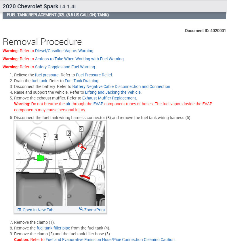

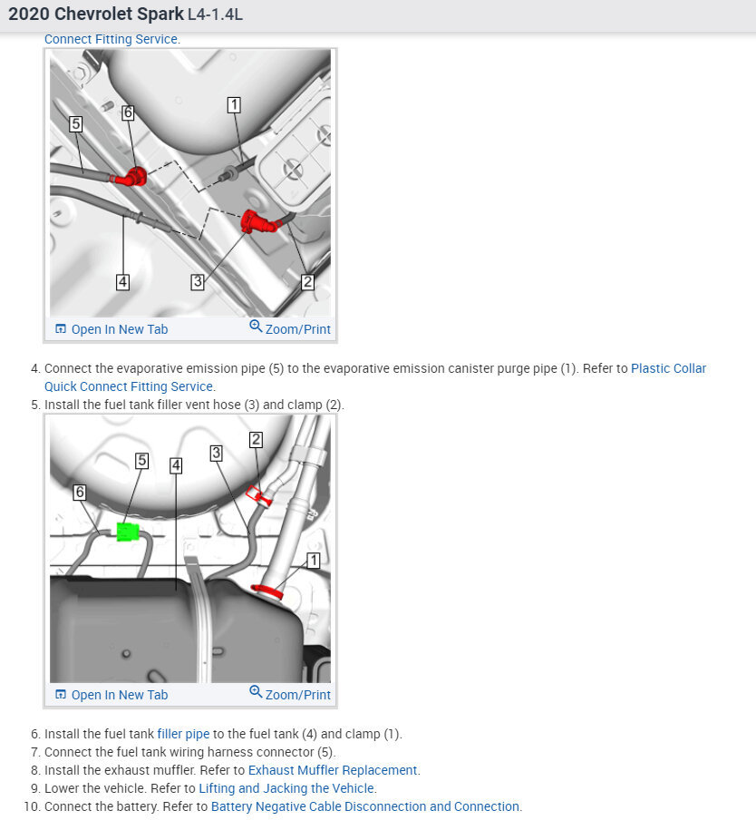

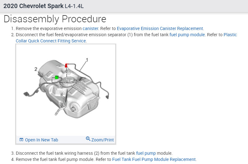

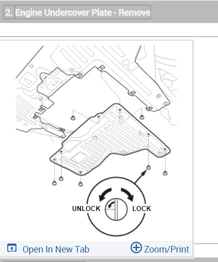

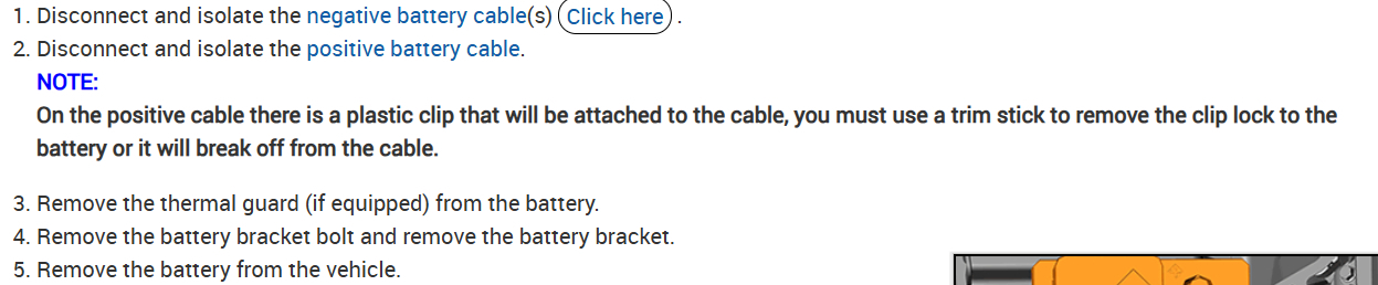

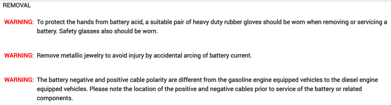

Take a look at this helpful guide:

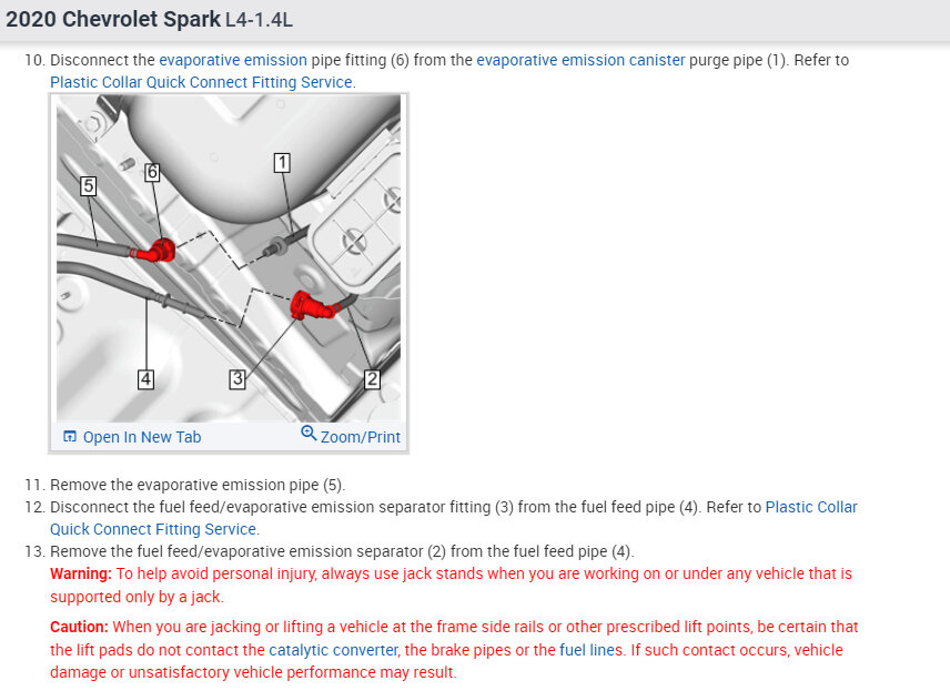

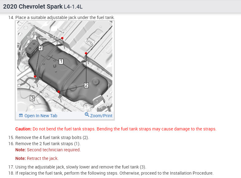

I have attached the fuel pump replacement procedure below.
Let me know if you have any questions.
