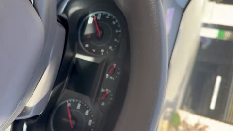

Driving in heavy rush hour traffic, sometimes not moving (idling), noticed coolant temperature approaching hot. Turned engine off, let cool down below 1/2 and reentered interstate, now at near interstate speeds. Made in home about 18 miles and temperature gauge never passed 1/2. I'm thinking stuck/unstuck thermostat or nonfunctioning radiator cooling fan. Please advise.

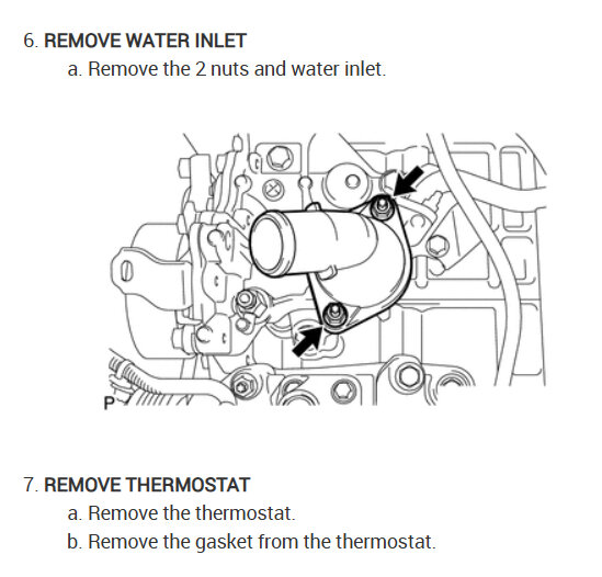

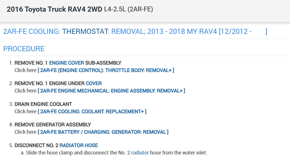

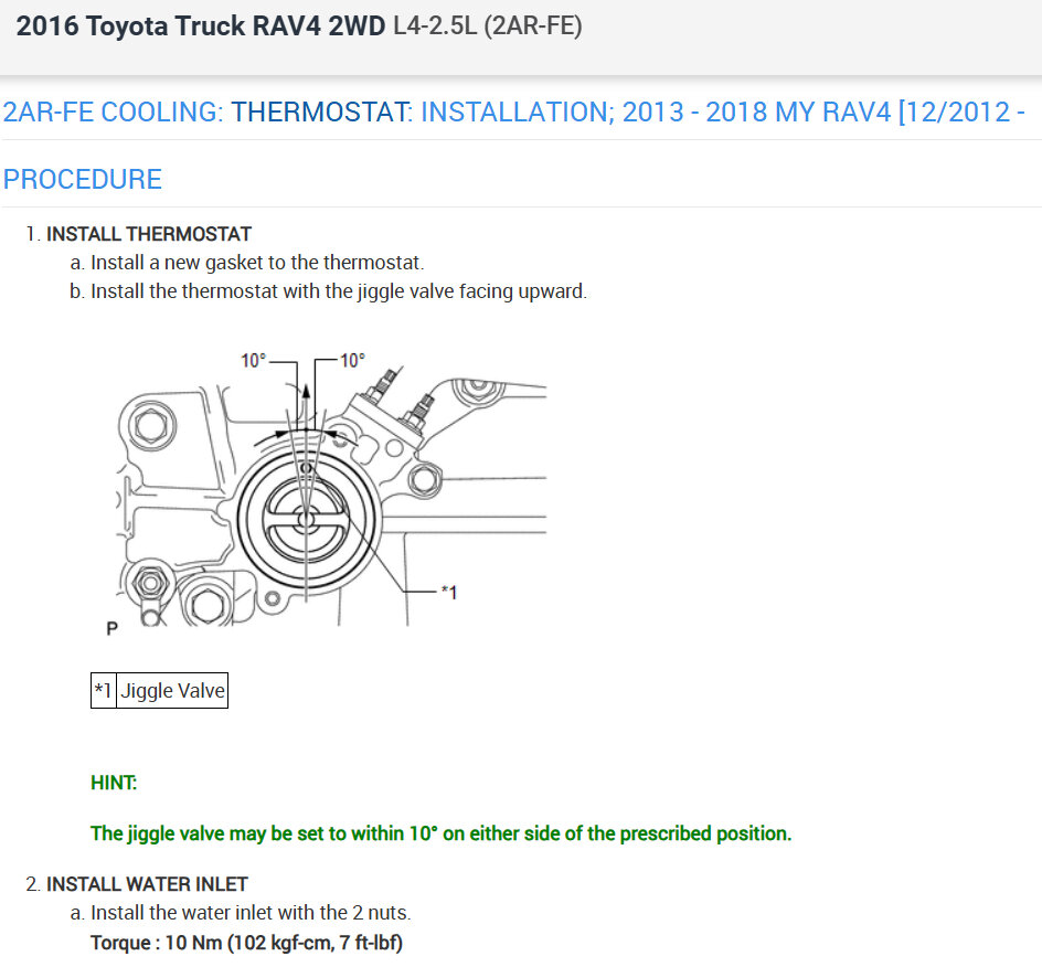

When the engine was hot did you hear the radiator fans running? How is the coolant level? We need more information on what was happening. It could be may this that can cause this including radiator fan failure, blown head gasket, coolant leak or a bad thermostat as mentioned.
Here is a comprehensive guide to help us get started on fixing the problem:
https://www.2carpros.com/articles/engine-overheating-or-running-hot

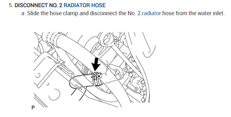

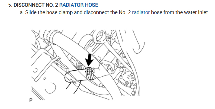

Here is how to change the thermostat which might fix it. Check out the images (below). Please upload pictures or videos in your response of any problems so we can see what to help you with.

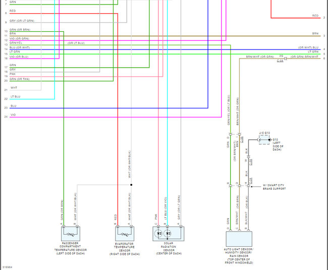

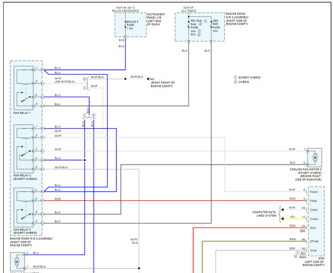

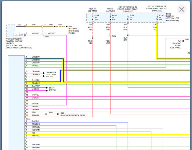

Jumped relay on fans 1 and 3 and fans are operational. Fan 2 would not jump. Swapped relay for fan 2 and no change. Not seeing a temperature control sensor in bottom of radiator to jump. There is a switch that sits on the bottom left side in front of radiator looks like an ambient air sensor. Not finding any fuses inside the passenger compartment for fans. Should I jump ECT switch connector on top of engine?
Mar 1, 2025 at 2:30 AM
  • 55,214 POSTS

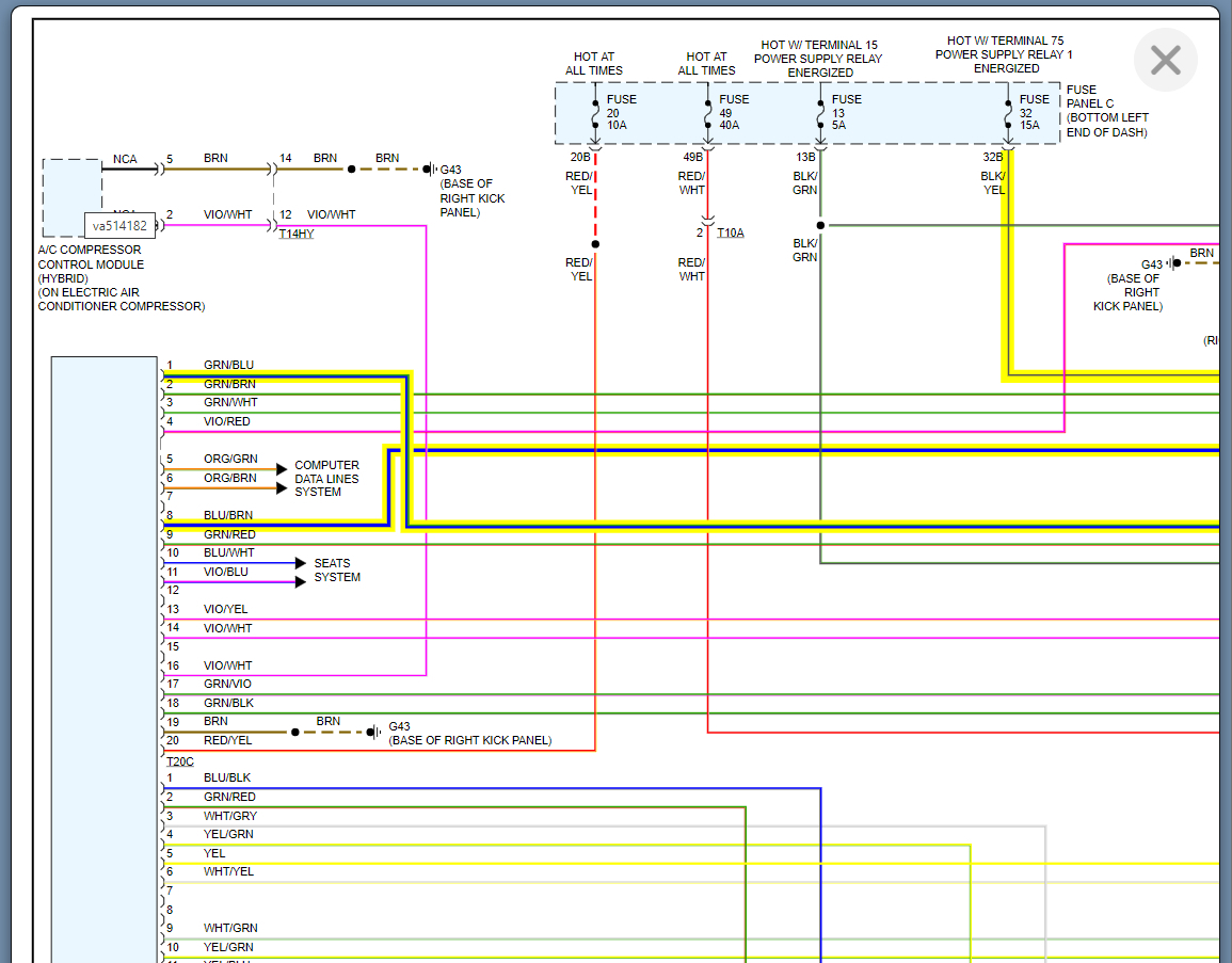

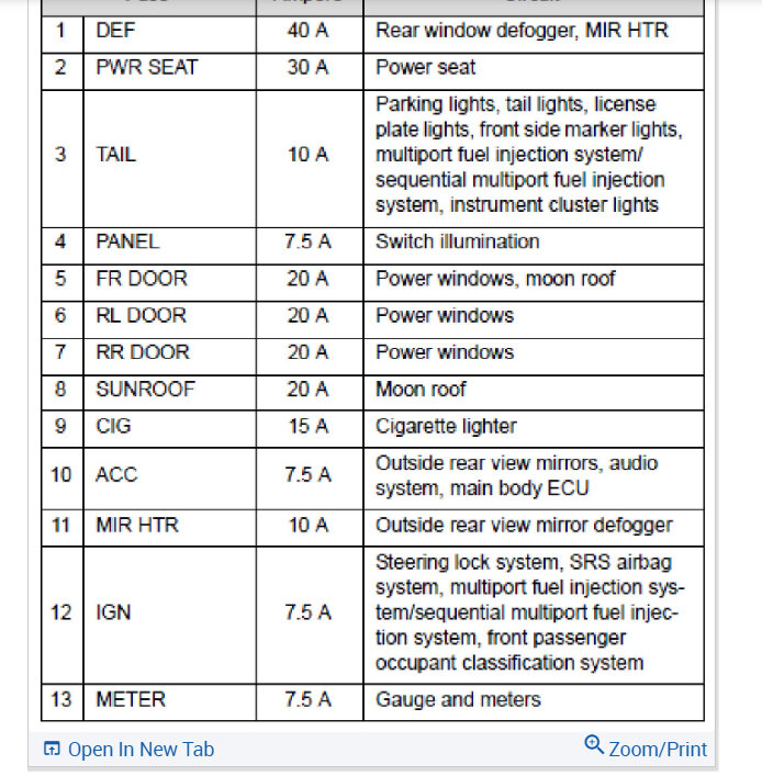

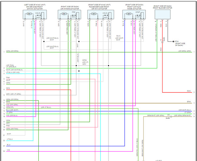

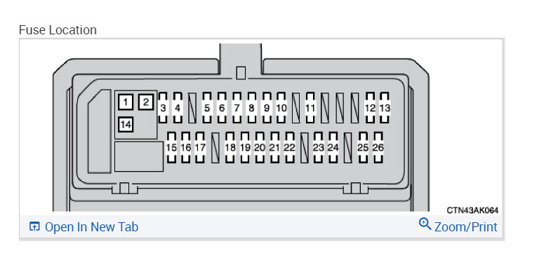

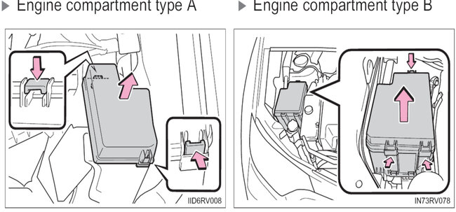

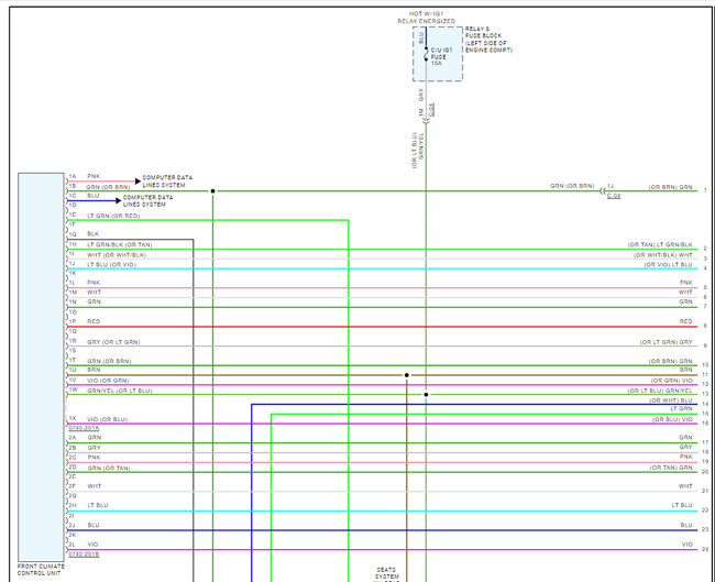

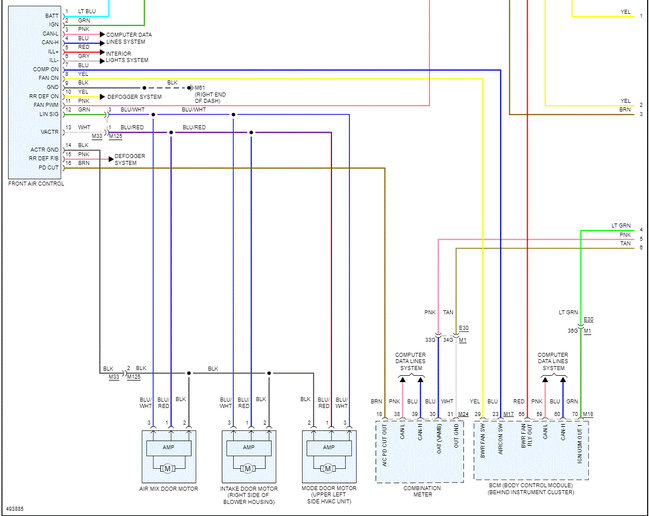

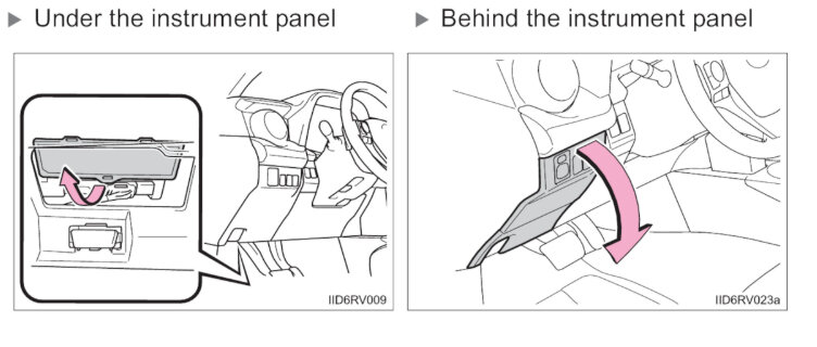

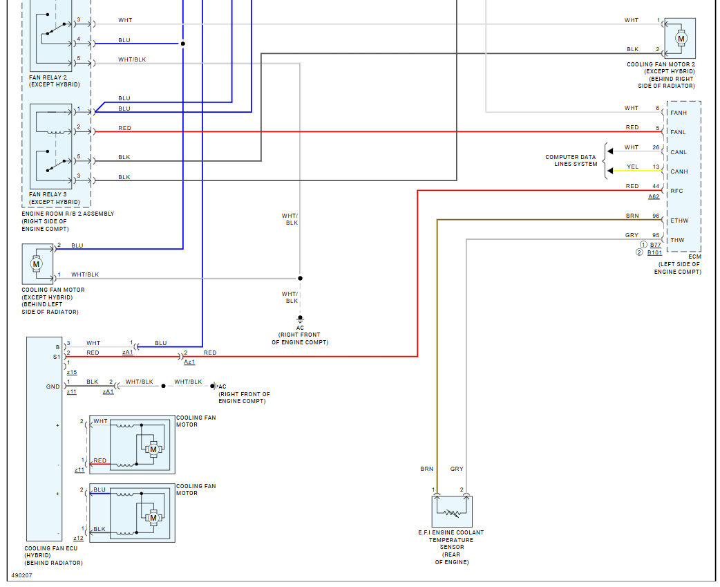

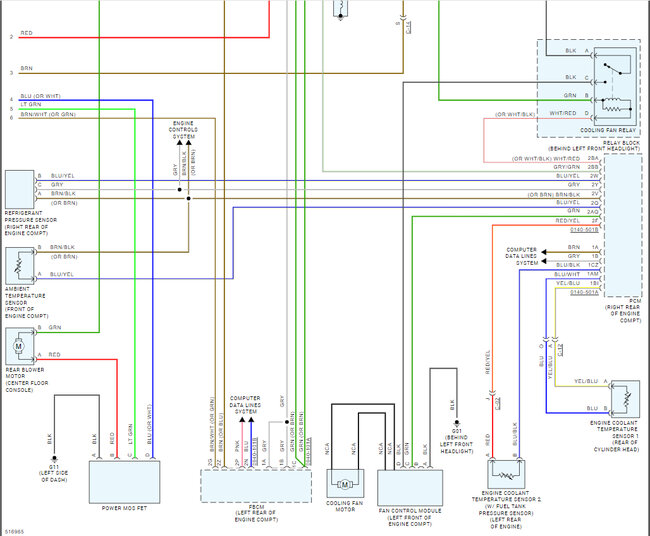

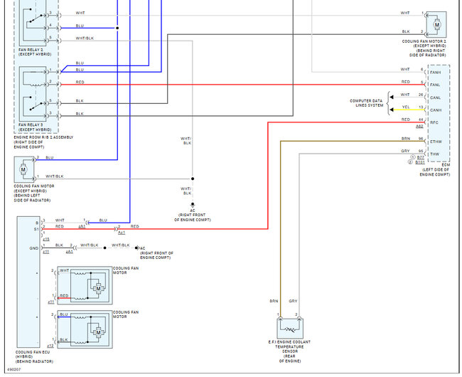

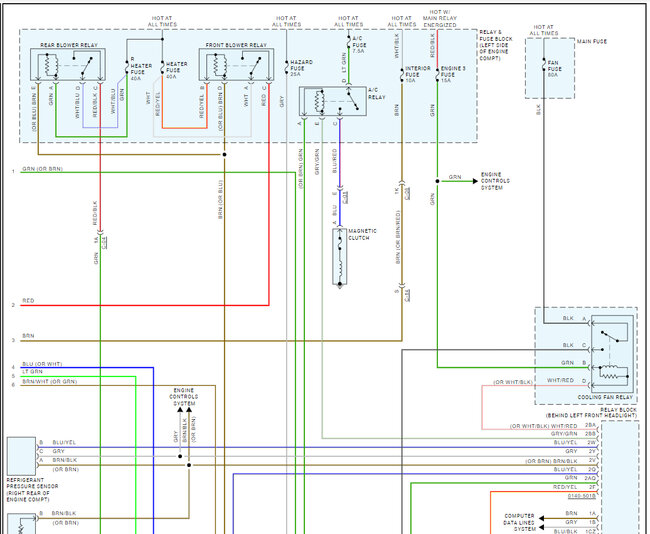

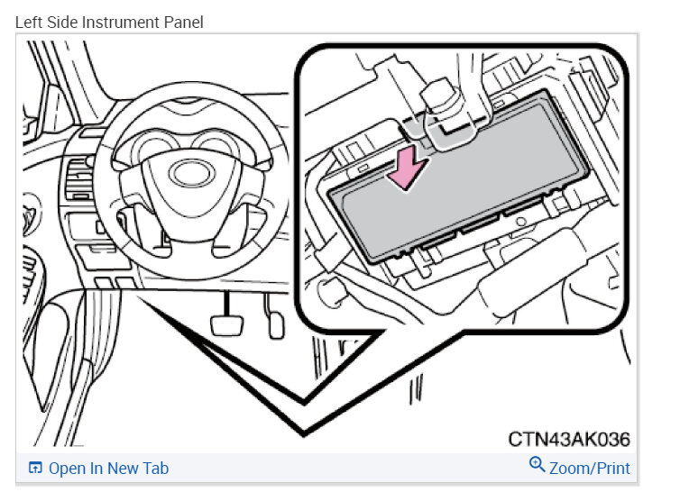

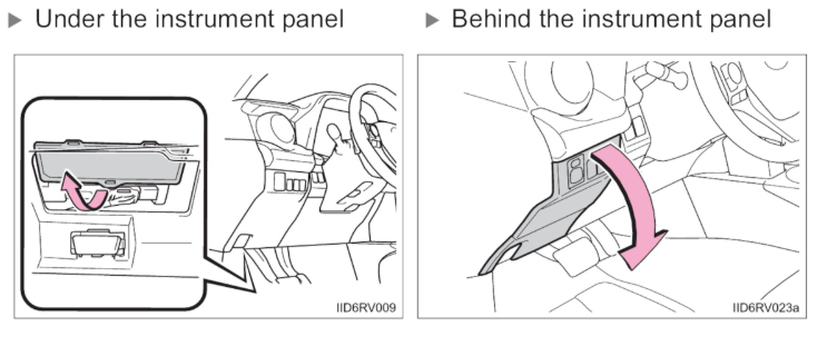

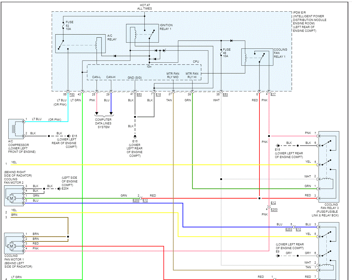

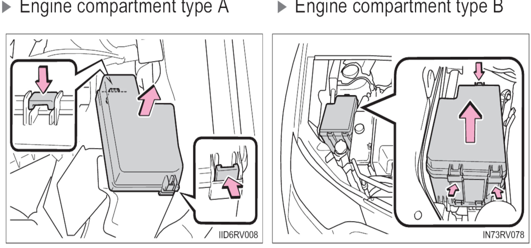

No need, if there are no codes this shouldn't matter. Is this a hybrid car? I only see two fans for the non-hybrid car, here are the wiring diagrams for the cooling fans so you can see how the system works. I would start by checking fuses ECU IG3 in the fuse panel on the left side of the dash and fuse RDI fan and CDN fan fuses in the fuse panel under the hood.
This guide can help:
Mar 1, 2025 at 3:09 AM

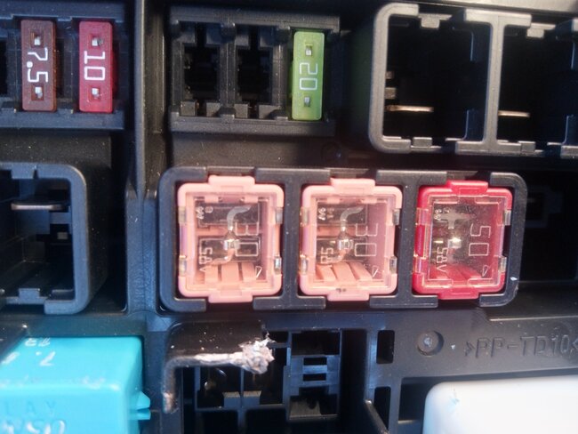

RDI and CDN fuses look good (photo). Non-hybrid engine with two (2) fans. Fan 3 relay is both fans on low speed. Fan 2 (A/C fan) is not operational when jumping relay but is operational when fan 3 relay is jumped.

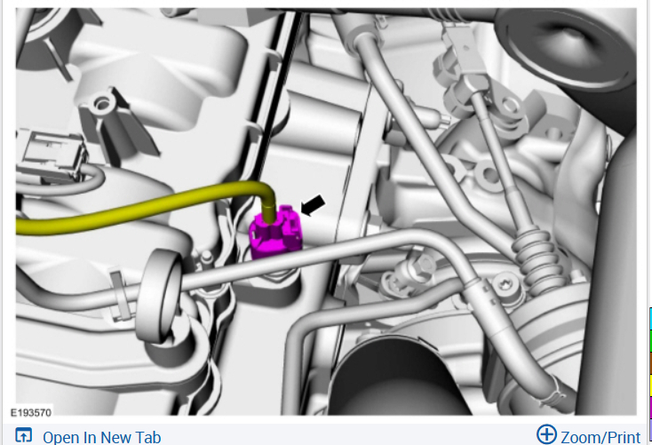

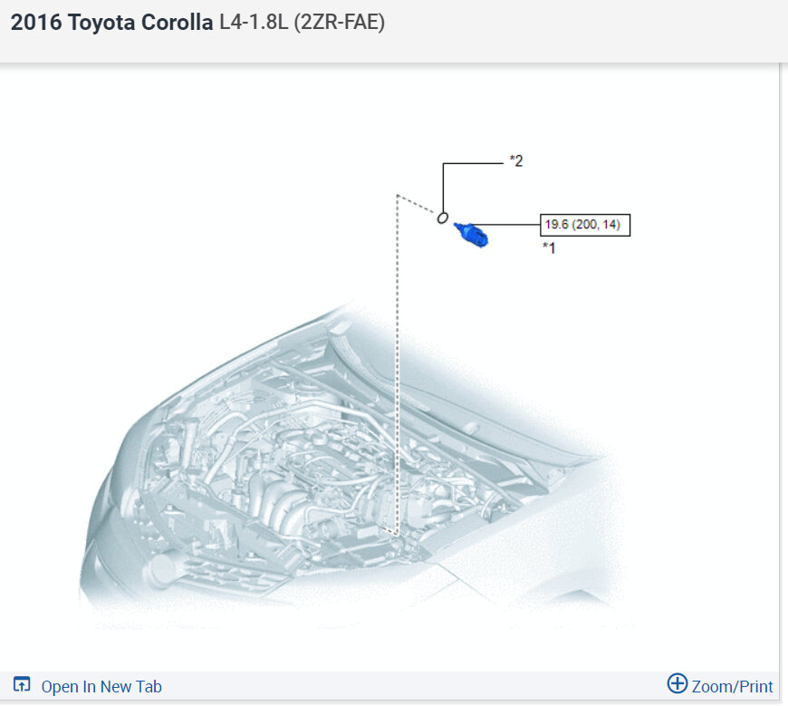

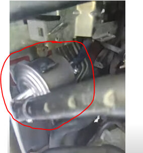

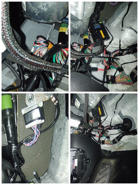

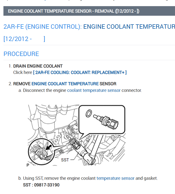

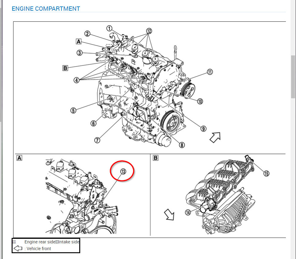

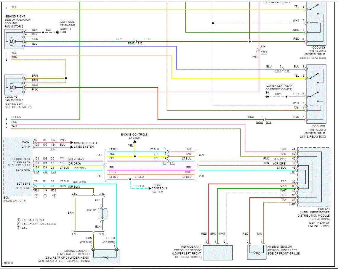

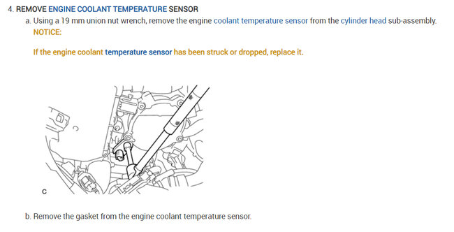

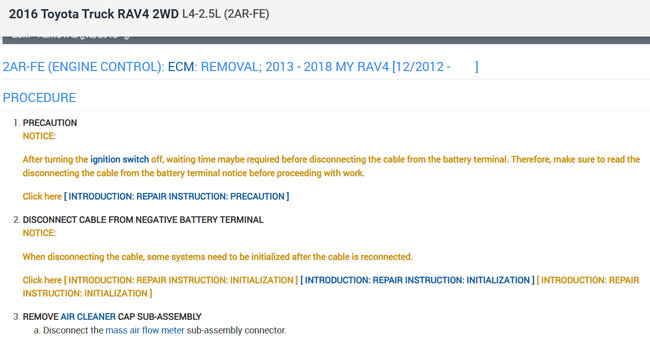

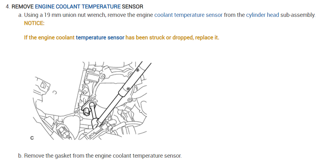

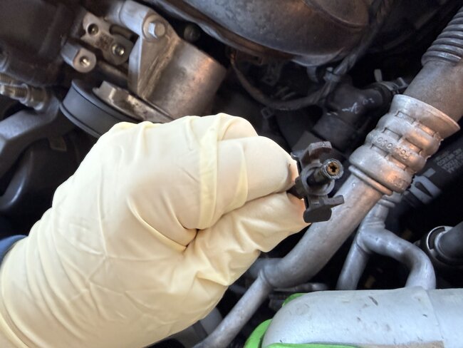

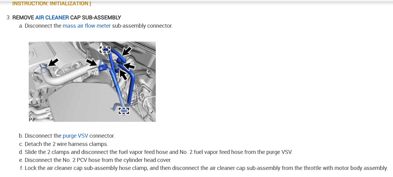

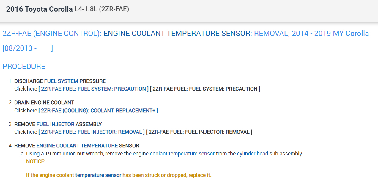

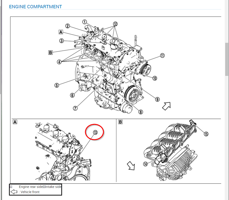

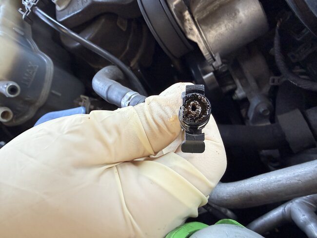

The ECM controls the fan operations, let's plug a scanner in to see what the engine temperature says. You could have a bad engine coolant sensor. Also, let's check the ground for the system which is located at the right front of the engine compartment, (blk/wht wire).
Here is the location of the coolant sensor in case the reading is way off. Check out the images (below). Let us know how it goes.
Mar 2, 2025 at 3:45 AM

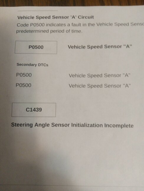

AutoZone code reader shows P0500 and C1439. Also, will an A/C compressor kick in with proper refrigerant level, but not blowing cool air due to fan not operating? I previously stated this was occurring with this issue.
Mar 7, 2025 at 8:54 PM
  • 55,214 POSTS

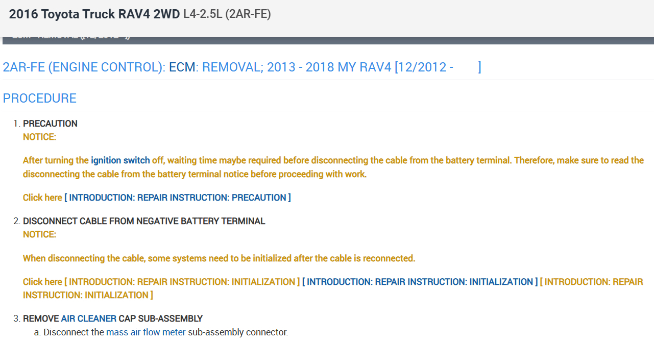

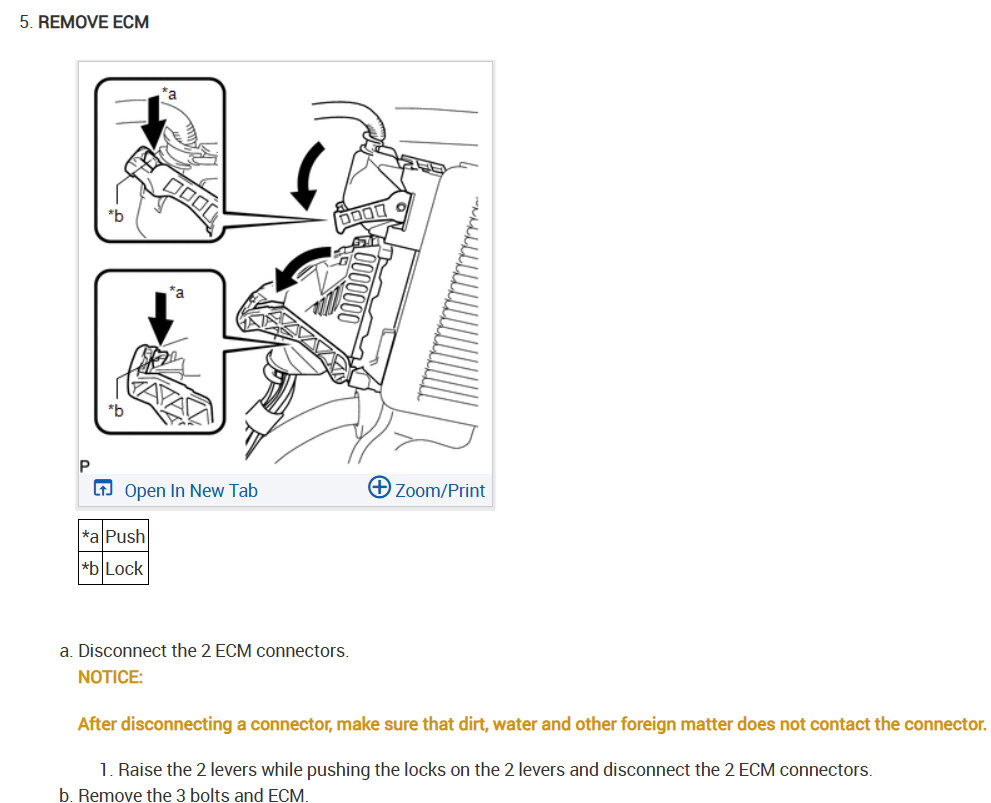

These codes have nothing to do with the fans not running, and yes if the fan do not run the AC will not work. It could be the ECU not commanding the fans to come on. The white wire to the ECU grounds and turns fan 1 and 2 on, and the red wire turns fan three on, I would remove the connector form the ECU to ground them manually to see if the fans come on, this will tell us for sure what the problem is. Please use the wiring diagrams above to help. Here is the location of the ECU. Check out the images (below).
Mar 8, 2025 at 2:19 AM

  • 55,214 POSTS
Yep, they don't show images just the location descriptions. All we can do is check the power and grounds and if okay, it looks like the PCM might be bad, you can send it in for testing.

I'm getting (5.0vdc) at the temperature coolant sensor. Is there a way to test sensor itself, or is it a sure bet that the sensor is bad and causing fans to not run and a/c to not work, since there is voltage at that connector?
Mar 30, 2025 at 6:47 AM
CA7922303
  • 165 POSTS
Replaced temperature sensor and fans and A/C are operational. Thanks for your help. Appreciate it.
