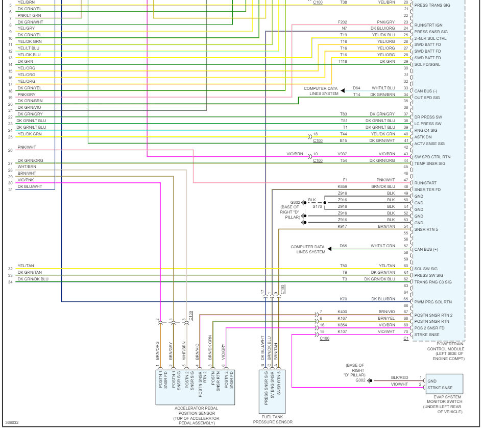

The car listed above is an SE model. Rpm's does not rev up. Have replaced throttle body and gas pedal as well as mass air flow sensor. I have done all the relearns, and still no change. Also, don't have a check engine light on.

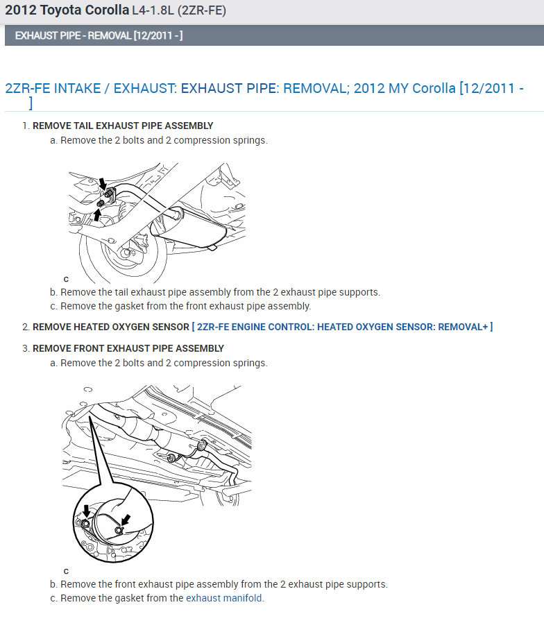

Even though you have no check engine light on there still can be a code, also does the exhaust sound okay. I have seen catalytic converters come apart internally and intermittently block the exhaust outlet causing the problem you are describing.

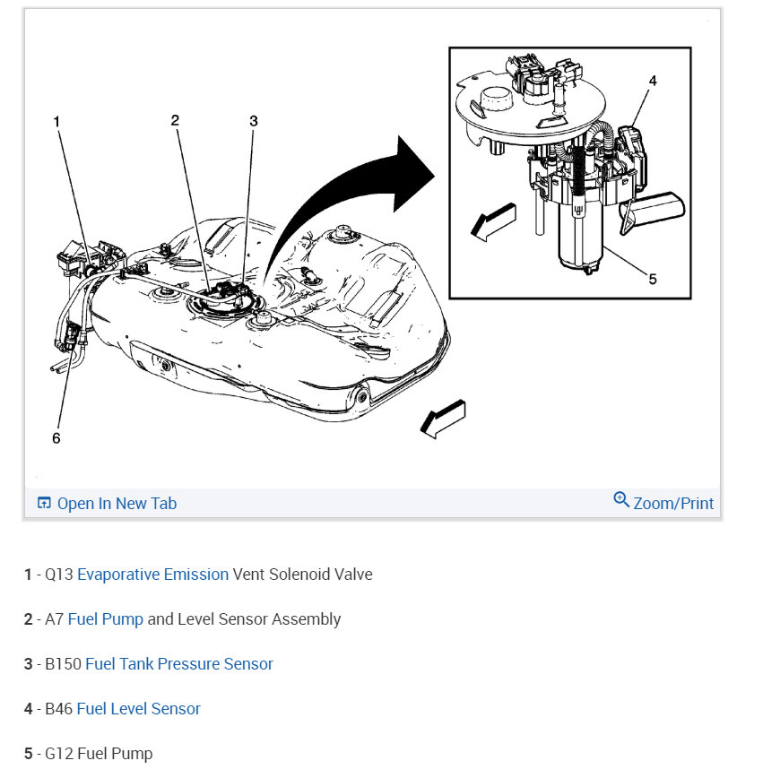

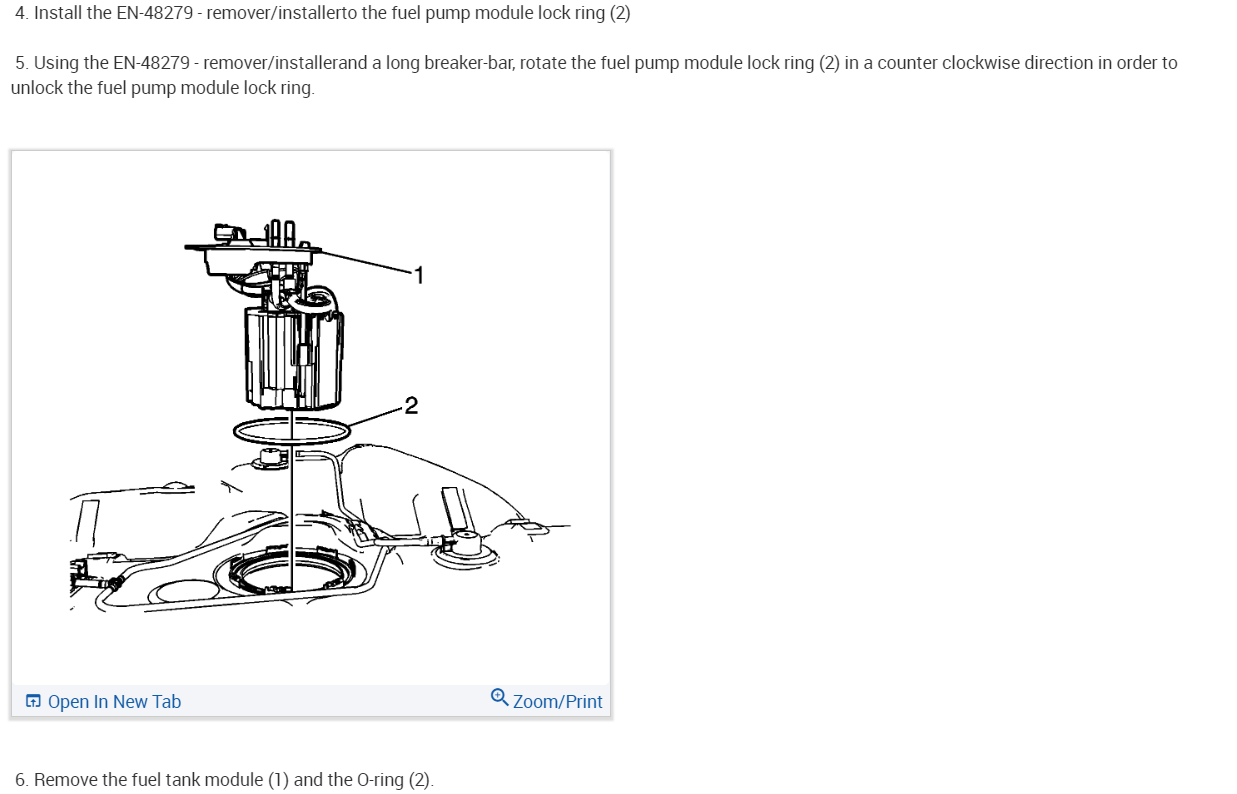

You could have a fuel pump that is going out as well, if the exhaust is okay with no codes let's do a fuel pump pressure test.
Standard fuel pressure 304 to 343 kPa (3.1 to 3.5 kgf/cm2, 44 to 50 psi)
This guide can help and you can rent a fuel pressure test gauge at the auto parts store free cheap or free in most cases:
Please go over these guides and report back.

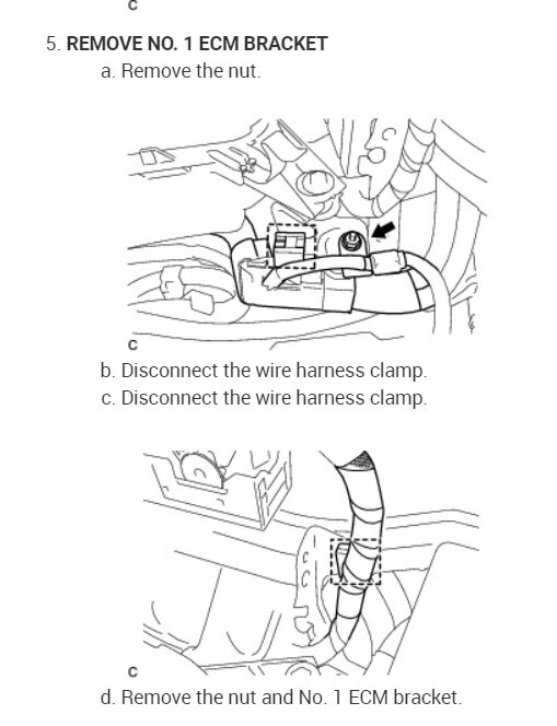

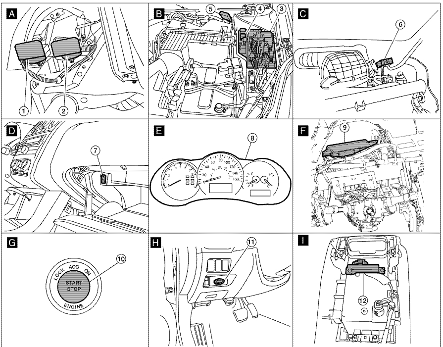

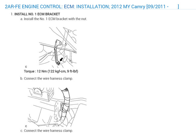

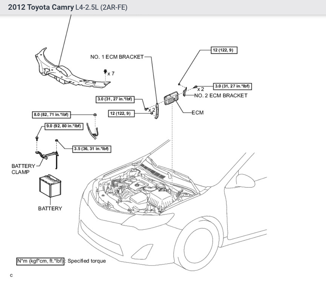

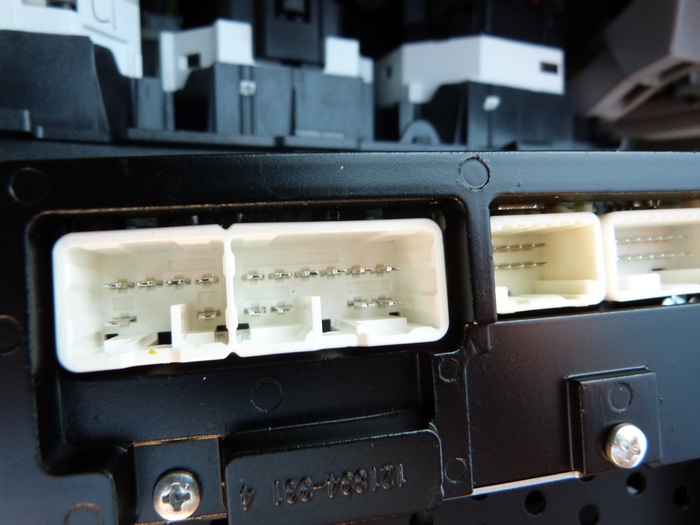

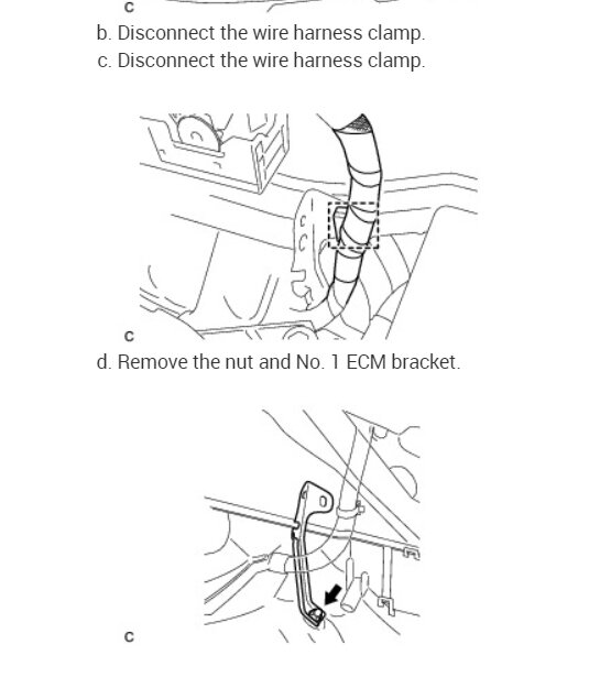

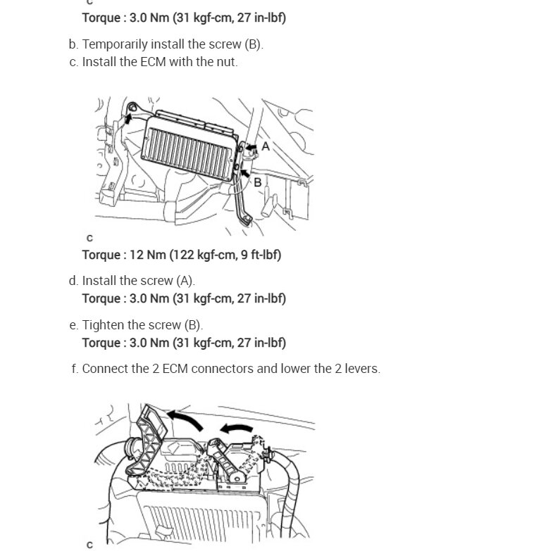

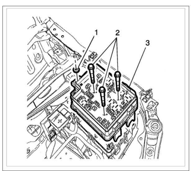

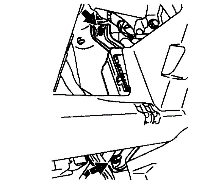

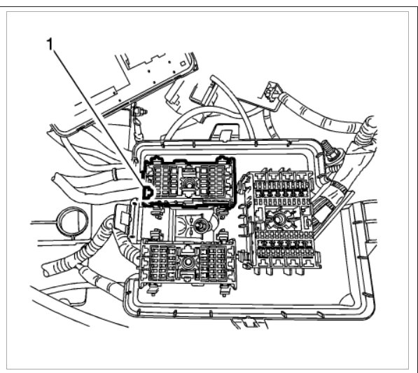

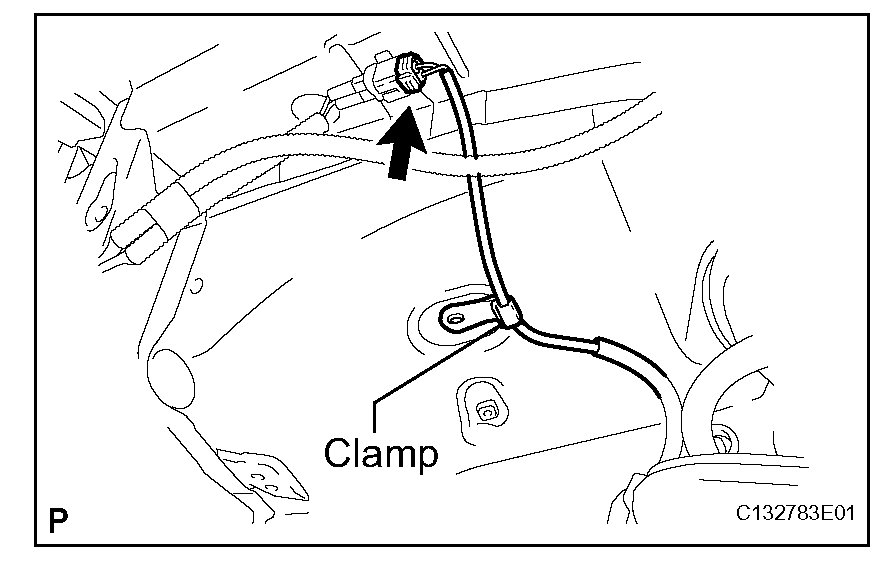

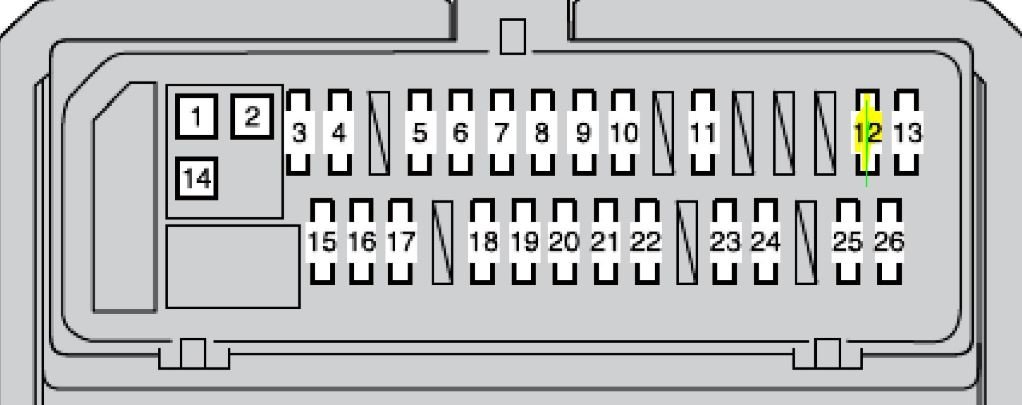

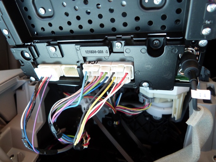

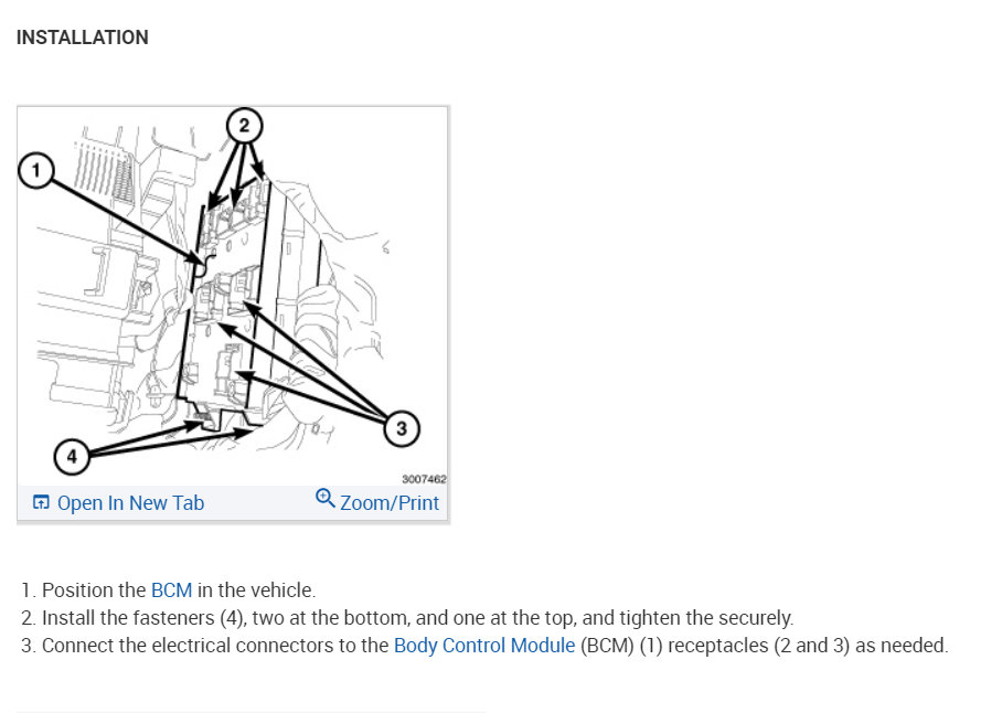

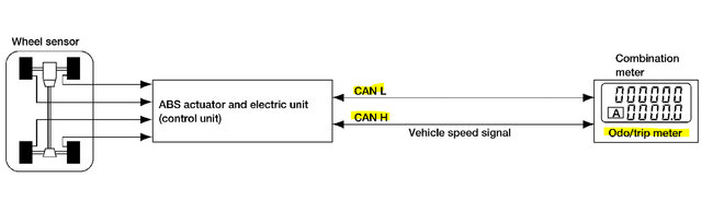

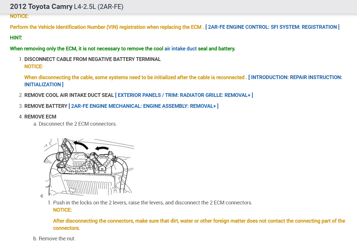

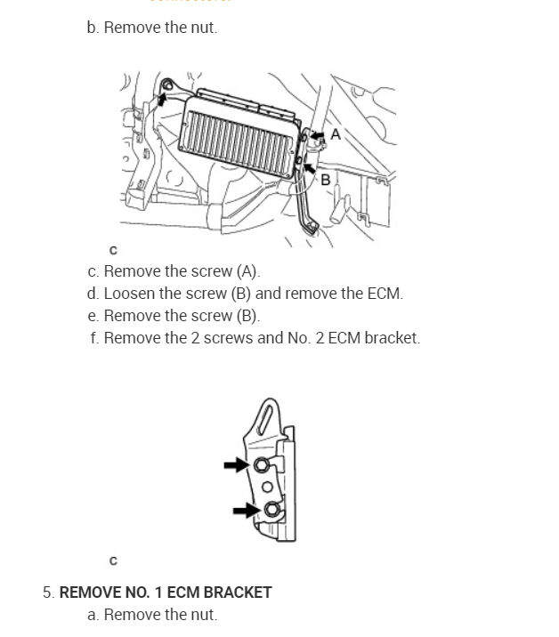

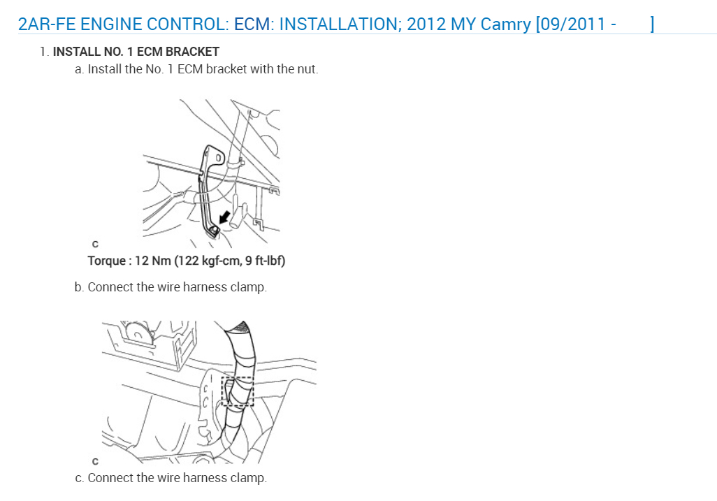

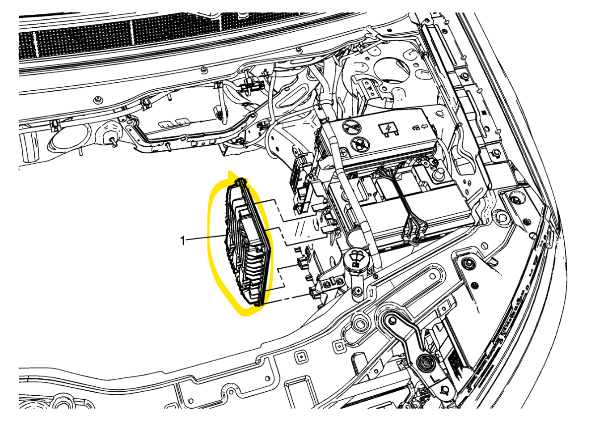

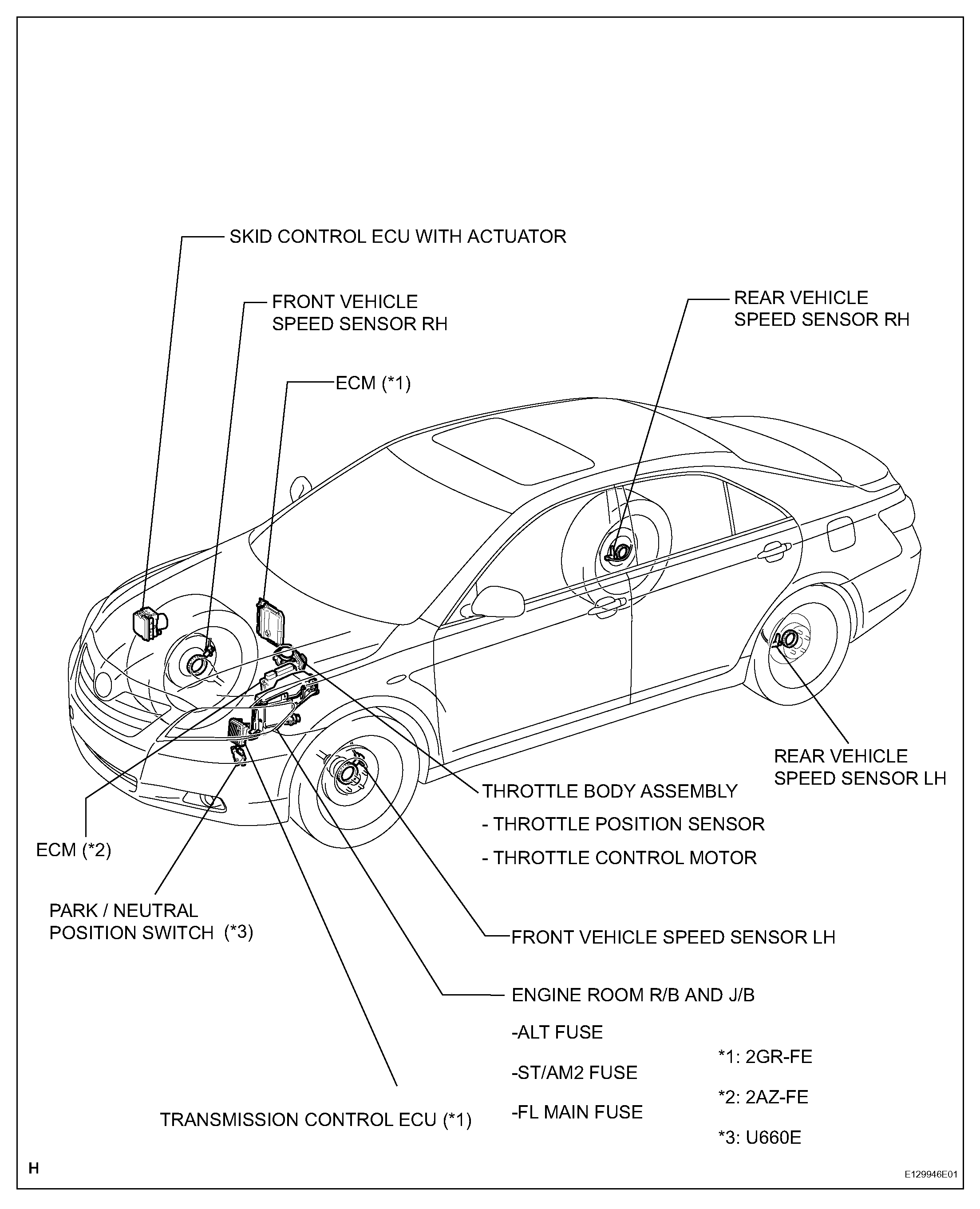

It sounds like it could be, but to be sure we should run a CAN scan, you can get a CAN scanner (Controller Area Network) from Amazon from about $32.00.
https://youtu.be/u-4syLc-ifQ
and

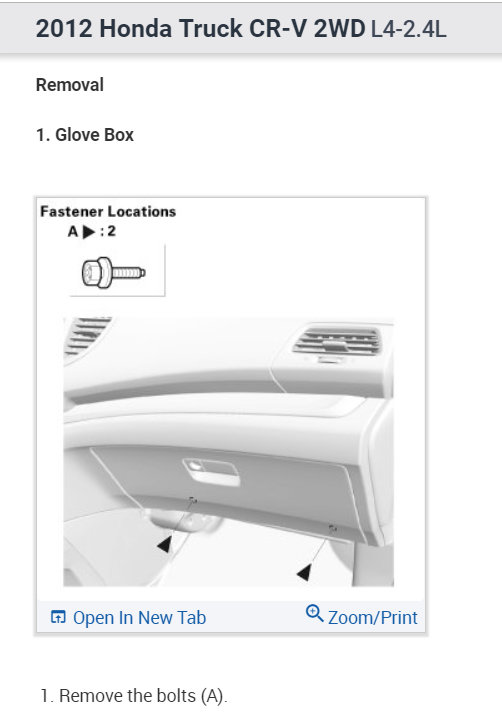

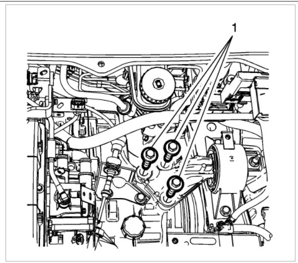

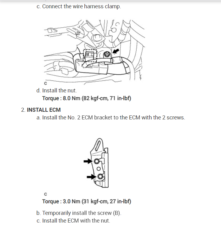

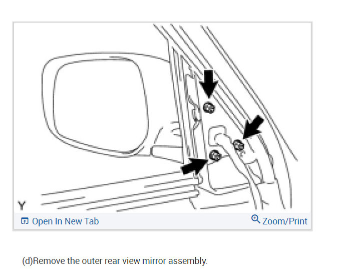

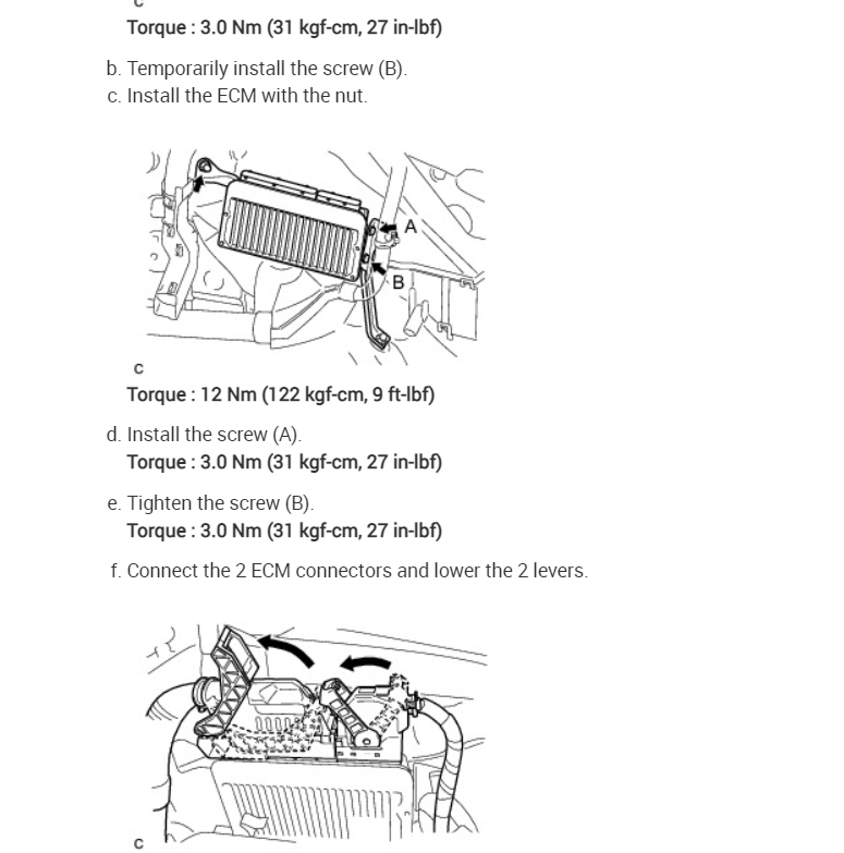

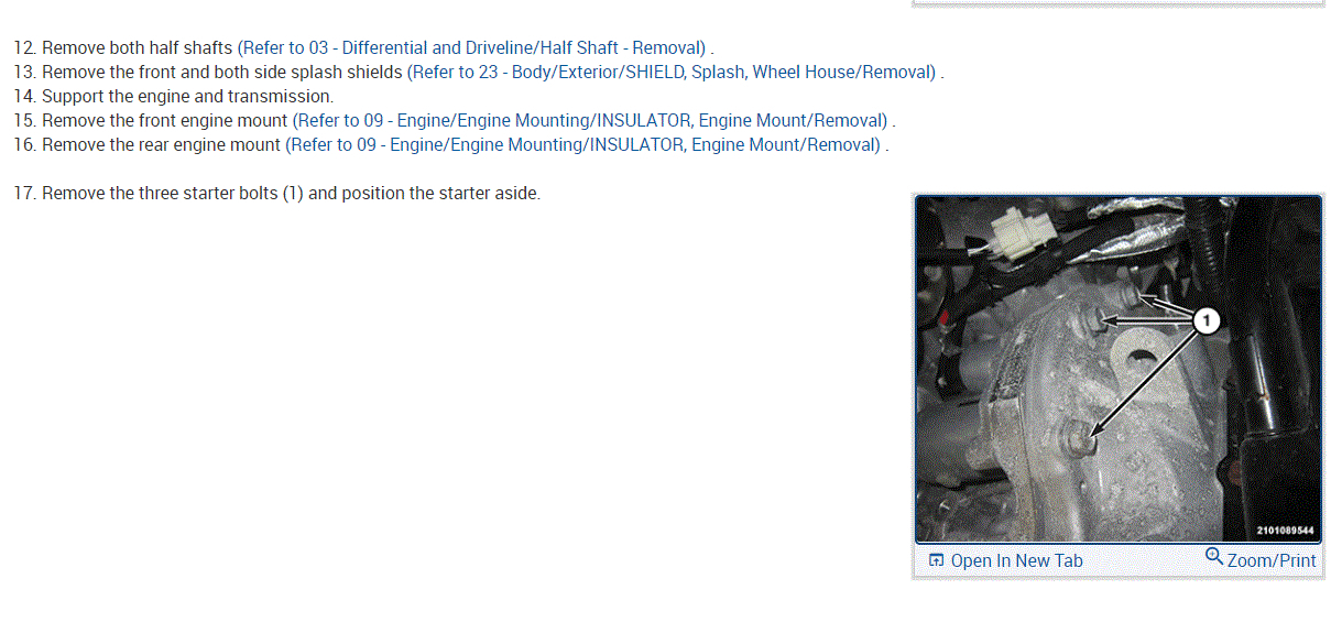

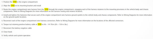

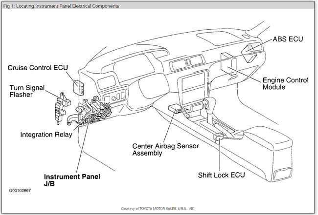

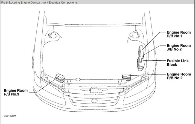

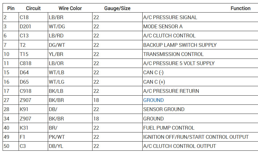

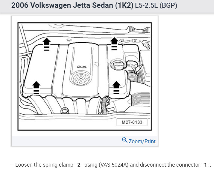

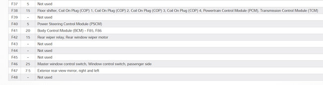

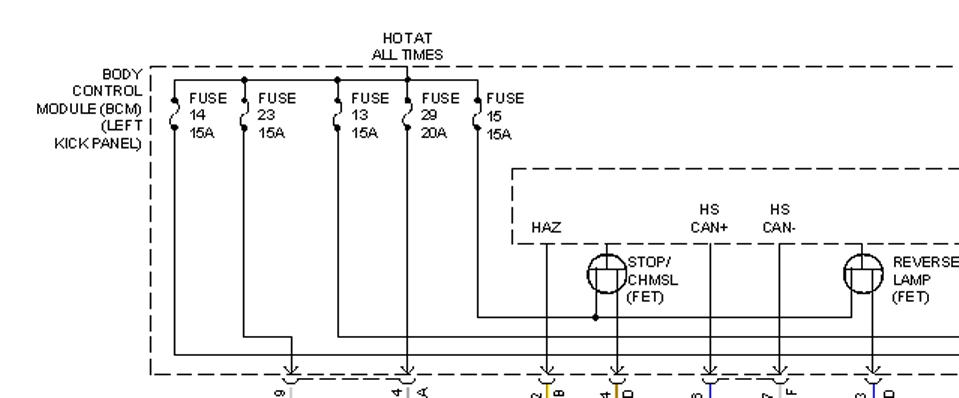

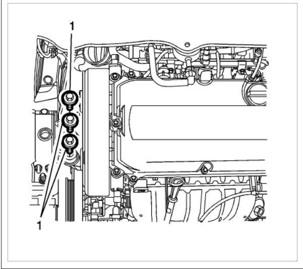

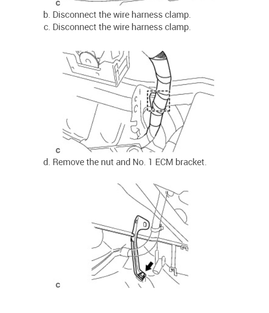

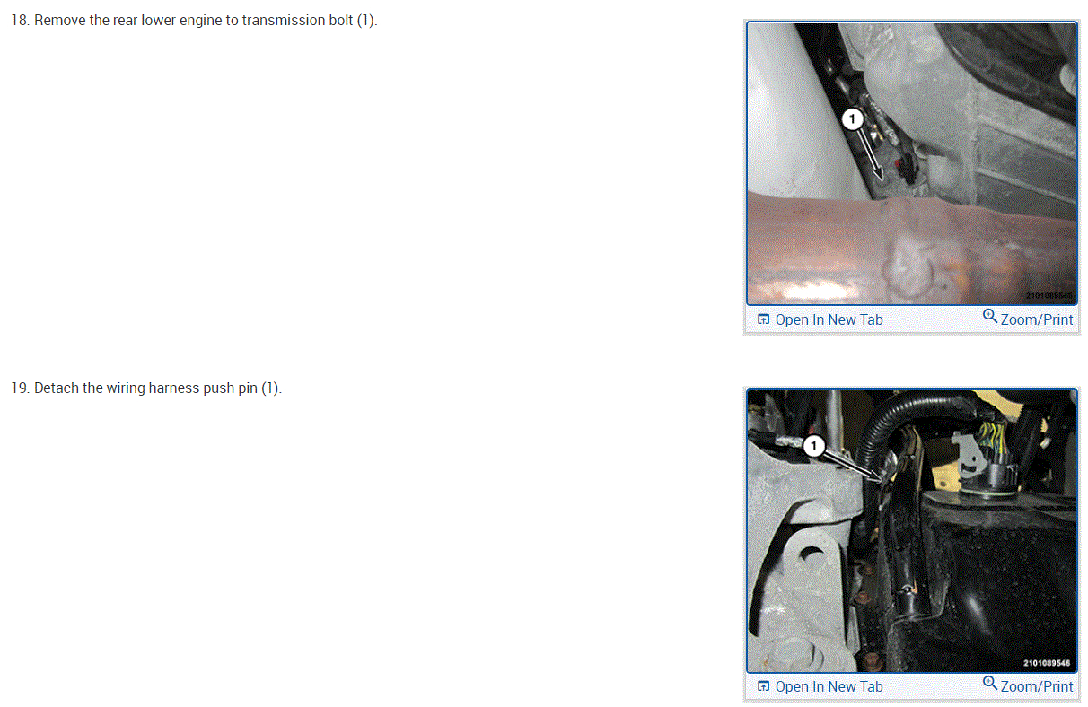

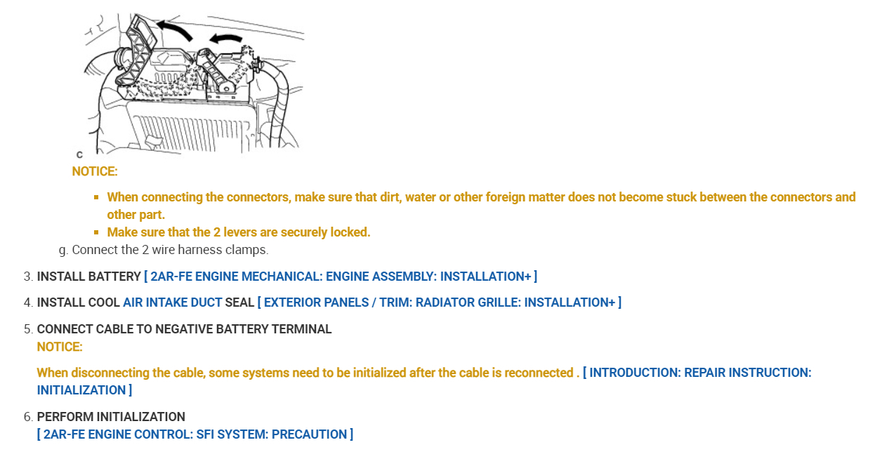

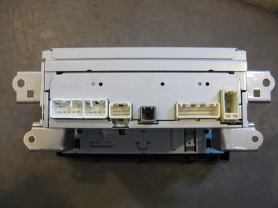

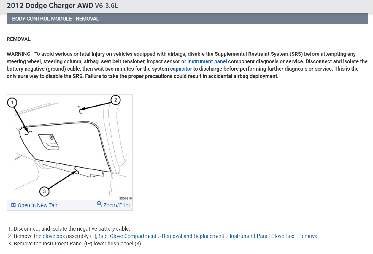

Here is the PCM location and how to replace it. Check out the images (below). Please let us know what happens. You can get a rebuilt PCM by searching google or eBay. That way it will be preprogrammed.
Dec 30, 2022 at 5:57 AM
