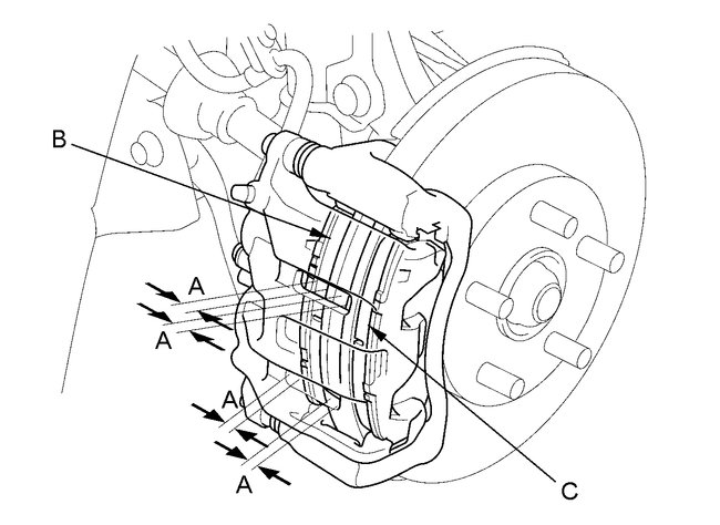

Inspection
1. Raise and support the vehicle See: Vehicle Lifting > Procedures.
2. Remove the front wheels.
3. Check the thickness (A) of the inner pad (B) and outer pad (C). Do not include the thickness of the backing plate.
pic 1
4. If any part of the brake pad thickness is less than the service limit, replace all of the front brake pads as a set.

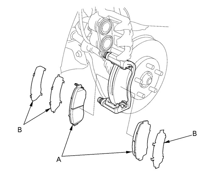

5. Remove the brake pads (A) and the pad shims (B).
pic 3

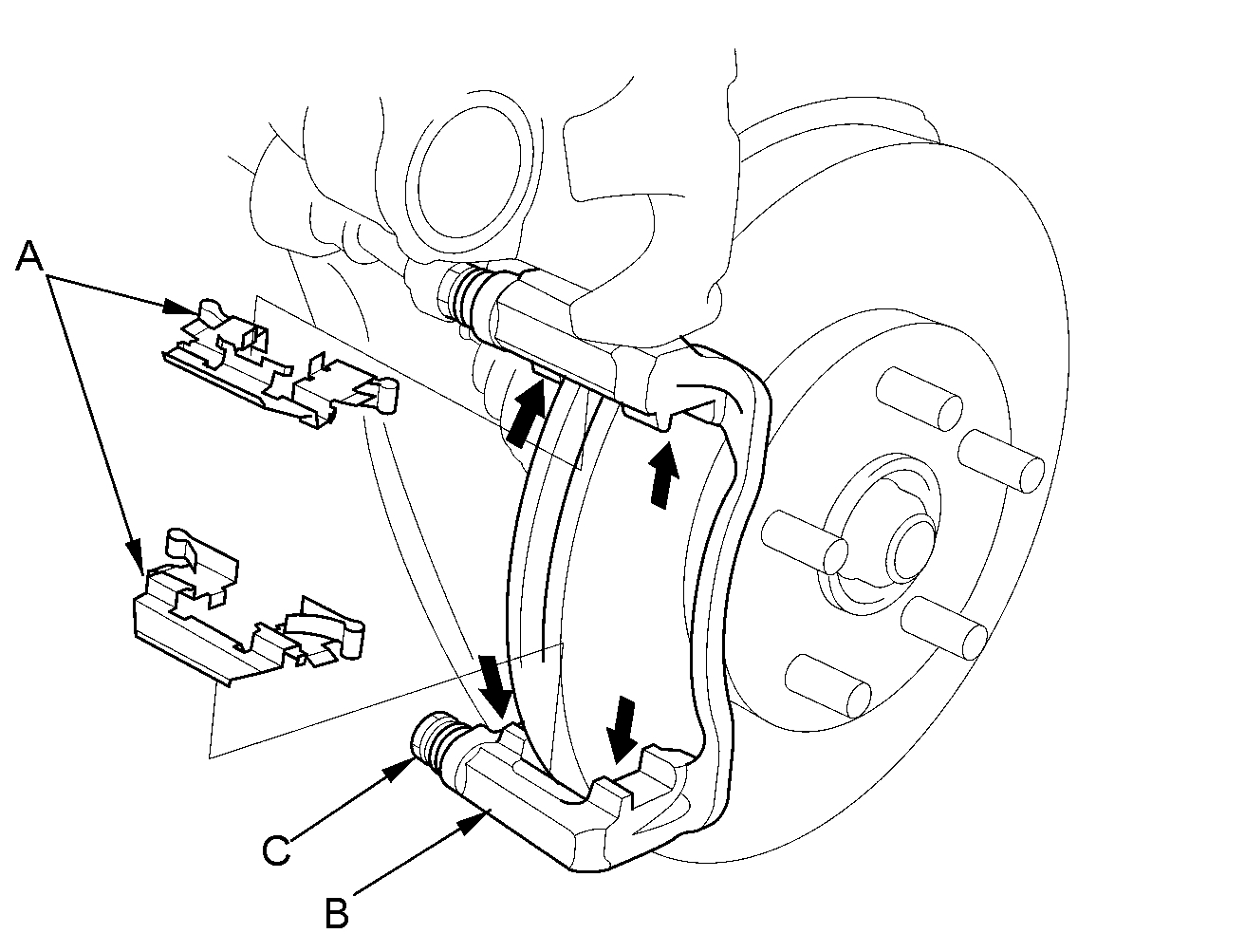

6. Remove the pad retainers (A).
pic 4
7. Clean the caliper bracket (B) thoroughly; remove any rust, and check for grooves and cracks. Verify that the caliper pins (C) move in and out smoothly. Clean and lube if needed.
8. Inspect the brake disc for runout, thickness, parallelism See: Brake Rotor/Disc > Component Tests and General Diagnostics > Front Brake Disc Inspection, and check for damage and cracks.
9. Apply a thin coat of M-77 assembly paste (P/N 08798-9010) to the retainer mating surface of the caliper bracket (indicated by the arrows).
10. Install the pad retainers. Wipe excess assembly paste off the retainers. Keep any assembly paste off the brake discs and brake pads.
