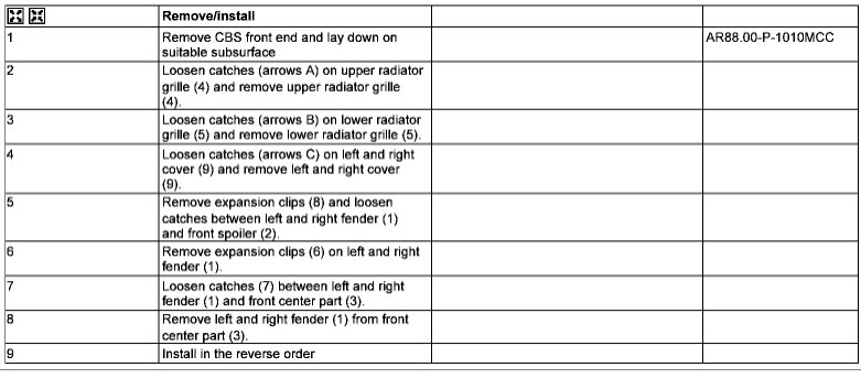

I know this is an old thread but I thought I would help anyway. Here is what the book says about reinstalling the front clip:

1 Fenders
2 Front spoiler
3 Front center part
4 Upper radiator grille
5 Lower radiator grille
6 Expansion clip
7 Catches
8 Expansion clip
9 Covering
