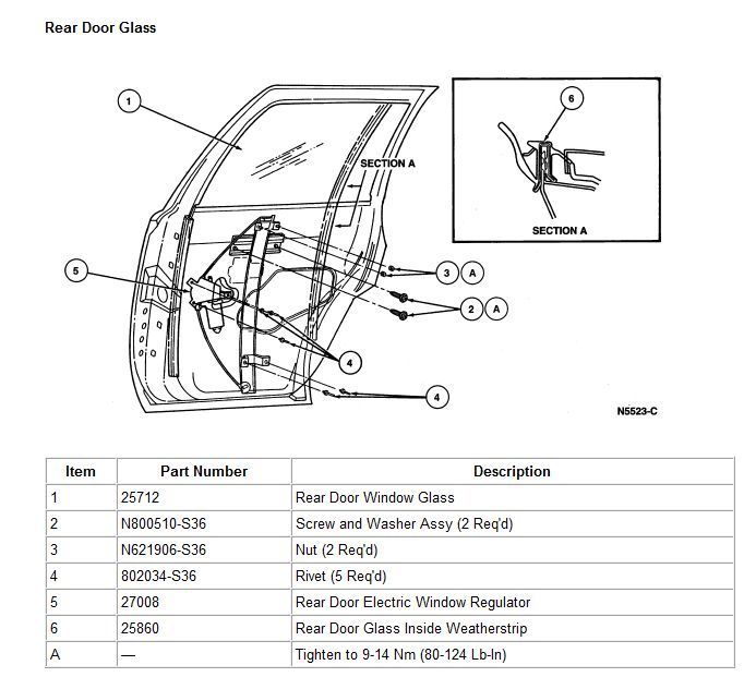

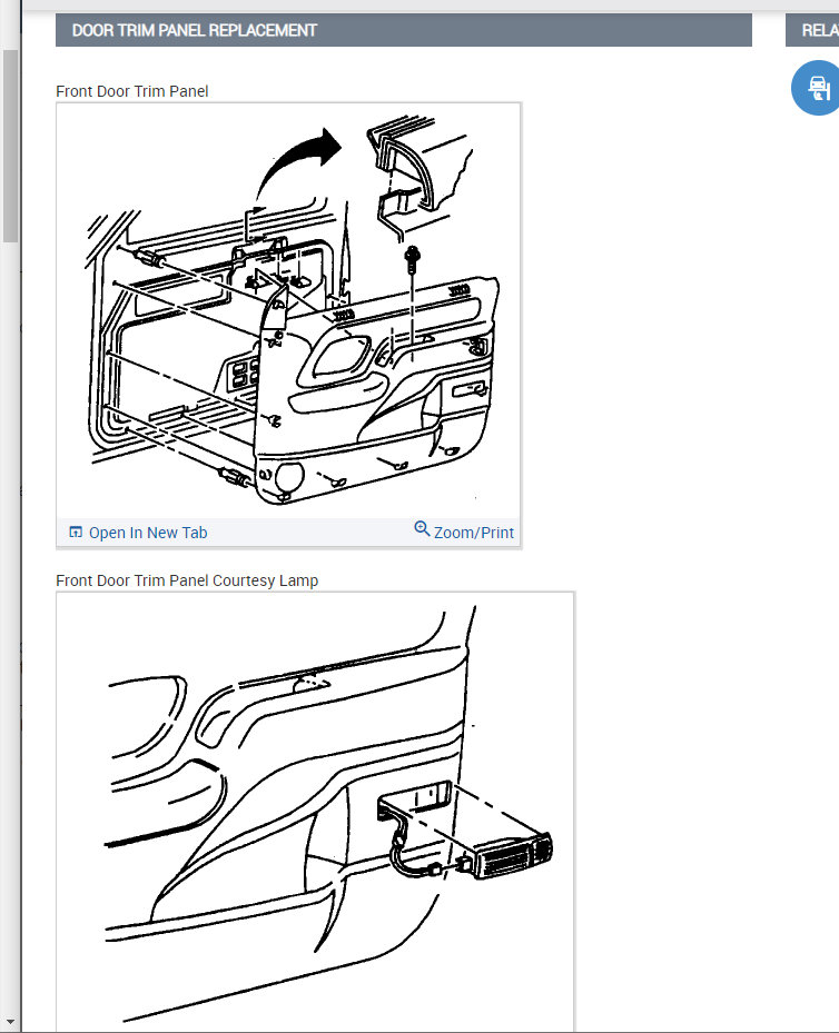

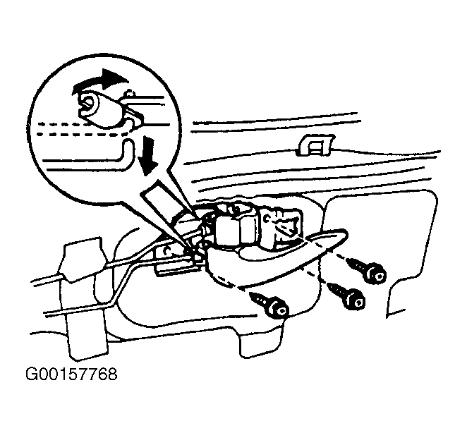

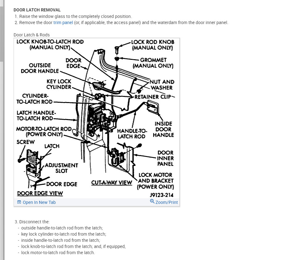

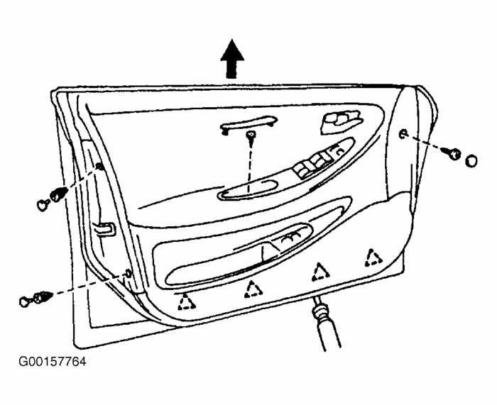

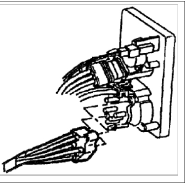

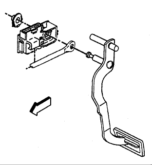

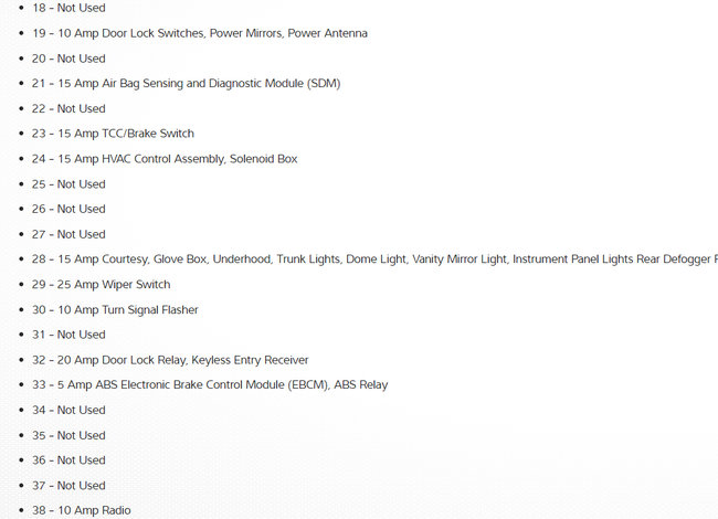

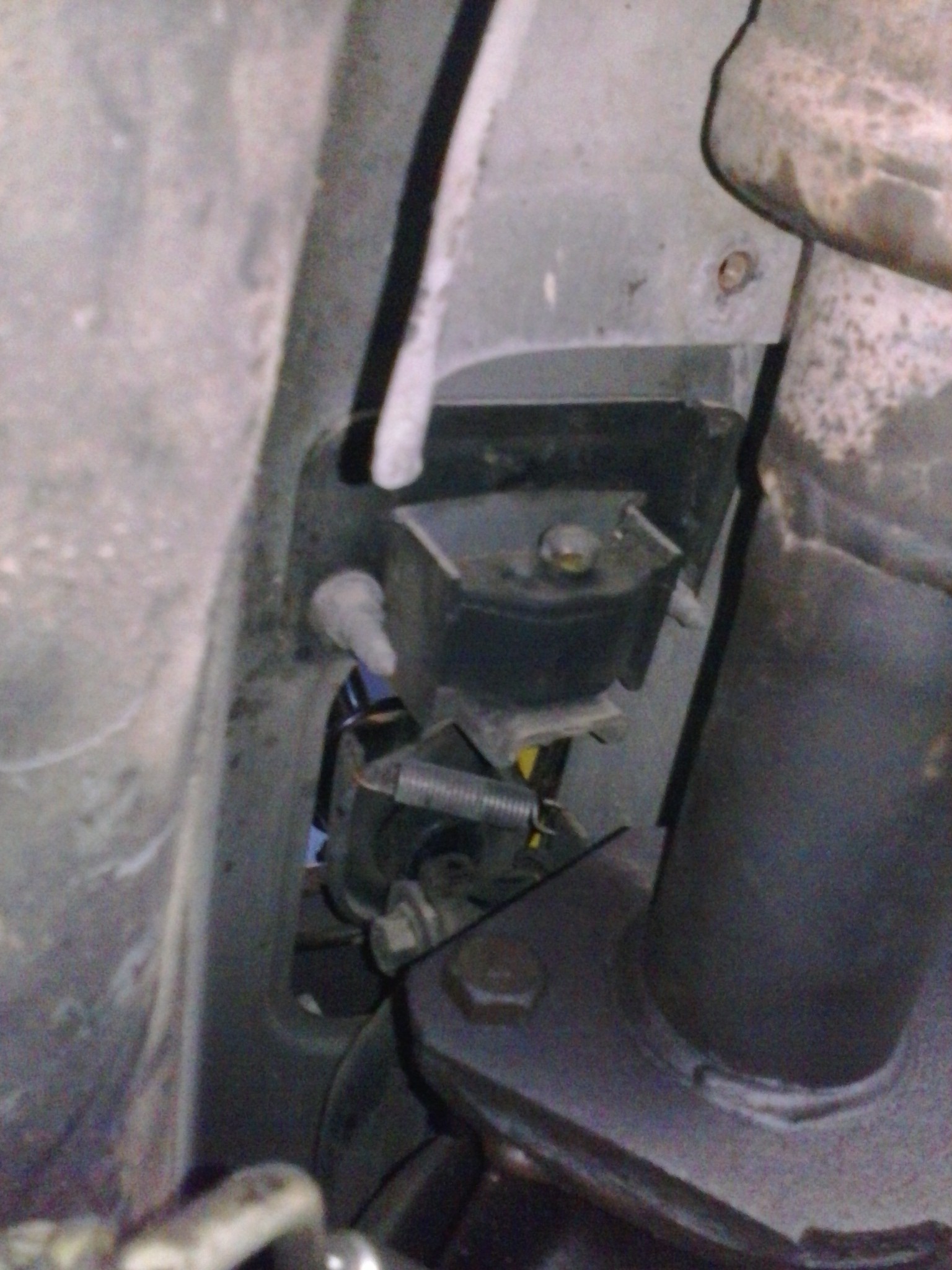

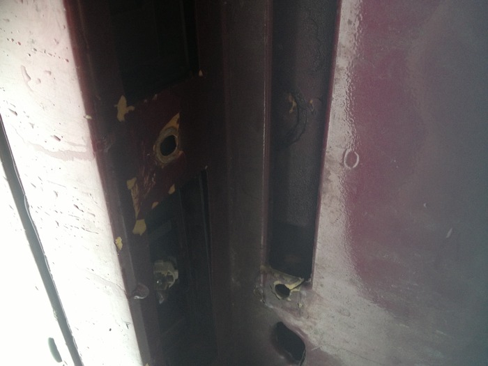

My truck door won't latch when I shut it latches but doesn't latch to the stricken
Jul 18, 2014 at 3:24 PM
Experienced Mechanic
18,907 POSTS

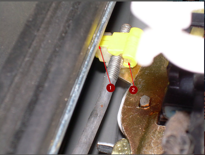

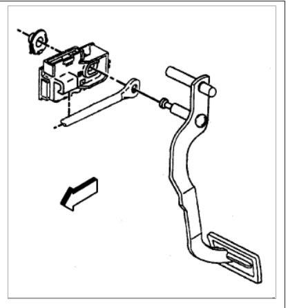

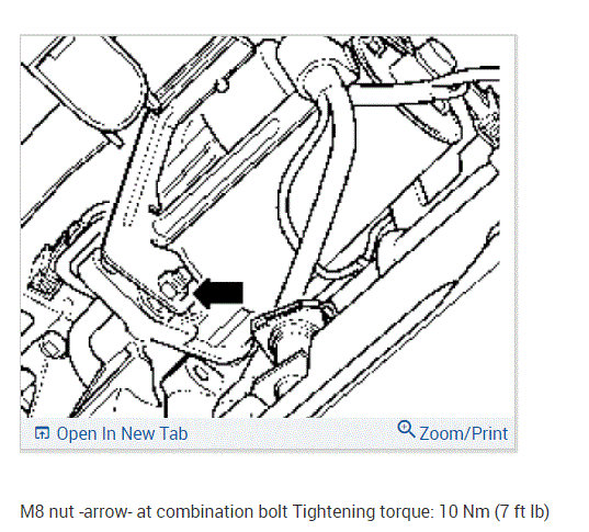

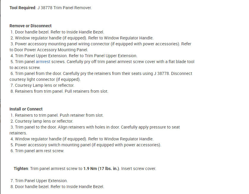

This means the latch has failed.
Here is a guide that will help with this:
https://www.2carpros.com/articles/car-door-hood-or-trunk-will-not-close
https://www.2carpros.com/articles/door-panel-removal

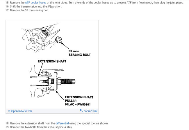

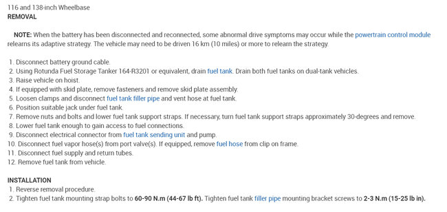

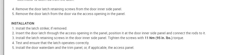

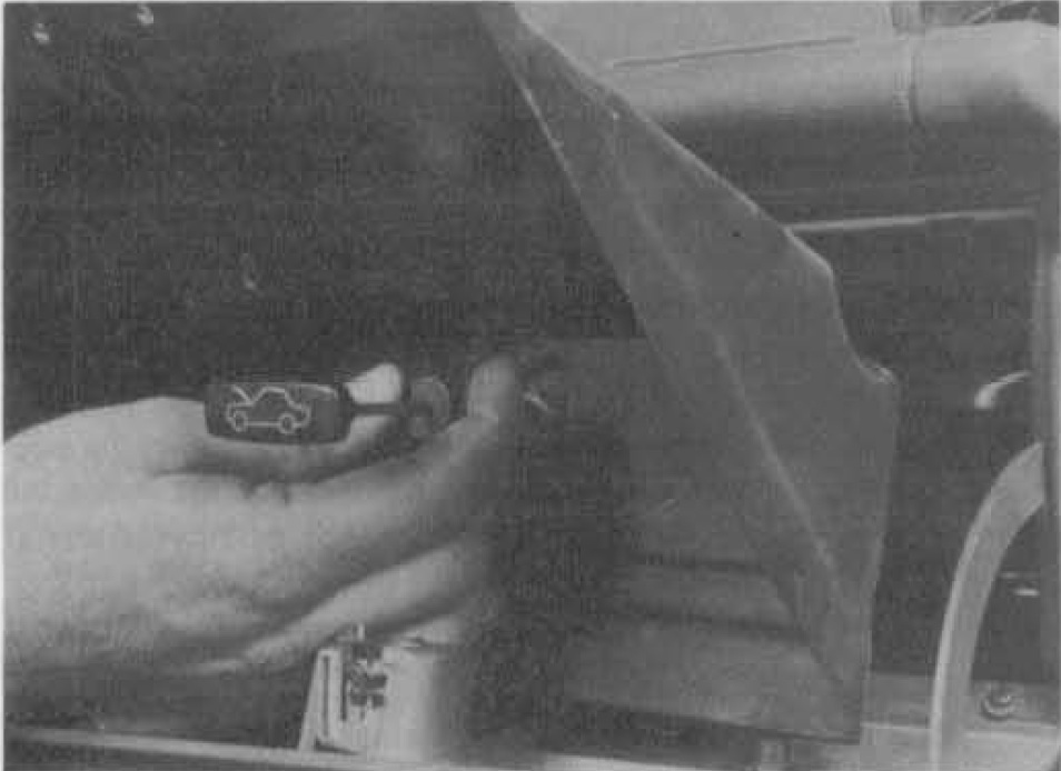

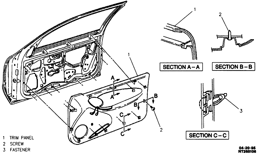

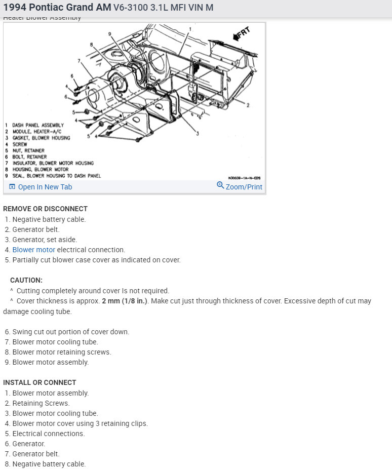

I am attaching the info below that will help with replacing the latch as that is what we need to do in order to get the latch to grab the striker.
Please run through this info and let me know what questions you have.
Thanks
