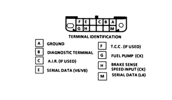

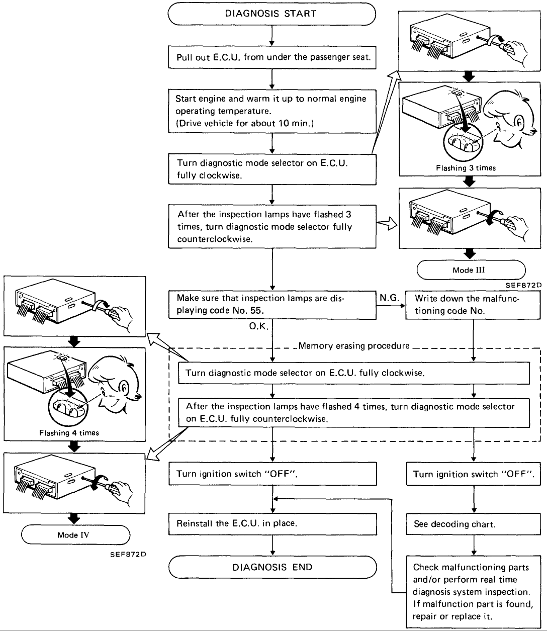

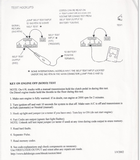

You have OBD1 system,
Used to Autozone had a Handout which showed you how to retrieve trouble codes. I think this could be done with a Analog or "Needle Type" voltmeter.........Me and my Dad just decided to go ahead and buy the "Snap in" reader (about $40, years ago) for the '86 T-Bird
Regardless which you use--You must COUNT (Beeps-or-LED lights-or-the voltmeter needle sweeping. There are pauses--This gives you the CODE NUMBERS.....For instance 3 beeps, pause, 4 beeps is "34" (just an EX.)
On the reader we bought it had 3 separate things that it read (I have CRS!) I'd have to dig that stuff out.
Usually the Check Engine Light is on if you have codes--Does your Check Engine light verify it "THE LIGHT WORKS" when you start your rig?
I may can help with how to get the codes---If Needed
This may tell you what system needs attention, instead of Trial and Error.

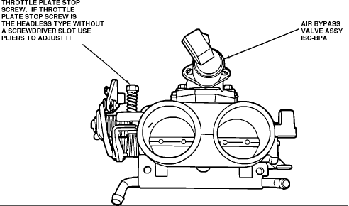

IF YOU HAVE MESSED WITH THE "IDLE ADJUSTMENT SCREW(S)........NOT GOOD G.I.!!!.....PROBABLY NOTICED IT IDLED UP OR DOWN TO COMPENSATE FOR YOUR TURNAGE...NOT GOOD!.....IT WAS SET TO "BASE IDLE" (EVERYTHING IS CALIBRATED TO THAT "SWEET SPOT") IF YOU TURNED 'EM, WE GOTTA GET IT BACK TO WHERE IT WAS.........PLEASE SAY YOU DID NOT!.....WE CAN WORK THRU IT IF YOU DID, JUST MORE WORK!

I bought the Haynes manual the other day. The instructions for the self diagnostic are in there. That will save you some time. This has a throttle body. No carburetor adjustments for me to mess (if there were that would have been my first mistake believe me). Will buy TPS and check for vacuum leaks. Keep the wife happy. I know mine will be happy when this is all said and done.

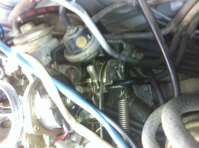

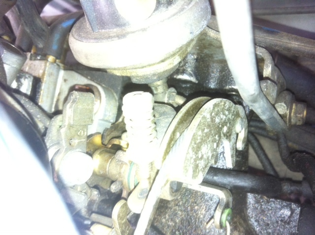

It's me again. Changed IAC,Engine temp sensor, cleaned throttle body, cleaned EGR valve. NO CHANGE. Can you say frustrated. And to top it all off after this was completed check engine light is now on. F***. Engine will idle fine at initial start up, but the longer it runs the idle speed increases. Starts at under 1000 rpm. After about 10 min of idle, or driving it idle will increase to 1500 rpm and stay there. This can't be good for the motor. Thinking MAP Sensor or TPS. But this is starting to get costly. Can you produce very detailed instructions to do the self-test? I have the Haynes manual but the instructions are very basic. Thanks

We keep talkin' timing, wear would minimally change it, anybody move it? Let's Rule it out, as a factor....CHECK IT!....Got tune up tools? Inexpensive set at "Harbor Freight"...less than $40, 'bout all you will need, compact, all in one case.
Current Codes, is the starting point!
Have you coded it?.......Codes?
Did you clear the codes, re-code again to see if the code #s changed?
Codes do not necessarily tell you what to change, they tell you what is being affected by a problem. I just dealt with/ still dealing with one, On a Toyota tuck, P0135, the codes meaning is "Fuel Air Metering"
This is OBD II--matters not! My 1st guess is throw on an O2 sensor ($99)....After talking with others, this may be a vacuum leak, something allowing in too much fuel, like a bad injector etc. .....not my truck, friends truck! If he spends $99, and nothing changes, he will not be happy! So, the O2 could be bad (not sending correct info to the computer) Or it could be sending back correct info...but not what the computer wants to hear! Computer assumes everything should be perfect...when something goes wrong.....It sorta points it's finger at "Who told it that!" NOT, "Who did it!"......Some of the time, it does point to "Who did it", depending on what went wrong!
If you messed with idle adjustments---Correct "base idle" may be off, confusing the computer (everything is calibrated to B.I.)
Check Engine Light on? Lets hear some code numbers!....Before you go further!

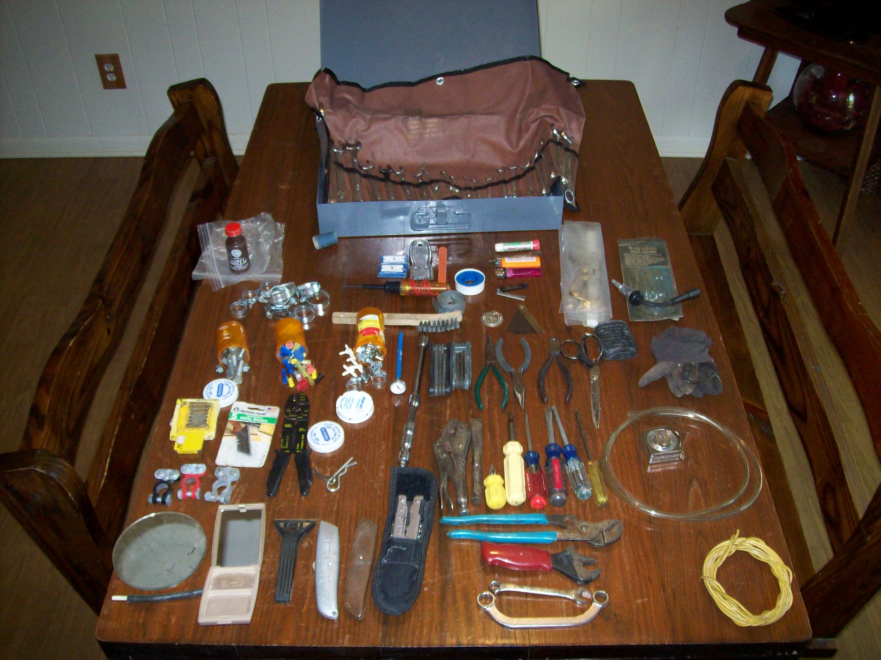

I am checking timing this weekend. Thanks for replying I thought I would lose you it's been awhile. As I said I have the Haynes manual and it gives instructions for getting the codes without the diagnostic tool. They are very basic as far as telling how to do it. The self-test plug under the hood has a pyramid shaped plug and one single plug for the self-test. The pyramid plug has 2 inputs on the top row and 3 on the bottom row. The single plug is just that a single input. The manual says to use a jumper wire and a voltmeter to retrive the the codes. But very basic on where to put those connections. Can you help? I would like to try this but don't want to do any possible further damage. PS I will be buying that tune-up kit.
Jun 2, 2011 at 5:54 PM
CJ MEDEVAC
  • 11,004 POSTS
Not trying to force you into the kit, it's just so...... every-things there!
Actually that one belongs to my buddy, I'm gonna get one to "travel" with, when friends call me!
I bought several of each piece, over the years, big stuff, decent stuff, kinda my Stay at the house tools, when I travel with 'em,......cumbersome, tangled, unprofessional looking!
My buddy is learning slowly, his set works very well, like I said, compact and all in one place.
Sending you a message, in a moment...Go "Home" click on "You", message center is to your left, click it, read!
The Medic

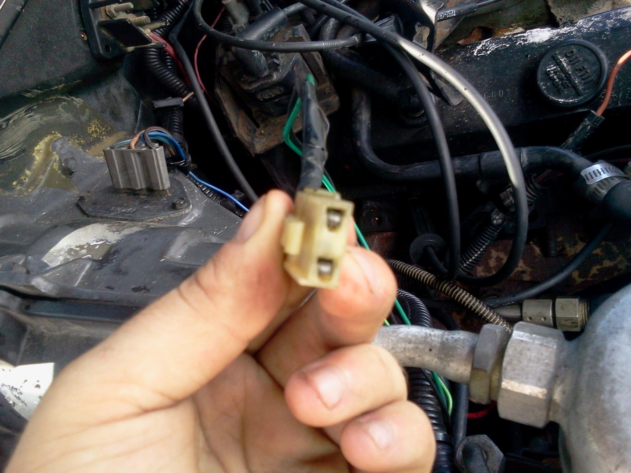

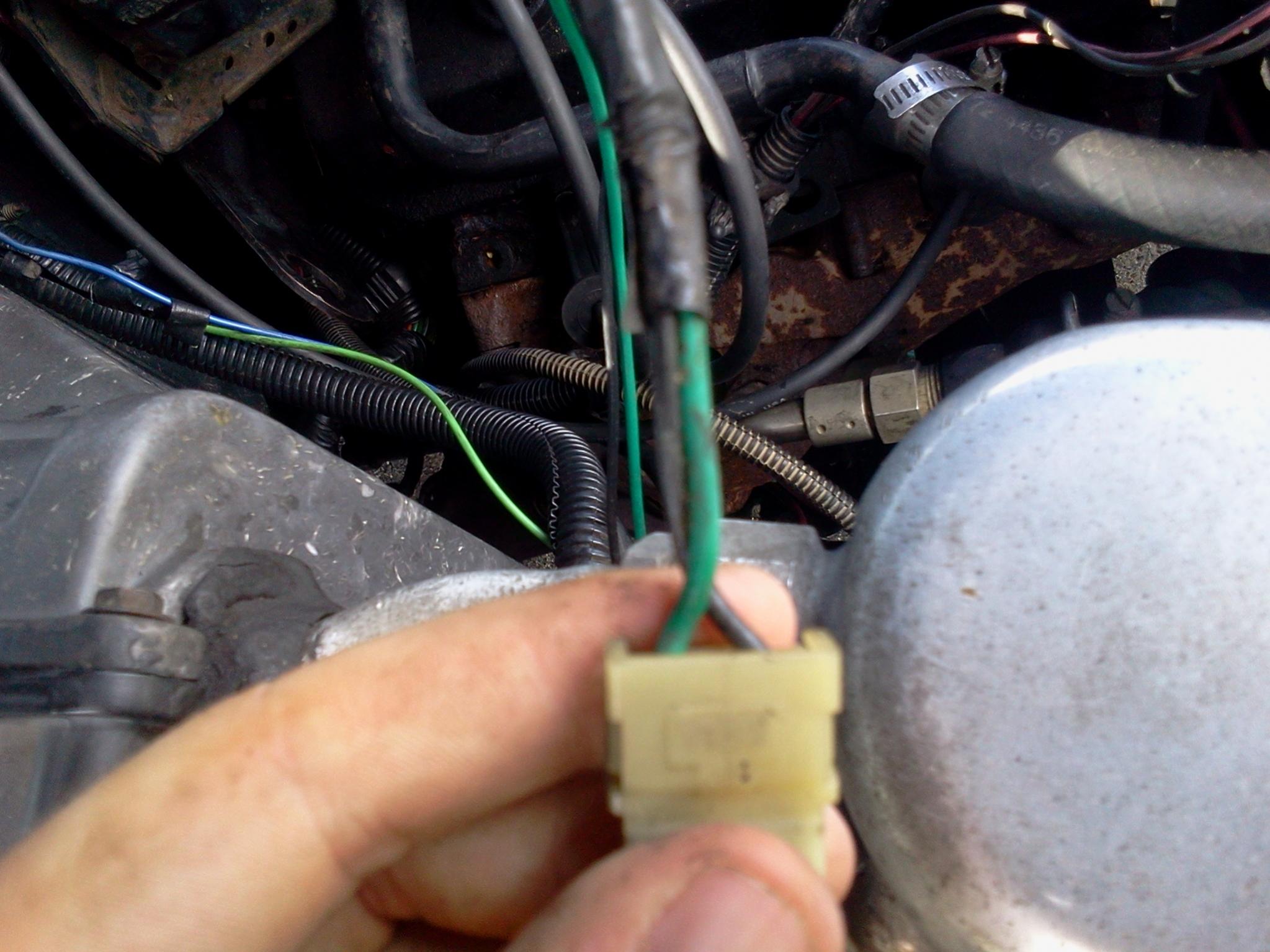

Sending message in a bit. Hope it's legible for you. Whether we figure it out or not, the effort you have given this is over and above what I expected. Pics may not be in order but you'll figure it out.

Roger received your commo (4) at my HQ...I am doin' Mama Checklist for a while, I will decode, soon as I return.

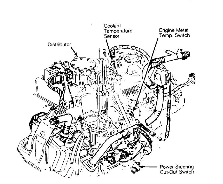

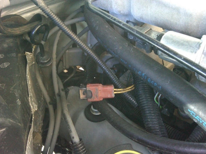

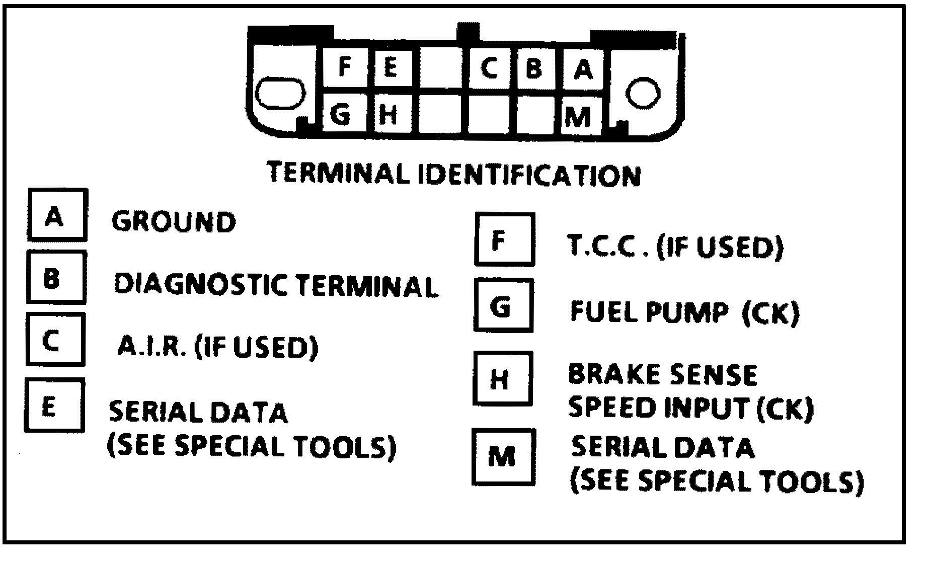

Finally checked codes. Alot easier than I thought. KOEO codes were [63] TP circuit voltage low. {fixed w/ new sensor] [85] canister purge solenoid circuit failure [???]. Continues codes [29] no input from speed sensor [I will buy new one] [31] pfe, evp, or evr circuit below min. voltage [???]. Any help with the question codes would help alot. Truck runs alot better now but would like to fix others if I can. I mainly need to know where to look for these codes. More or less a starting point.
Jun 6, 2011 at 11:03 AM
DOCFIXIT
  • 18,828 POSTS

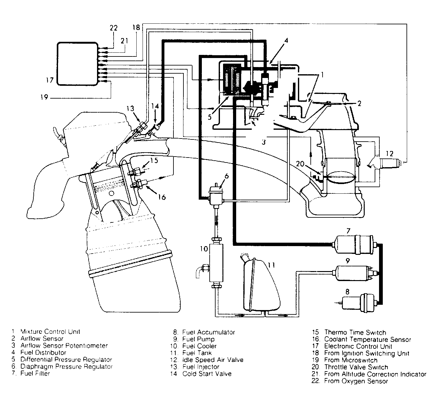

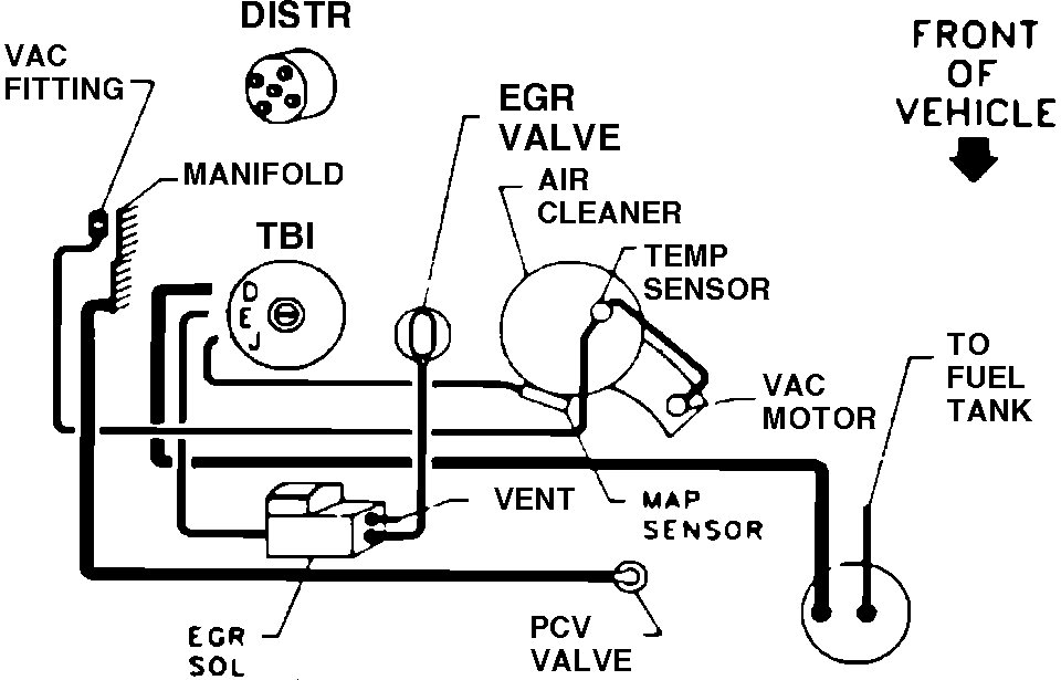

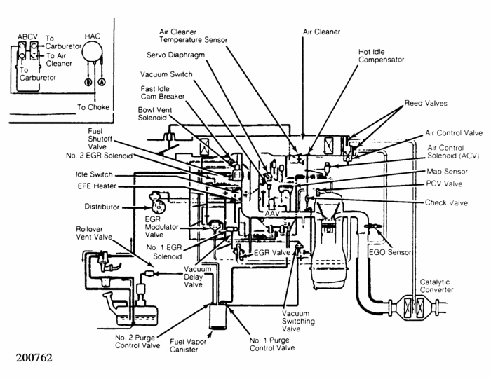

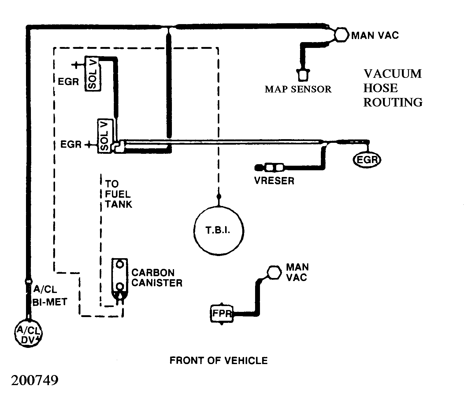

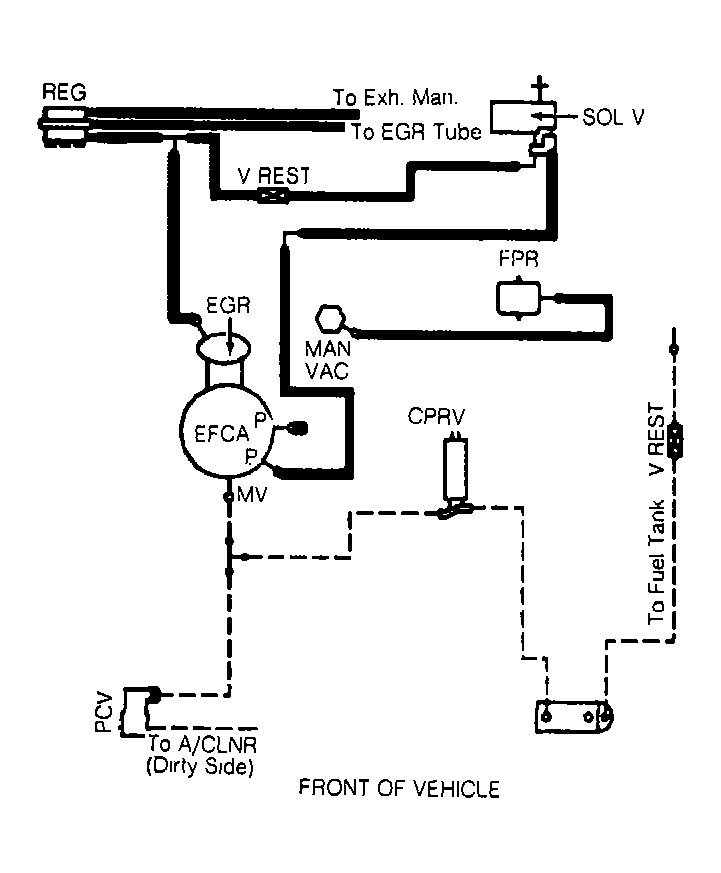

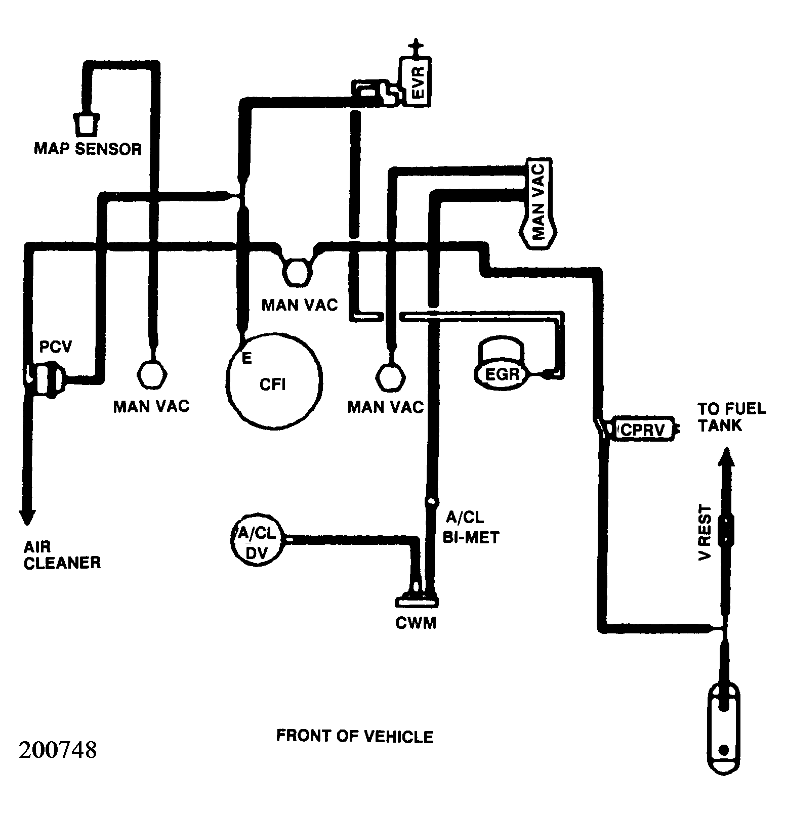

Check for vacuum present at EGR at idle and at 1500rpm. Look at diagrams is this ignition and type of fuel system?
Jun 7, 2011 at 11:29 AM
PACK1973
  • 16 POSTS

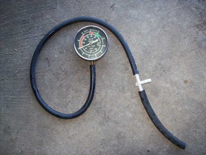

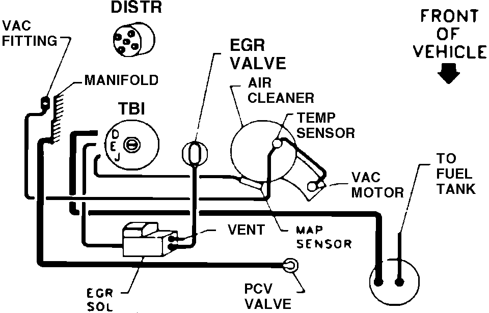

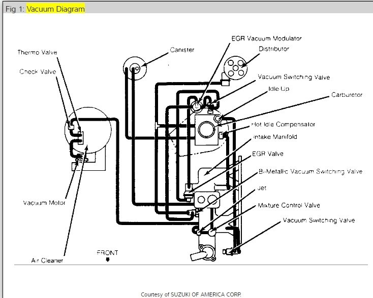

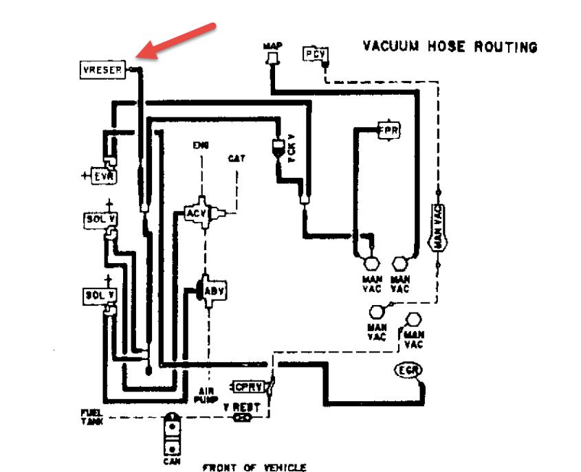

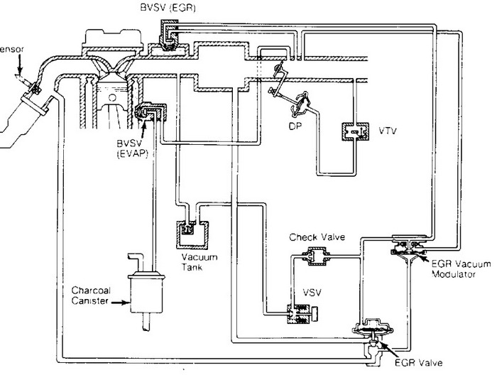

Would I need to have a hanheld vacuum pump, or can I just take the vacuum line off the EGR and see what happens? That diagram is very similar to my set-up.
Jun 7, 2011 at 2:33 PM
CJ MEDEVAC
  • 11,004 POSTS

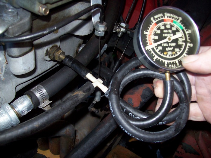

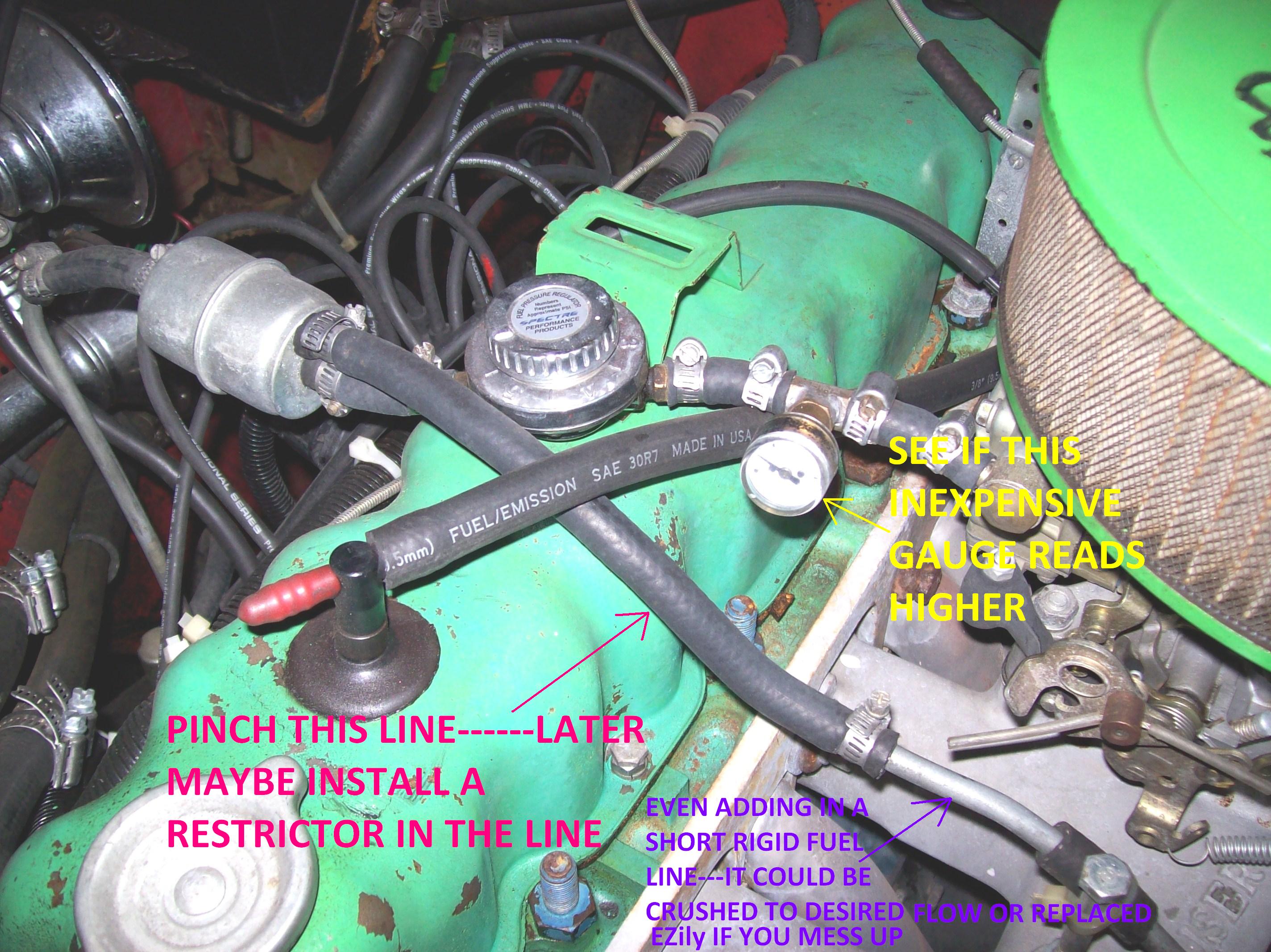

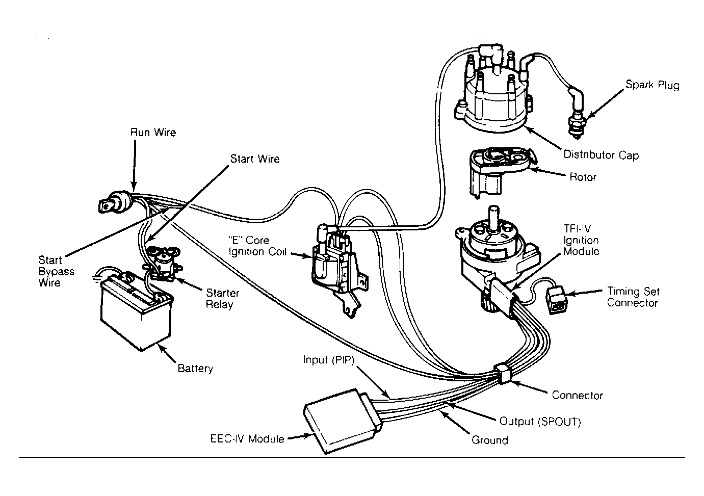

DO THIS---Except on the line to the EGR (not on manifold, as I show in my homemade pic)--The "TEE IN" may not be necessary, just the gauge on the EGR vacuum line.....Worst case, your finger to verify there is vacuum at the requested times......Good to have a good tune-up kit w/ all you need!
Jun 7, 2011 at 3:41 PM
DOCFIXIT
  • 18,828 POSTS

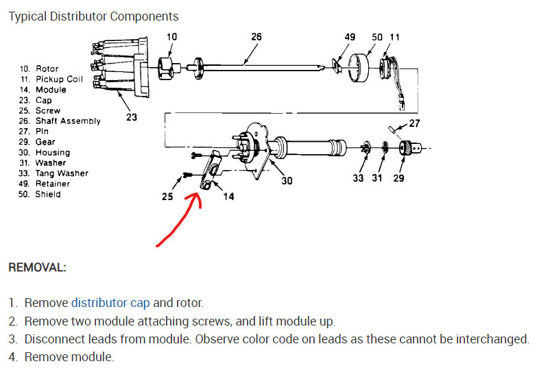

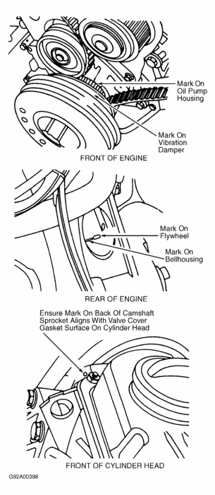

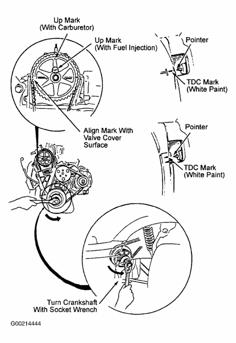

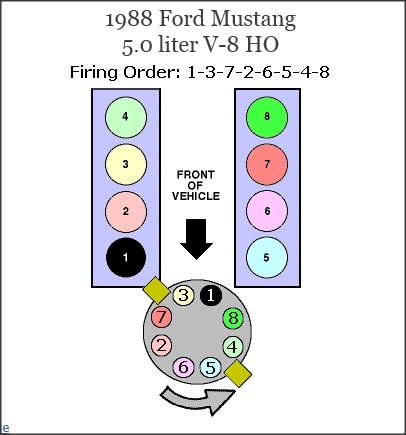

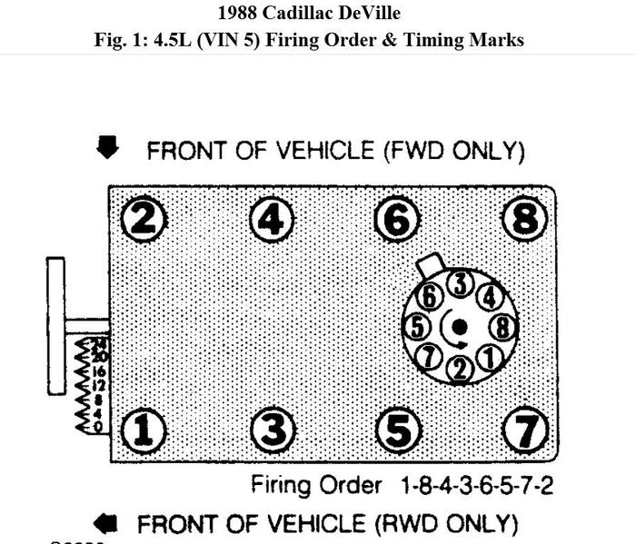

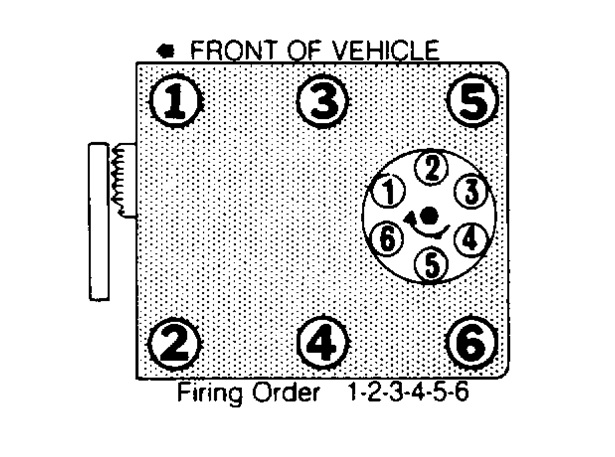

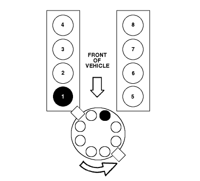

Remove TFI module have it checked at an Auto Zone. Long history of problems. As for engine timing as to chain wear remove DIST cap rotate engine to TDC cyl 1 pointer on "0". Now roatae engine counterclockwise note when rotor moves if more than 5DEG chain worn.
Jun 8, 2011 at 6:49 AM

Just got back in town. Thanks for the replys will try these asap. Just a few things noticed while out. When on freeway in 5th gear engine has a noticeable loss of power when climbing hills. Also strong oder of either gas or exhaust coming in cab of truck. Just threw this out there not knowing whether it may be related or if I should concentrate on the other issues first. I hope this power loss is not a signal of a weakening motor. Good News Please
