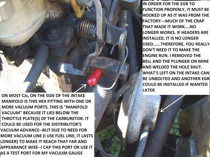

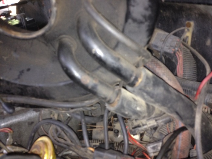

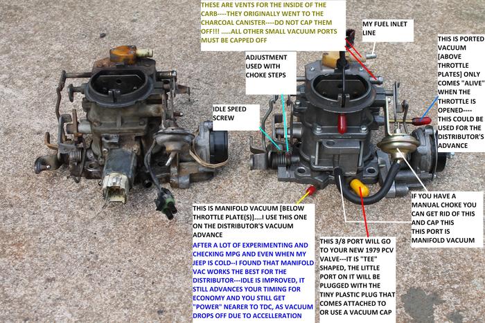

I'LL MAKE YOU A DIAGRAM OF NECESSARY VACUUM LINES SOON

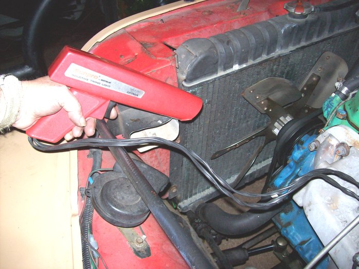

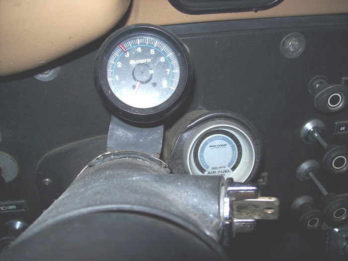

SO YOU GOT A DWELL/ TACH NOW?
MY TUNING STUFF IN THE LINK HELP?

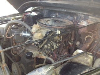

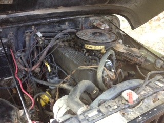

Yes dwe/tach was bought and got a great digital one as well. Timing seems to be perfect if 18 degrees is in the rigjt format.

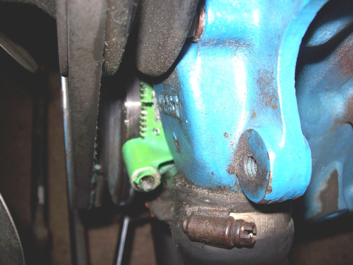

I'M SHOWIN' YOURS IS SUPPOSED TO BE
8 DEGREES AT 600 RPM

FUNERAL TO ATTEND LATER TODAY, I'LL WORK ON VACUUM LINES PIC, SOON AS I CAN

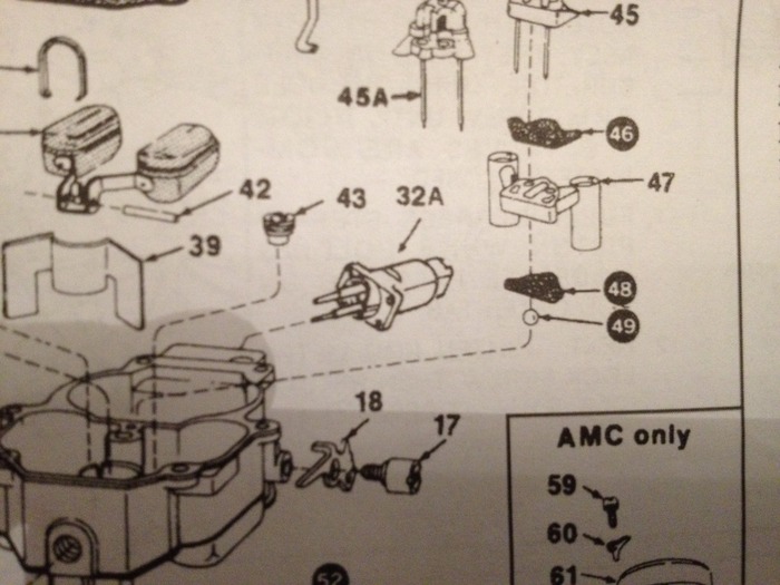

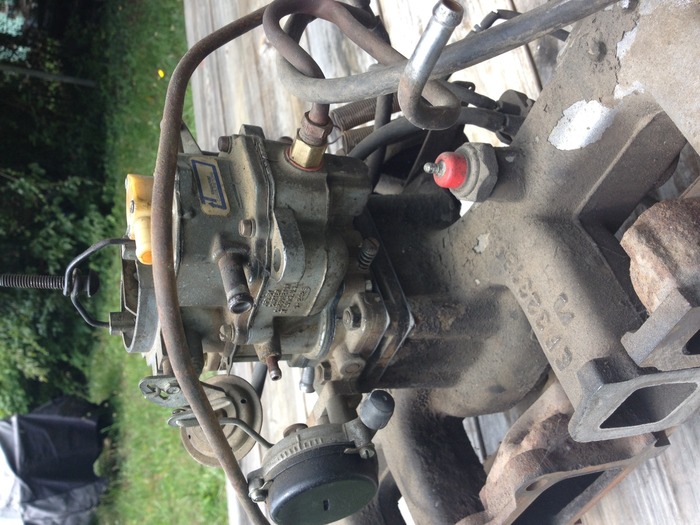

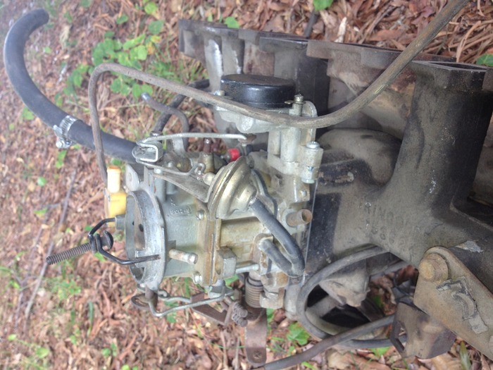

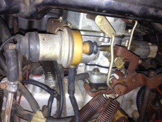

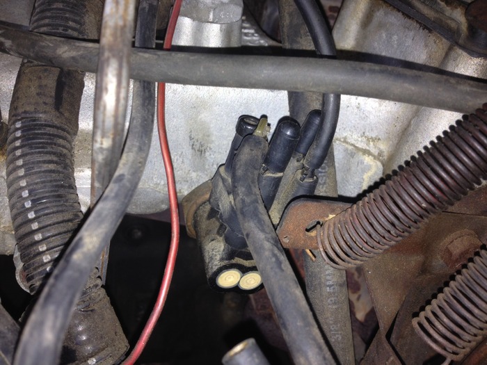

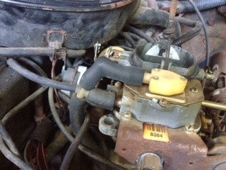

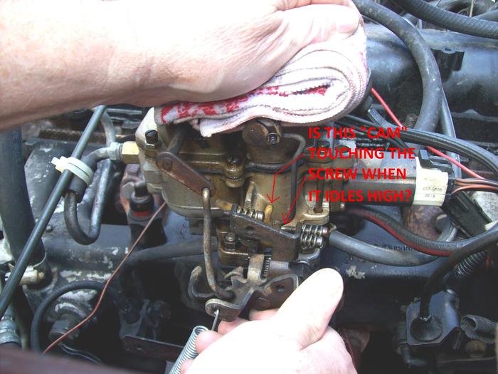

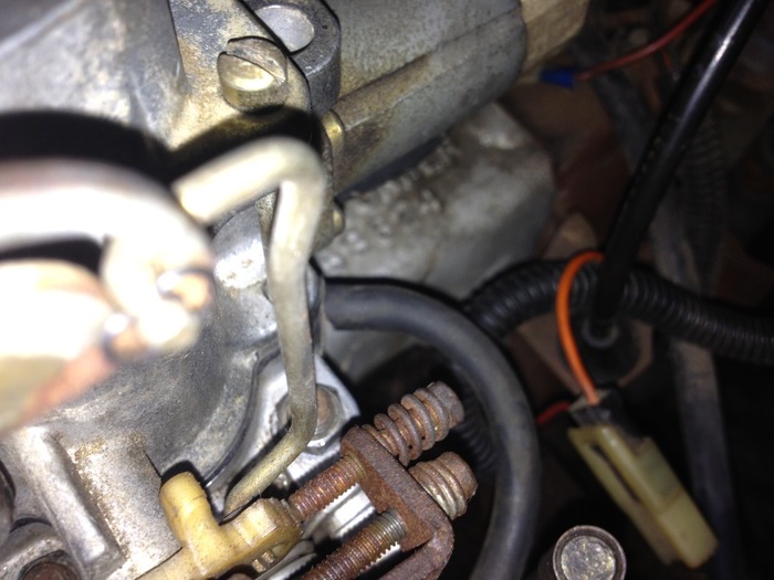

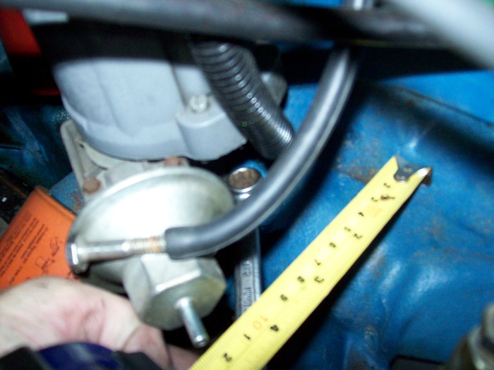

How do you adjust the electronic choke? As electronic choke stays on too long after being started
Sunday, December 7th, 2014 AT 10:27 AM
SCRAMBLER2007
  • 14 POSTS
Finally got it, needed to bend the linkage of the choke, took I little while to dial it in, replaced any vacuum lines that looked suspect and then bent the electronic choke unti I had about 1/8 inch gap at the choke plate. Fires up and runs great. Set timing to 8 degrees but Ike the performance better at 9.3.
Sorry you had to attend a funeral today, there is nothing good about the loss of a loved one, and from lots of experience only time can heal the pain. I will be praying for your loved ones.
And thanks again for all the support.
I didn't realize that the proper procedure was to bend something in a new carb to get the auto choke set. It was in a section of the childon manual, I read last night but didn't, think was accurate.
If you would ever like to go fishing, I am known as being very good for crappie, stripper, and bass. You pick and will put you on them. Cell number 770 315 8463. Will send send a donation and thanks again, would still like to take all the vac lines off.

IN THIS POST IS THE CHOKE ADJUSTMENT PROCEDURE
THERES A LINK IN THERE DISCUSSING MANUAL CHOKE TOO (TO A FORD TRUCK-SHOWS MY JEEP CHOKE)
