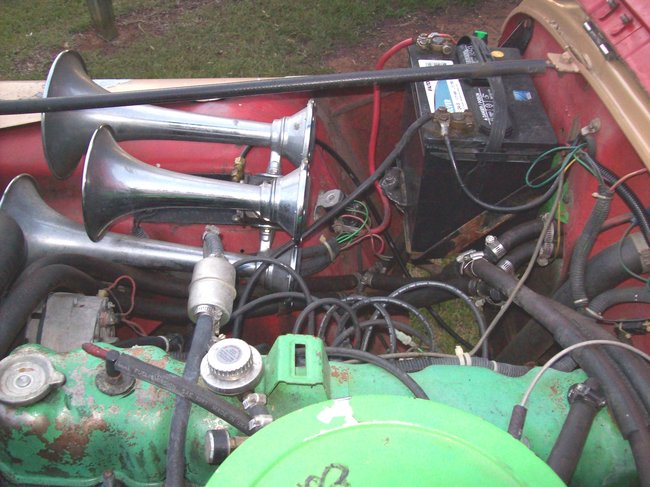

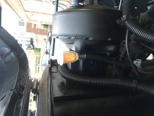

Recently I replaced the PCV valve, although I am still getting air that comes out, not into the valve cover.
Also to note, I only have smoke coming out, and not a ton, under idle (or acceleration). As I recently changed up the vacuum lines, I need to verify which one is currently causing the issue of smoke escape. I'll take a look at that this weekend, especially since my new fuel filters arrive tomorrow and I'll be messing with those?
Regarding the carb bowl vent, should I attach a line and filter from the carb to along the firewall that is inline with the filter from the tank? I imagine that you would want to keep this filter in a vertical position to serve its purpose.

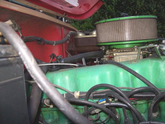

NICKED THE "CRANKSHAFT" THE REAR MAIN SURROUNDS IT
THE PIC I SHOWED THE CARB BOWL VENT HOSES (TEEed) TOGETHER AND ONE OF THEM FILTERS HOOKED ON TO THE BOTTOM OF THE TEE. ORIENTATION DOES NOT MATTER, FUEL DOES NOT COME OUT OF THESE HOSES, IT JUST NEEDS TO BREATHE.
IF YOU CAP 'EM OFF, WHEN YOU STOP DRIVING AND SHUT IT OFF, THE INABILITY TO "VENT" WILL MAKE THE BOWL SORTA BOIL OVER AND RUN OUT OF ANY OPENING (NOT ONLY A BIG FUEL SMELL, BUT A FIRE HAZARD TOO!)
I RECKON YOU COULD TIE THE BOWL VENTS TO THE FUEL TANK VENT, JUST REQUIRES MORE HOSE, A TEE, AND THAT'S JUST ONE MORE HOSE TO MAINTAIN AND CLUTTER THE COMPARTMENT!
WHEN I GET HOME, I'LL SEE IF I CAN TAKE PICS OF THE VENT HOSE ROUTING FROM THE REAR TO THE FRONT

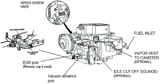

Back to the carb bowl vent, on my 32/36 Webber, basically off the front corner I would attach a small piece of line, and then the fuel filter correct? So I guess it doesn't matter if the filter is horizontal or vertical here right?

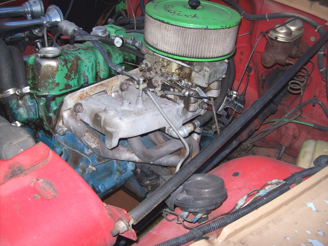

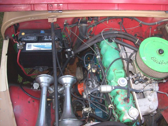

The weber has a breather port on the front corner (see attached diagram). Also last night I attached the fuel filter for the tank breather, and was able to do so on the bolt off the back of the brake booster. (See attached)

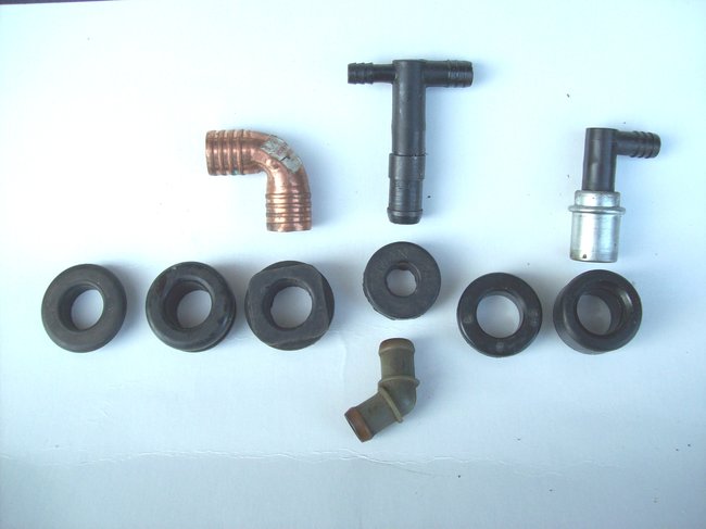

Regarding the rear valve cover breather that is currently blowing smoke, as this is used to draw in fresh air for the crankcase, you mentioned that air may be leaking in elsewhere, and I think I have an idea. As I have the aluminum valve cover now, the oil fill plug sort of sits in there and doesn't actually fit tight. I imagine this may be a large source of air leak. As this is the case, should I look to find a special plug that I can fit an expandable crank down type of plug, or can I just seal off the back opening that is currently leaking smoky air since its obviously already getting air from elsewhere?
Tuesday, May 10th, 2016 AT 6:26 AM
CJ MEDEVAC
  • 11,004 POSTS

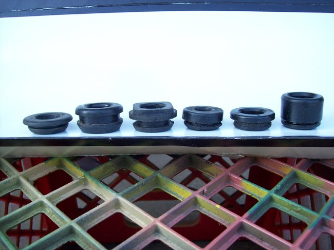

IT MAY BE THAT YOU ARE GETTING MORE BLOW-BY ON THE PISTON RINGS THAN THE PCV CAN SUCK OUT.
HERE'S SOME PICS OF DIFFERENT GROMMETS

Here is the valve cover I have
http://www.4wd.com/Jeep-Engine-Performance/Aluminum-Valve-Cover-Kit.aspx?t_c=74&t_s=552&t_pt=8136&t_pn=OAI17401.08
As it appears to be made by OA, I am hoping the above oil fill plug will fit.... however the one that came with it, and the one that I have on it now are more of a simple push in rubber plug.
