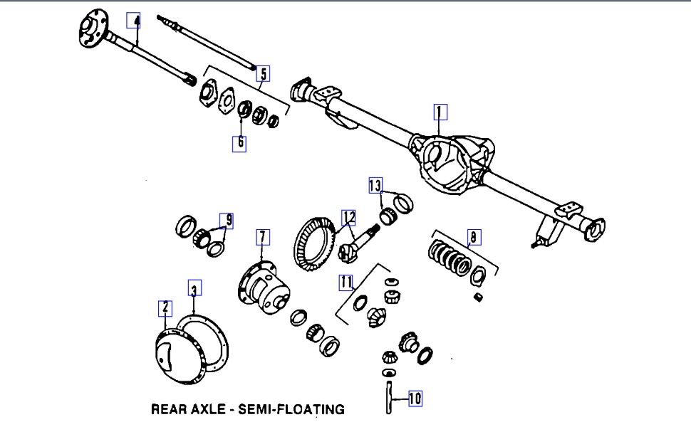

it wont go eny were in 2 weel high but the drive shaft is spinning i think it might be my rear end can eny pone verify

When you let out on the clutch, is there any noise, or does the Jeep sorta want to "lurch forward" even a little bit.....did it do do this, just before, it will do nothing?
This may not be your rear-end or differential
I'll tell you what to look for, when you respond with answers

LETS SNATCH THOSE CAPS OFF OF BOTH SIDES OF YOUR REAR WHEELS.
I'M TALKING ABOUT THE "HAMMERED ON" COVERS THAT NORMALLY COVER UP THE BEARING NUTS AND STUFF....ON OTHER "SUB-STANDARD VEHICLES"
IF YOU HAVE "PERTTY CENTER CAPS" IN YOUR WHEELS----REMOVE THEM AS WELL
NOW RE-INSTALL YOUR WHEELS---YOU SHOULD BE LOOKING AT A BIG OLE NUT, IN THE CENTER OF YOUR RIMS
THIS IS WHERE YOUR POSSIBLE "ENVIOUS-WANNA-BE" PALS COME IN!
YOU NEED "ONE PAL" STATIONED AT A WHEEL---A SECOND PAL AT THE OTHER MIGHT SPEED UP THIS TEST.....ONE WILL DO!
THE ALL FOUR WHEELS HAVE TO BE ON THE GROUND
NOW JUMP IN YOUR AWESOME VEHICLE AND CRANK IT UP
LET'S GET INTO 2 WHEEL HIGH
I WANT YOU TO "GET ON THE GAS" A LITTLE MORE THAN NORMAL (NOT TRYING TO DO A BURN OUT)
THEN LET OUT ON THE CLUTCH A LITTLE FASTER THAN NORMAL
YOUR JEEP MAY MOVE.....YOU CAN TRY FORWARD AND REVERSE
WHAT YOUR BUDDIES ARE WATCHING FOR IS:
THE BIG NUT SPINNING---BUT NOT IN SYNC WITH WHEEL ROTATION
SOMETIMES THE WHEEL NEVER MOVES, BUT THE NUT SPINS---SOMETIMES THE NUT SPINS AND THEN "CATCHES" AND THE WHEEL STARTS TO MOVE
NORMALLY ...I HAVE NEVER SEEN BOTH NUTS SPIN, JUST ONE OR THE OTHER
THESE NUTS HOLD THE HUBS ONTO THE AXLE SHAFT. THE AMC JEEP AXLES ARE CALLED 2 PIECE AXLES....THEY WERE POORLY THOUGHT UP, AS MANY PEOPLE HAVE HAD THE PROBLEM OF THEM "SPINNING FREELY"
THESE AXLES DO NOT HAVE A KEY-WAY (LIKE EARLIER JEEPS). THEY RELY ON THESE CRAPPY SPLINES INSIDE THE HUBS, THAT CUT THEIR OWN "GROOVES" INTO THE SORTA TAPERED AXLE....WHEN THE BIG NUTS ARE TIGHTENED "CORRECTLY" (250 FT-LBS)
EVEN PROPERLY INSTALLED THEY CAN FAIL---MANY PEOPLE WHOM HAVE REPLACED THE AXLES AND HUBS USUALLY DO NOT HAVE THE PROPER TOQUE WRENCH AND THEY ARE NOT TIGHTENED RIGHT
EVEN "SHOPS" DON'T DO IT RIGHT SOMETIMES........THEY DO NOT CARE ABOUT YOUR BABY, LIKE YOU DO!........I CARE ABOUT IT TOO, OTHERWISE I'D BE PAYING MORE ATTENTION TO THE "SWAMP PEOPLE" THAT ARE ON TV NOW!
NOW, IF YOU FIGGER OUT THIS IS YOU ISSUE---LET ME KNOW, THERE ARE A FEW WAYS TO CORRECTLY APPROACH THIS......WHICH MAY SAVE YOU TIME AND BROKE STUFF ALONG WITH A BUNCH OF WIRTY DORDS!......THE HAD WAY, WAS MY 1ST EXPERIENCE FINDING AND TACKLING THIS
LET ME KNOW WHAT YOU DO....WITH YOUR JEEP?....WHAT IS IT'S "MISSION STATEMENT" THIS MAY SWAY MY "FIX" RECOMMENDATIONS
WHAT WERE YOU A DOIN' THE LAST 50 MILES PRIOR TO THIS HAPPENING
I WILL AID YOU IN PARTS FINDIN' ALSO....BEST DEALS I CAN COME UP WITH
POSTING PICS HELPS ME TOO---I CAN WRITE STUFF ON 'EM AND POST 'EM RIGHT BACK....SHOWING YOU PROCEDURES. I HAVE MADE MANY JEEP FIX PICS FROM MY OWN. I HAVE YET TO MAKE SOME OF YOUR ISSUE, SO YOUR PICS MAY AID OTHERS IN THE FUTURE
I STARTED WITH THIS, 'CAUSE I HAVE SEEN THE SAME SYMPTOMS SO MANY TIMES!
SHOULD THIS NOT BE YOUR PROBLEM....WE WILL CONTINUE ON!

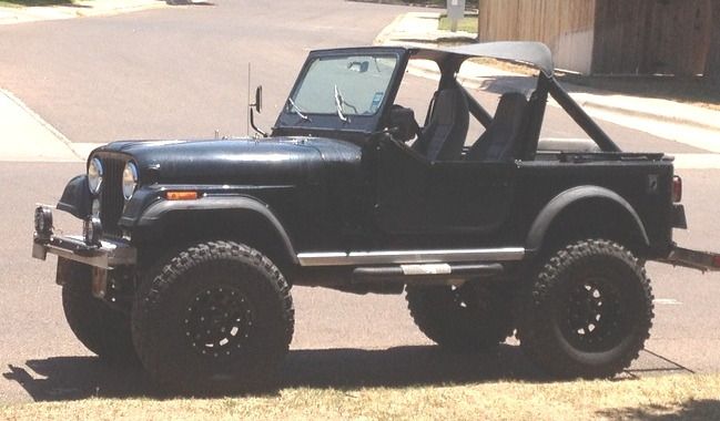

DUKEBOY4LIFE
I just bought an 81 CJ7 Laredo 4 cylinder engine 4 speed transmission. It went straight to the shop for a 4” lift and wheel package. I try to drive it out and there’s no power. It won’t move. It starts up and idles fine but won’t drive. I go to put it in 4 Lo, and it moves slightly. Any help greatly appreciated.
