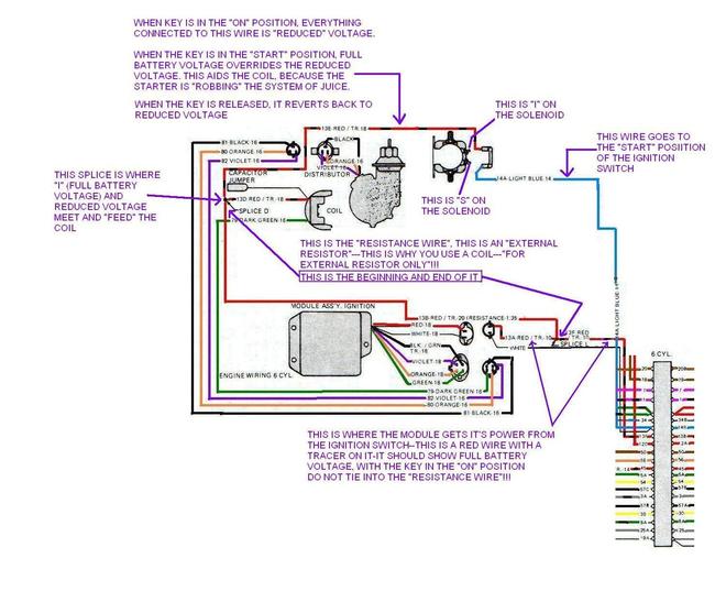

PRESENTLY WORKING ON A JEEP WITH SIMILAR ISSUES TO YOU
I AM YOUR BEST HELP FOR MILES!
PLEASE VIEW THE POST I'M REFERRING TO. THIS MIGHT SAVE ME A LOT OF HUNTING AND PECKING!
DO ME A FAVOR, COME BACK TO THIS POST (DON'T ANSWER THERE!), TO COMMO WITH ME, IF BOTH OF YOU RESPOND BACK TO ME AT "HIS POST" I WILL PROBABLY GET CONFUSED WITH THE BOTH OF YOU!
HERE'S THE LINK, IF IT WORKS, IF IT DOES NOT HIGHLIGHT, COPY AND PASTE IT ONTO A TAB SO YOU CAN VIEW IT!
https://www.2carpros.com/questions/1984-jeep-cherokee-cj7
YOU WILL SEE THE SECTION YOU NEED TO READ HALFWAY DOWN OUR CHATTER
RETURN HERE, IF THE "NO START PART" DOES NOT WORK, I WILL GIVE YOU THE NEXT STUFF TO TRY.

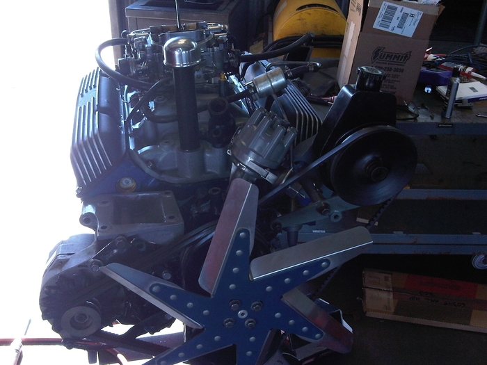

Present Two, #6 and #7

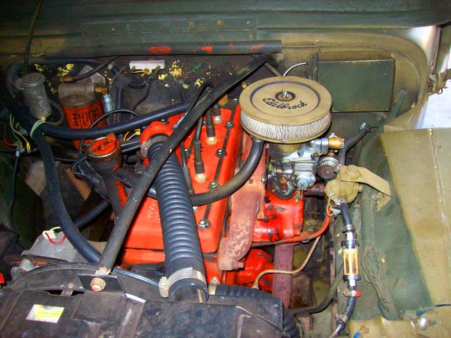

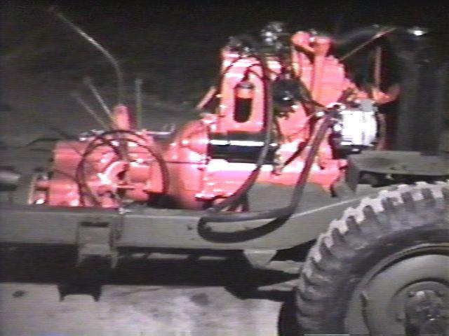

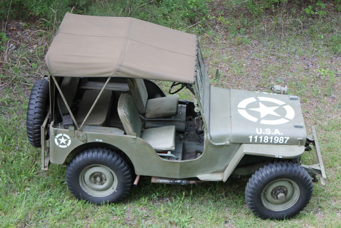

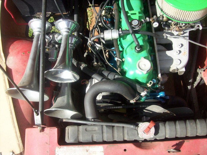

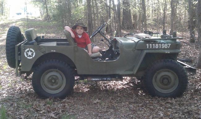

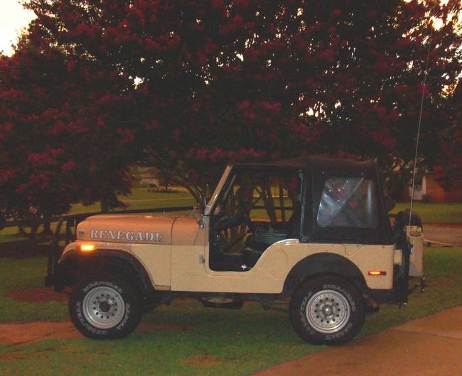

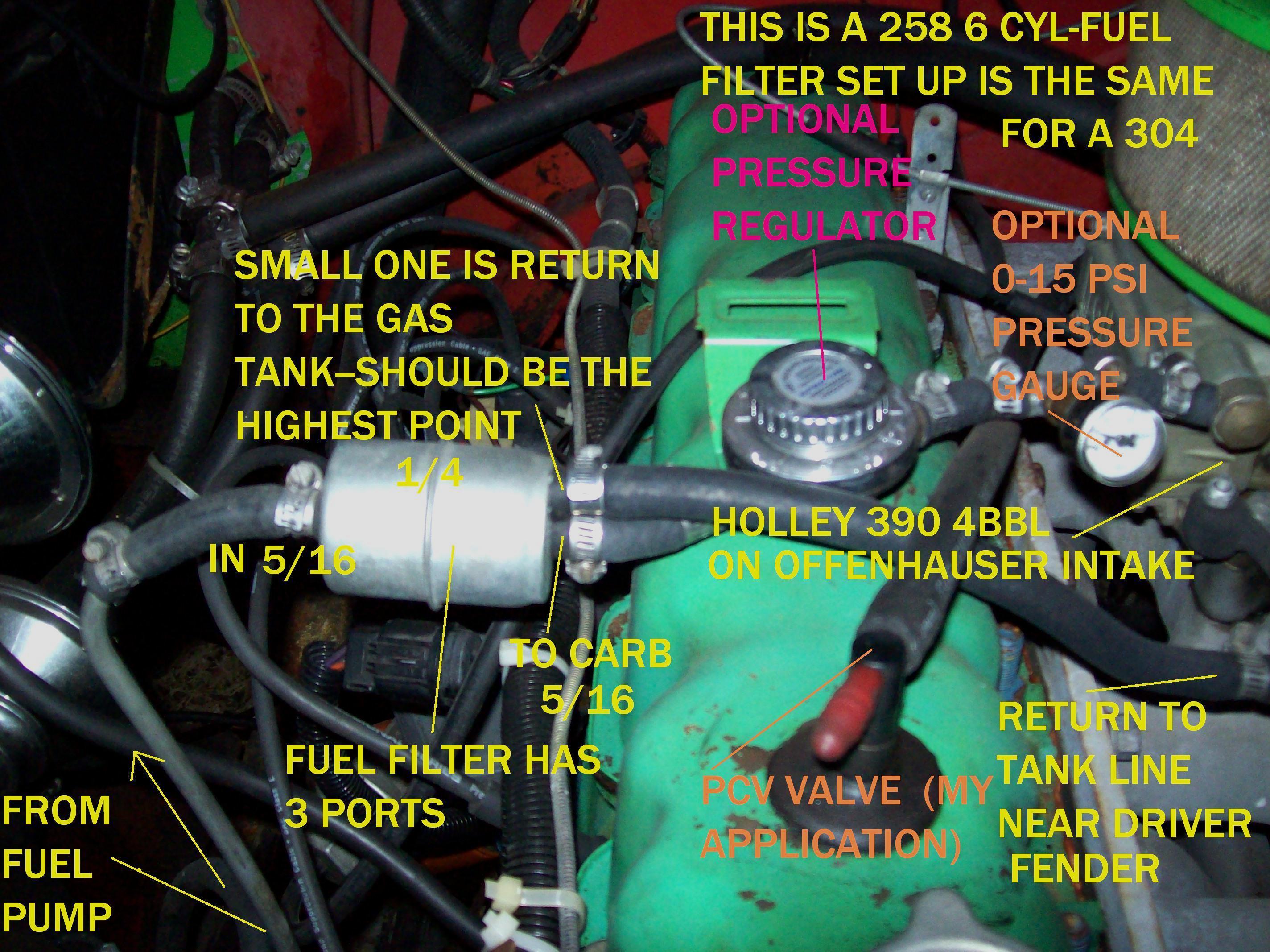

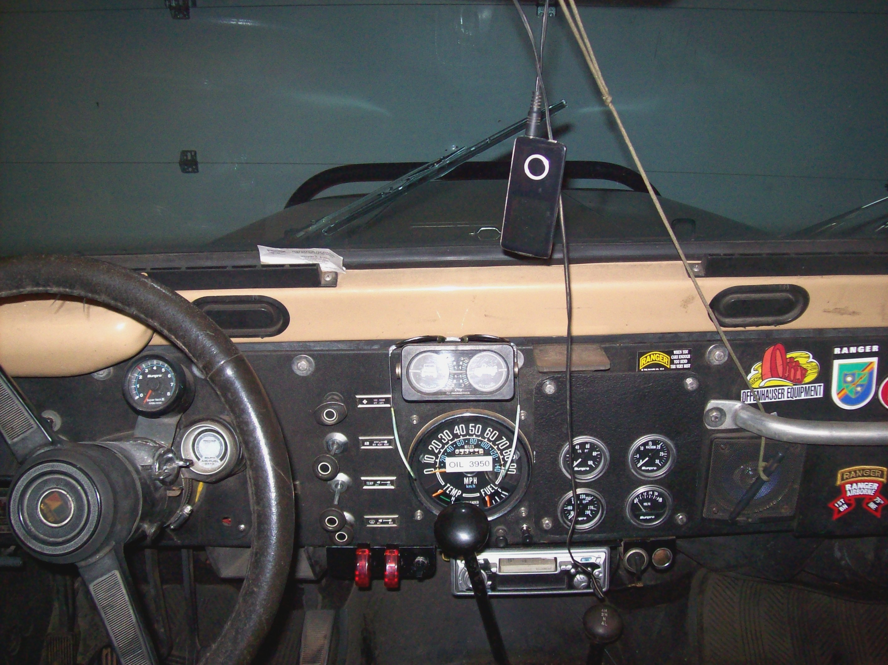

1st Pics i977 CJ 5 258 w/ 4bbl 390 Holley..."Mr. Jeep"

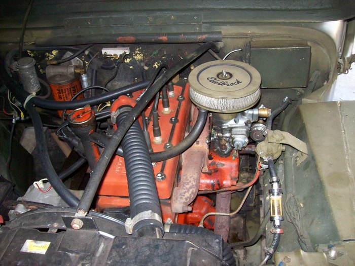

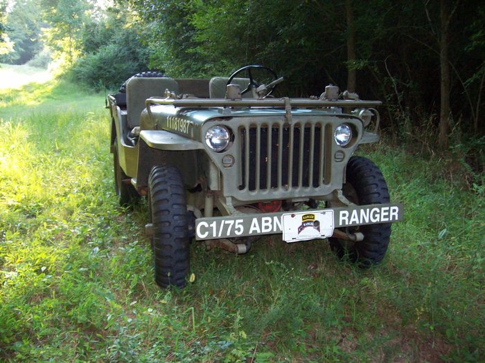

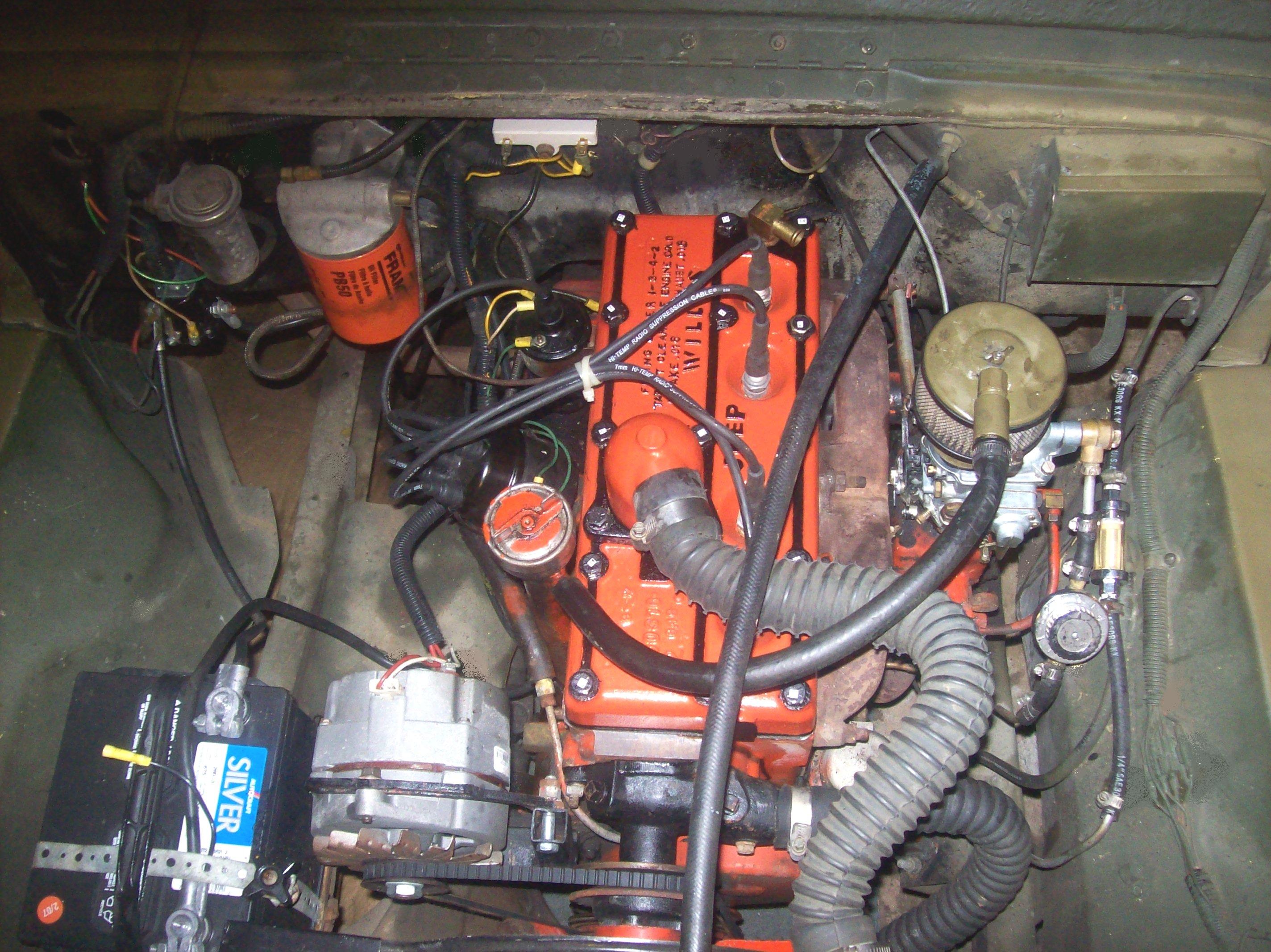

2nd pics 1946 Willys L--134...."Willy"
