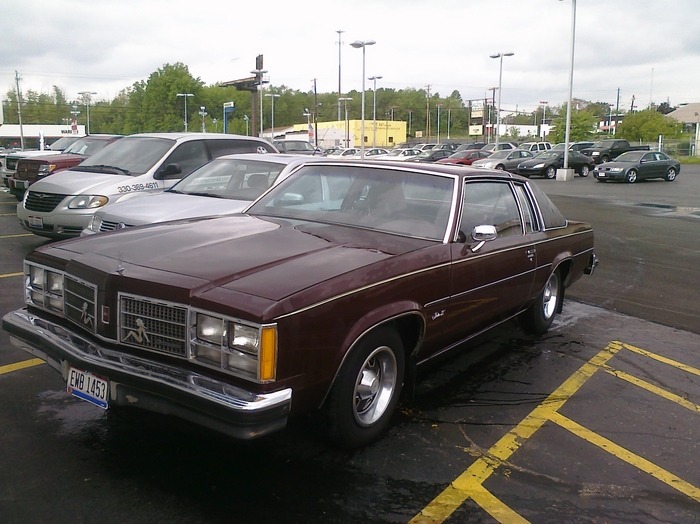

Someone is selling a Cadillac online for 1,200 Canadian dollars. Runs and drives, decent shape (so he says) and good fixer upper. Says it has a 350 Oldsmobile engine Now I am no mechanic but I was under the impression the engine was different. Was it changed? If so is that still a decent engine? I am a complete newbie to car mechanics. But lately I have been wanting to get into it. I know almost zero. But in my financial position it is unlikely I will have a brand new car, so I figured learning to fix an old one up would look cool, give me something to learn and hopefully save me some money on mechanic costs in the future. Is it an easy car to work on for a beginner? What should I like for when I buy it? I am mostly looking for what it will need to run and pass inspection. Here is the link

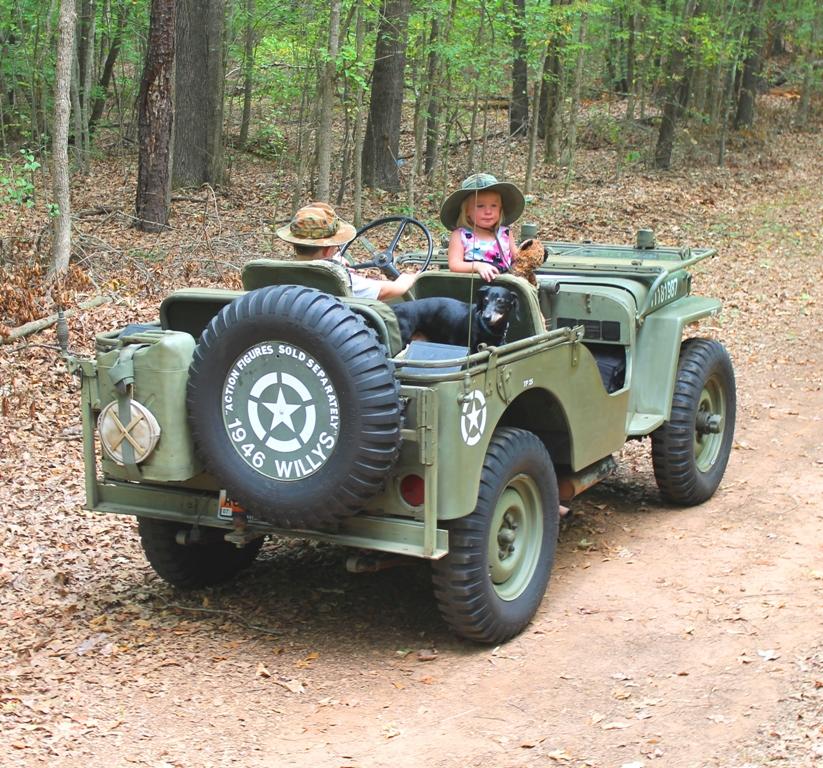

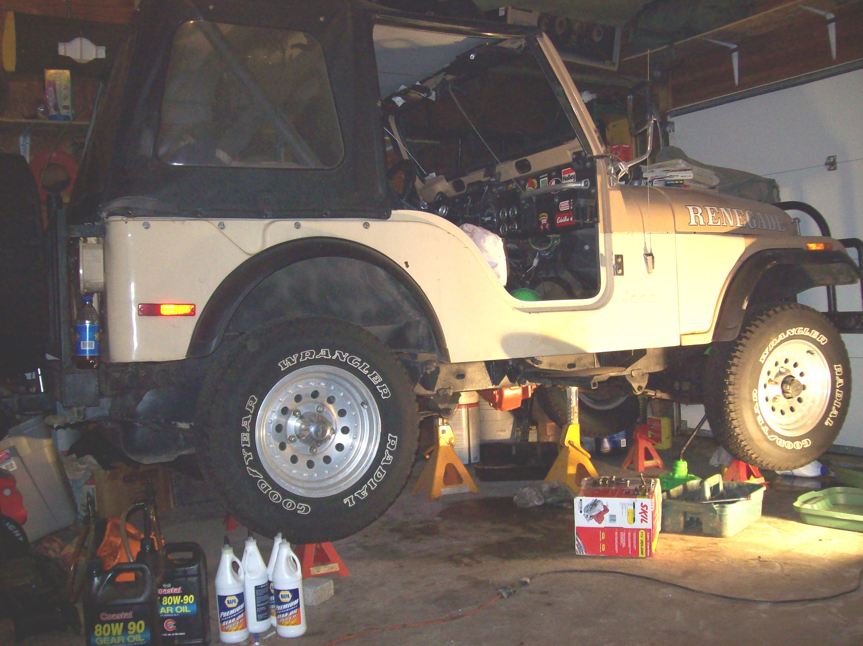

I have had nothing but Jeep CJ's for daily drivers ever since they let me on the asphalt in 1981. My present two were obtained in 1991. "Mr. Jeep" is a 1977 six cylinder (daily) and "Willy" is My 1946 Willy's (Driven every chance I get).
Payments (one for each)
Mr. Jeep $2,400.00 (road ready). Modifications over the years.
Willy $100.00 (two years later road ready). They all laughed at me when I brought him home on a trailer. They did not have the vision I had!

Yep, it is a 350 Oldsmobile gas engine. Why? Simple, that car was bought with the Other 350 Oldsmobile engine, an engine which made diesel a bad thing in the US. Namely the 350 LF9 Diesel. The POS built using a modified 350 Oldsmobile block and special heads to build a diesel engine for GM to use.
The common "repair" to rid oneself of that lovely pile of junk was to simple remove it, bolt in the Oldsmobile gas engine and have a much better car. It is a very easy swap as you use all factory parts.
