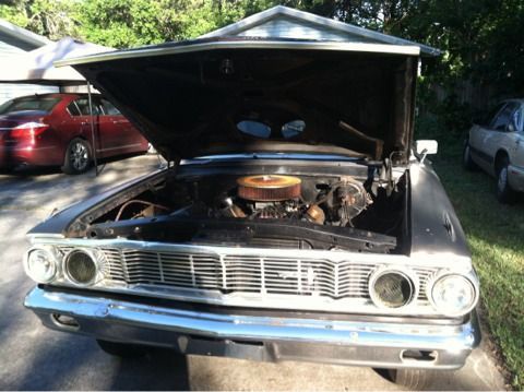

Need exploded parts diagram for reservoir. New filter does not seat with spring, etc. Must be more parts to retain the filter against the top, like a washer or retainer of some sort. Need to know the parts inside the reservoir and how they stack together with filter.

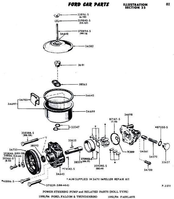

I FOUND THIS DIAGRAM---MAYBE IT'S YOU?

cj found a diagram but from what I always remember the spring went on top. there may be something that goes inside the filter to hold the spring but that is so damn long ago I forget. if the spring goes through the filter then what I would do is go to hardware andsee if you can find a body washer that is large enough to partially block the center so the spring won't go through it. if I remember it's an eaton pump and parts are still available at rock auto but I couldn't find anything for the center other than pump and filter.

That diagram pretty much nails it. I can see I am missing some parts which Larry's Thunderbird in Corona, CA, my source, does not have. So will have to fabricate I think. Interesting it does not show the filter nor the spring so it is not obvious how all that fits together.
Thanks a million.
