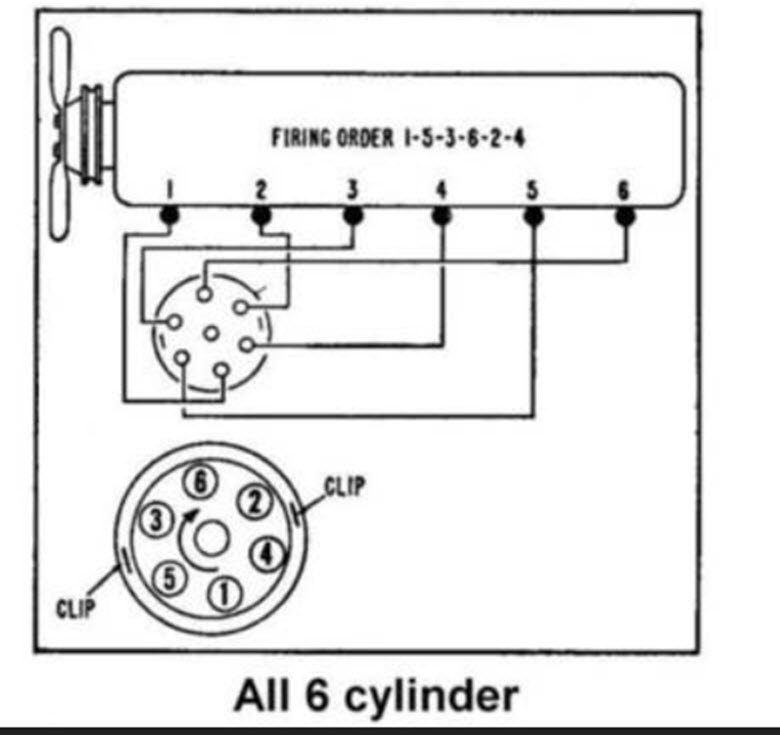

Can you give me the firing order for my car it has a gas engine? I have the order for the plug wires, but need the order for the distributor cap, and location of plug #1. Thanks!
Aug 23, 2016 at 6:48 AM
HMAC300
  • 48,601 POSTS
unfortunately we do not list anything for the Benz that far back. #1 should be first cylinder in engine if a straight six and firing order is normally 1-5-3-6-2-4.
Aug 23, 2016 at 7:36 AM
HMAC300
  • 48,601 POSTS
I found this online so try it......
