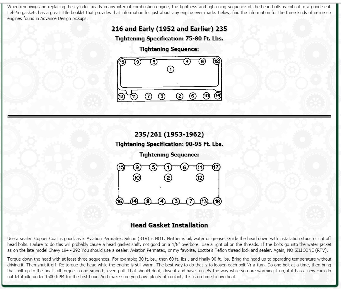

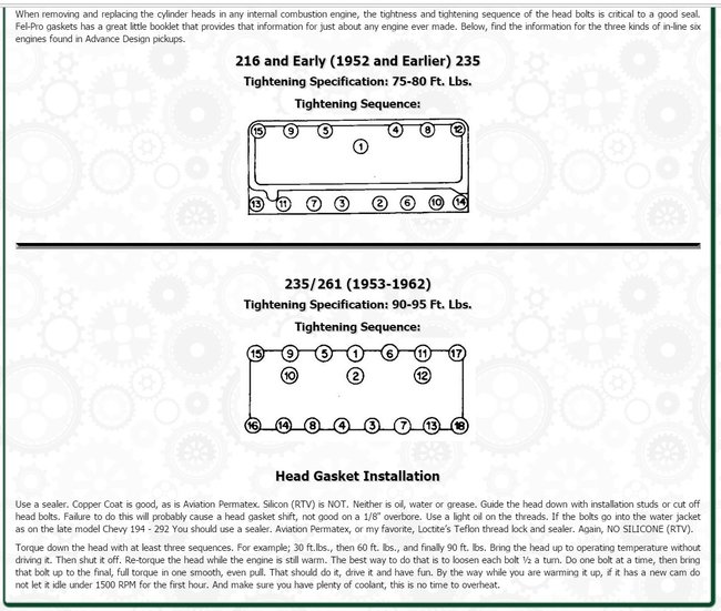

I am rebuilding my 1953 Bel Air 235 inline six cylinder. I need the torque specs for the bolts if you guys know any website will be much appreciated.
Feb 21, 2017 at 2:25 AM
  • 55,709 POSTS
Hey SPIDERSOLIS,
Here is the information you need for your car, what a fun project! please post pictures of the job if you can.
Best, Ken
