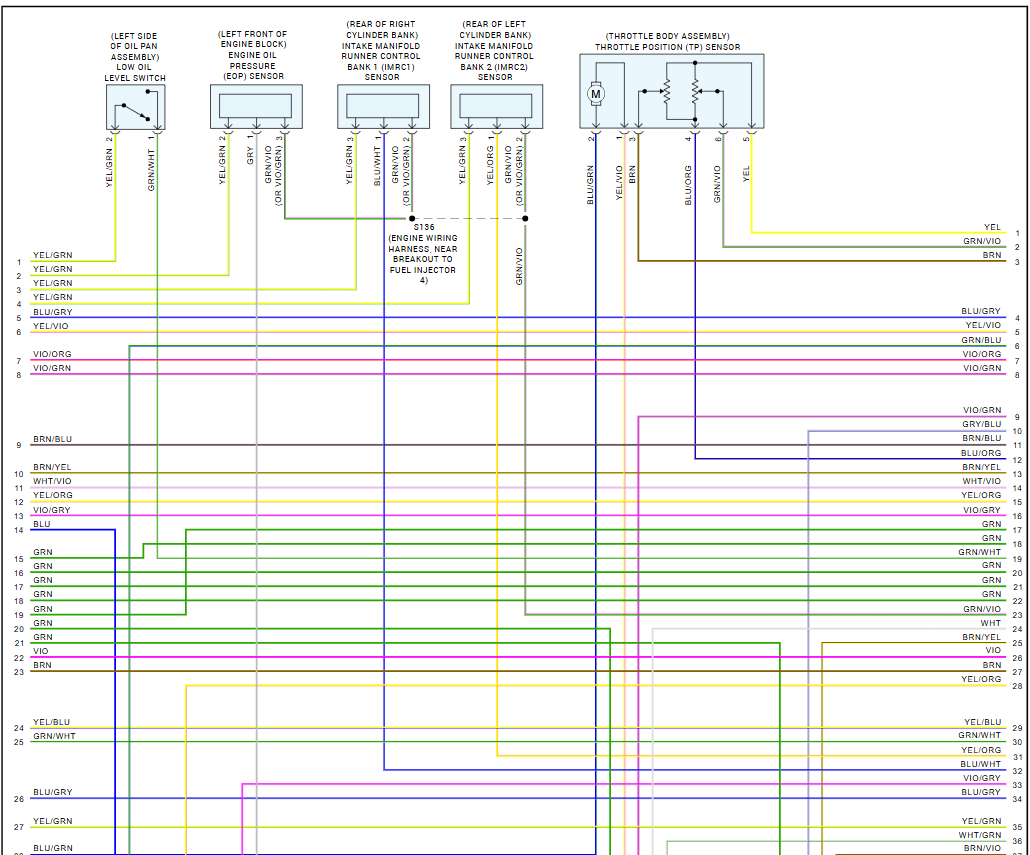

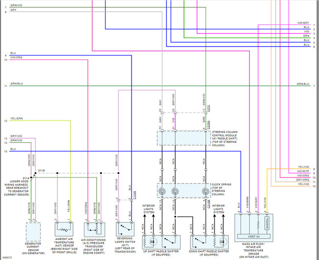

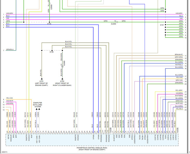

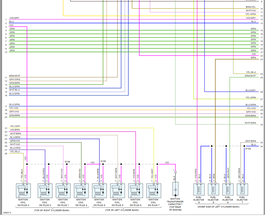

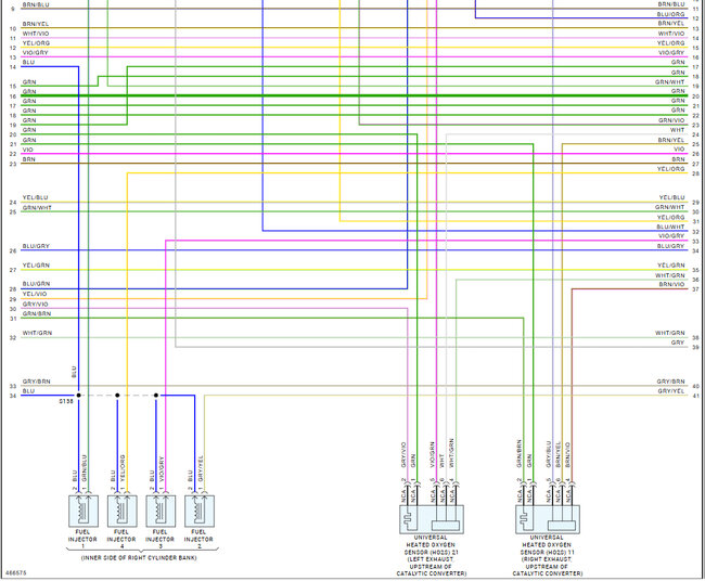

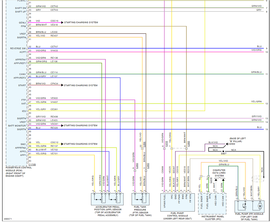

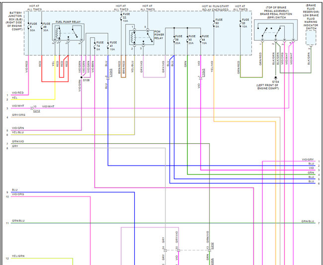

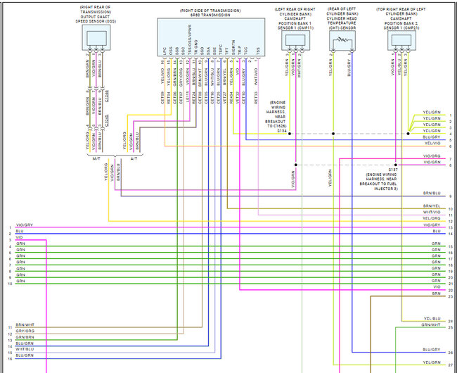

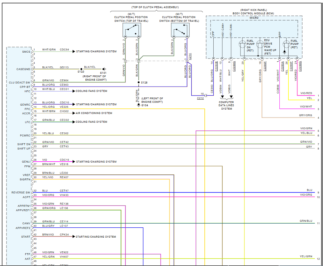

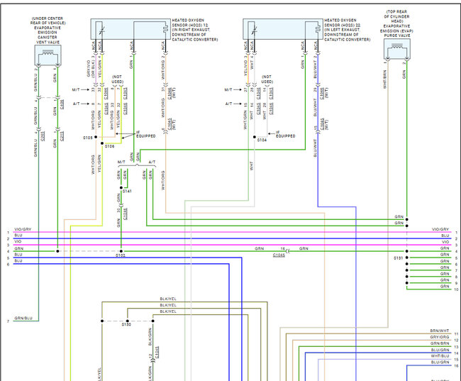

Hi, I have a wrecked 2015 GT350 Mustang and I am in the process of swapping this into a 1955 F100 truck. I am looking for the engine ECM pinouts, and any harness diagrams, so that I can get it running in the frame.

That sounds like a fun project! Please post images! Here are the wiring diagrams for the 5.0-liter Ford Mustang engine and a guide to help you with any testing you need to do.
Check out the images (below). Let us know if you need anything else.
