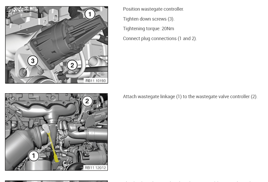

Boost hits 15 PSI then has a drive train malfunction. Locking it to 8 PSI. Rough idle when in gear and acceleration seems slower than before.

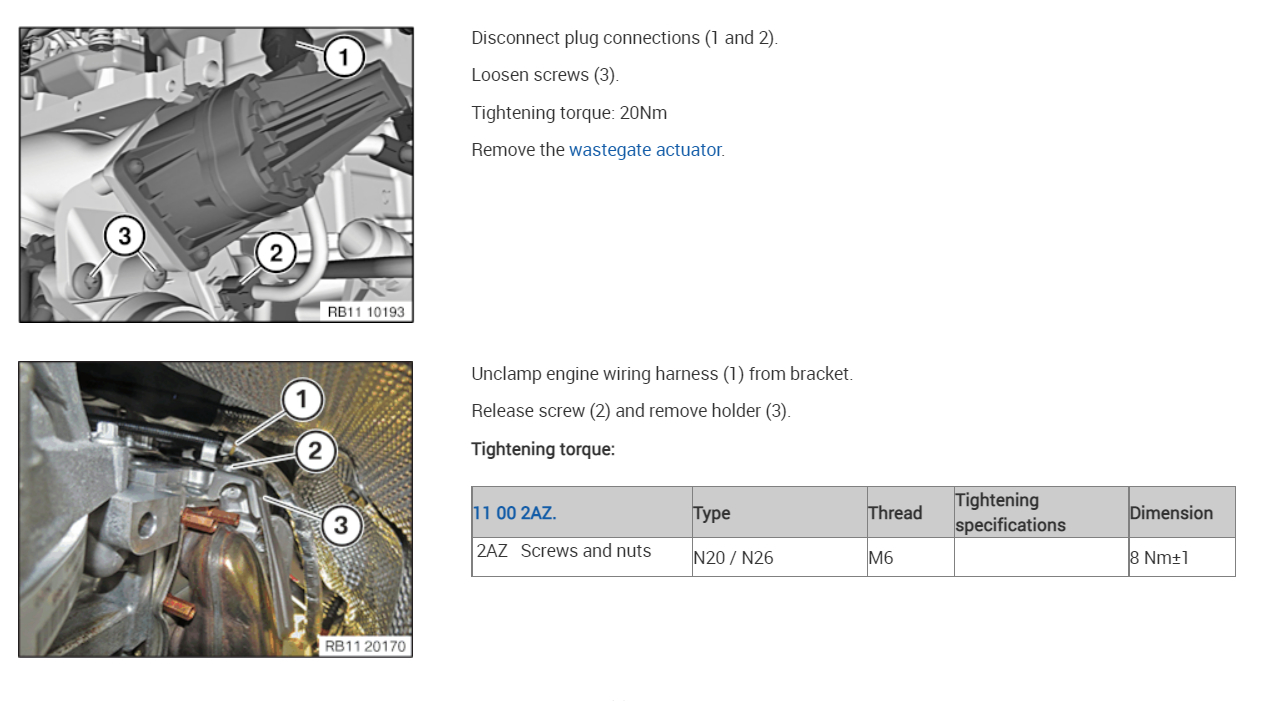

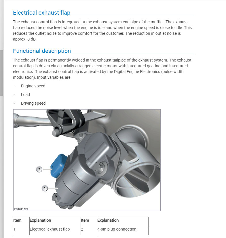

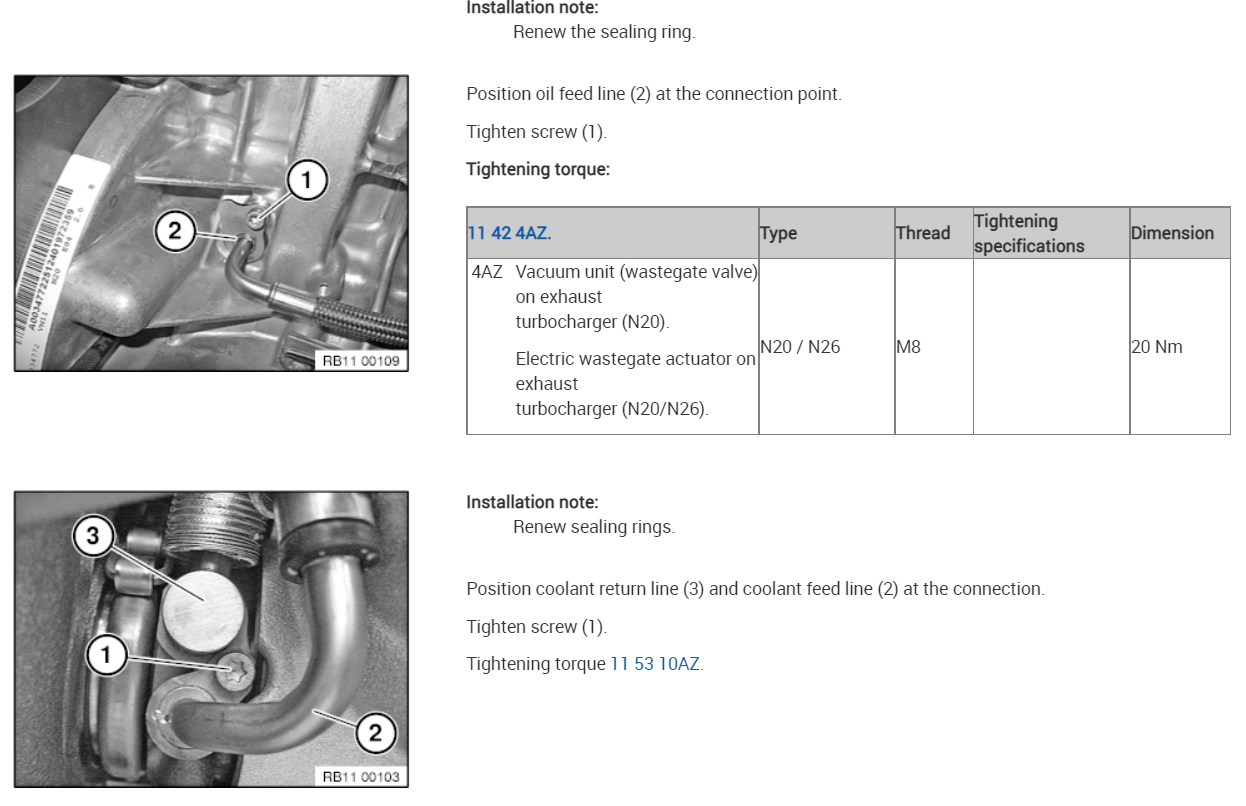

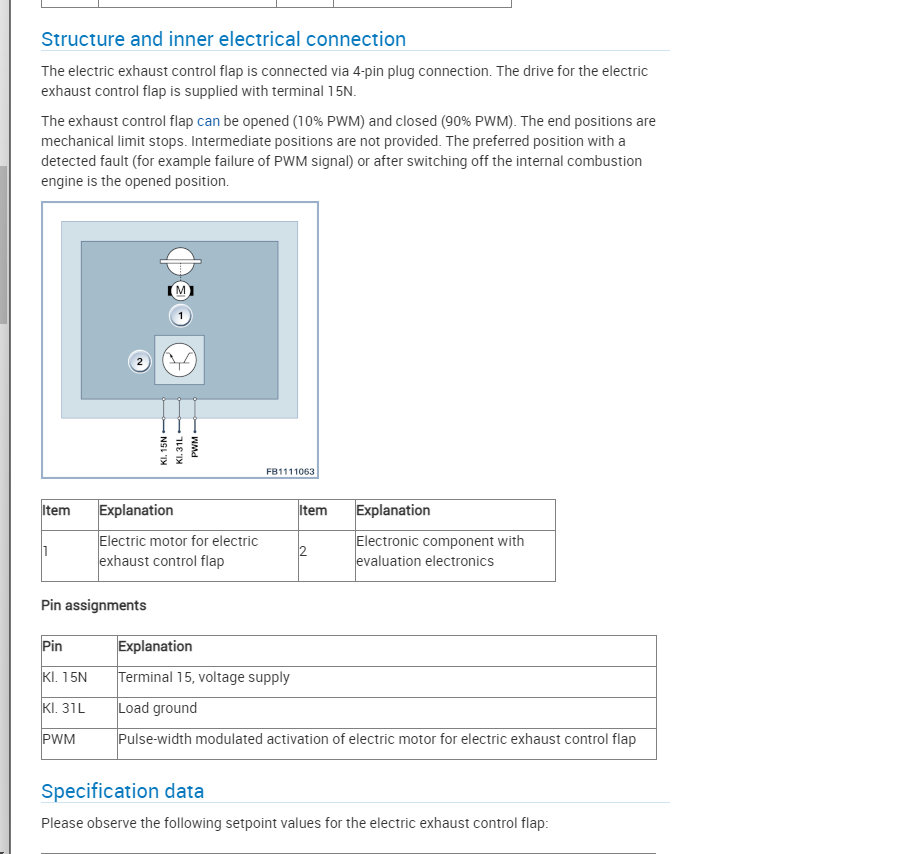

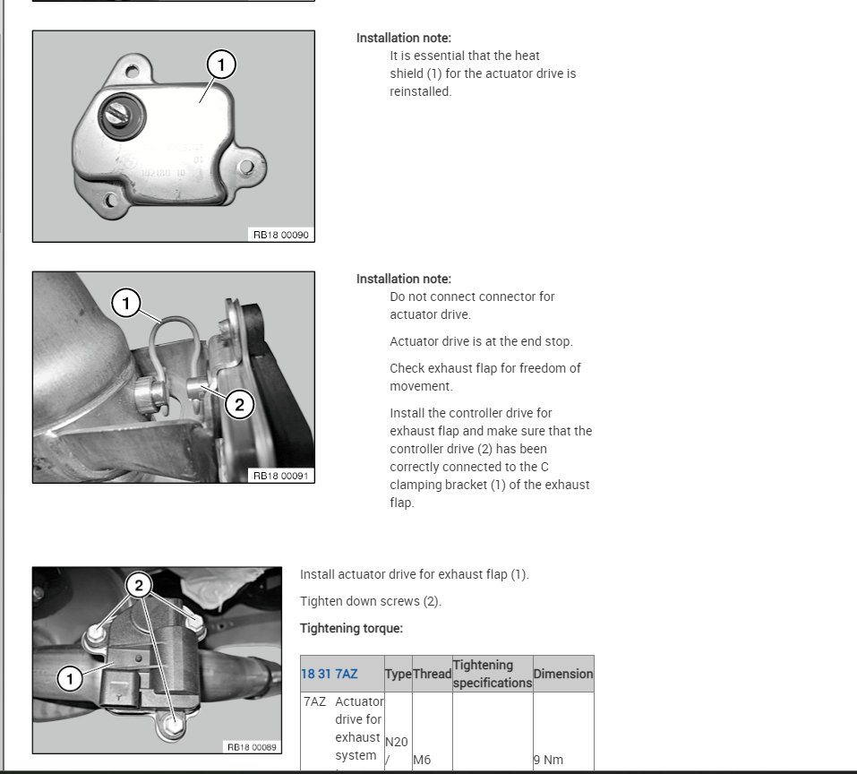

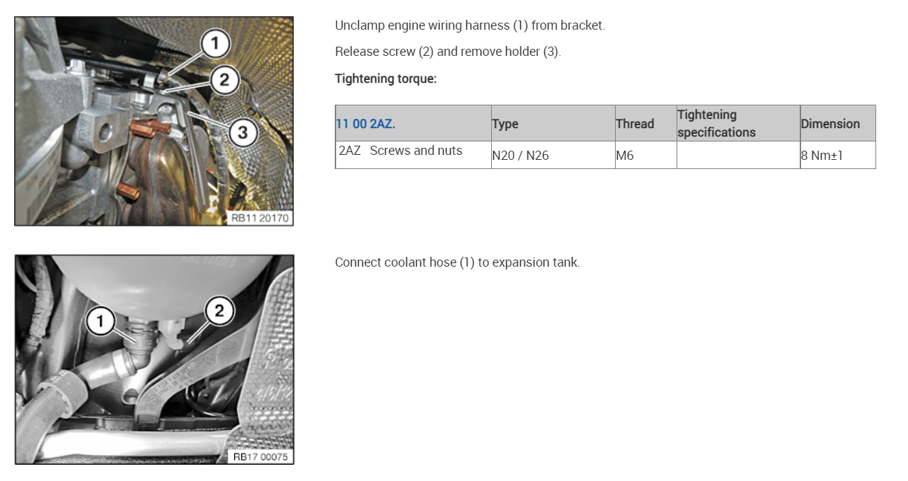

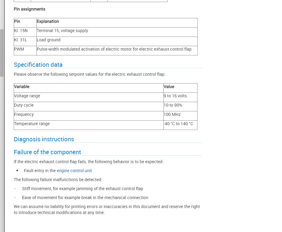

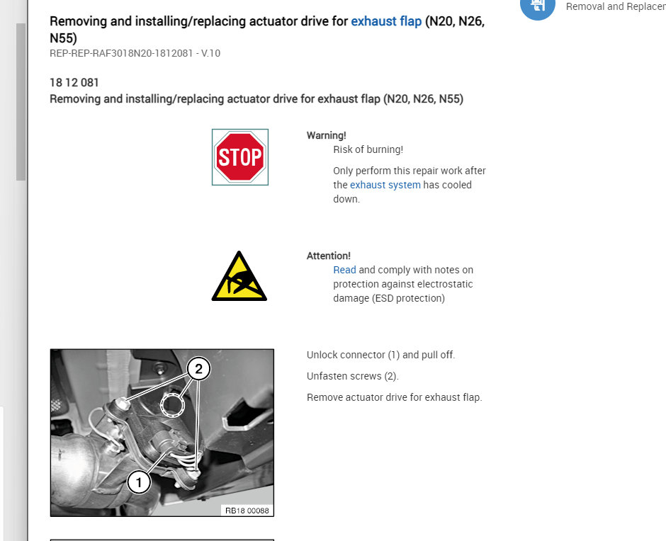

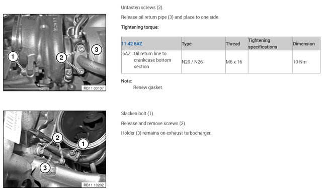

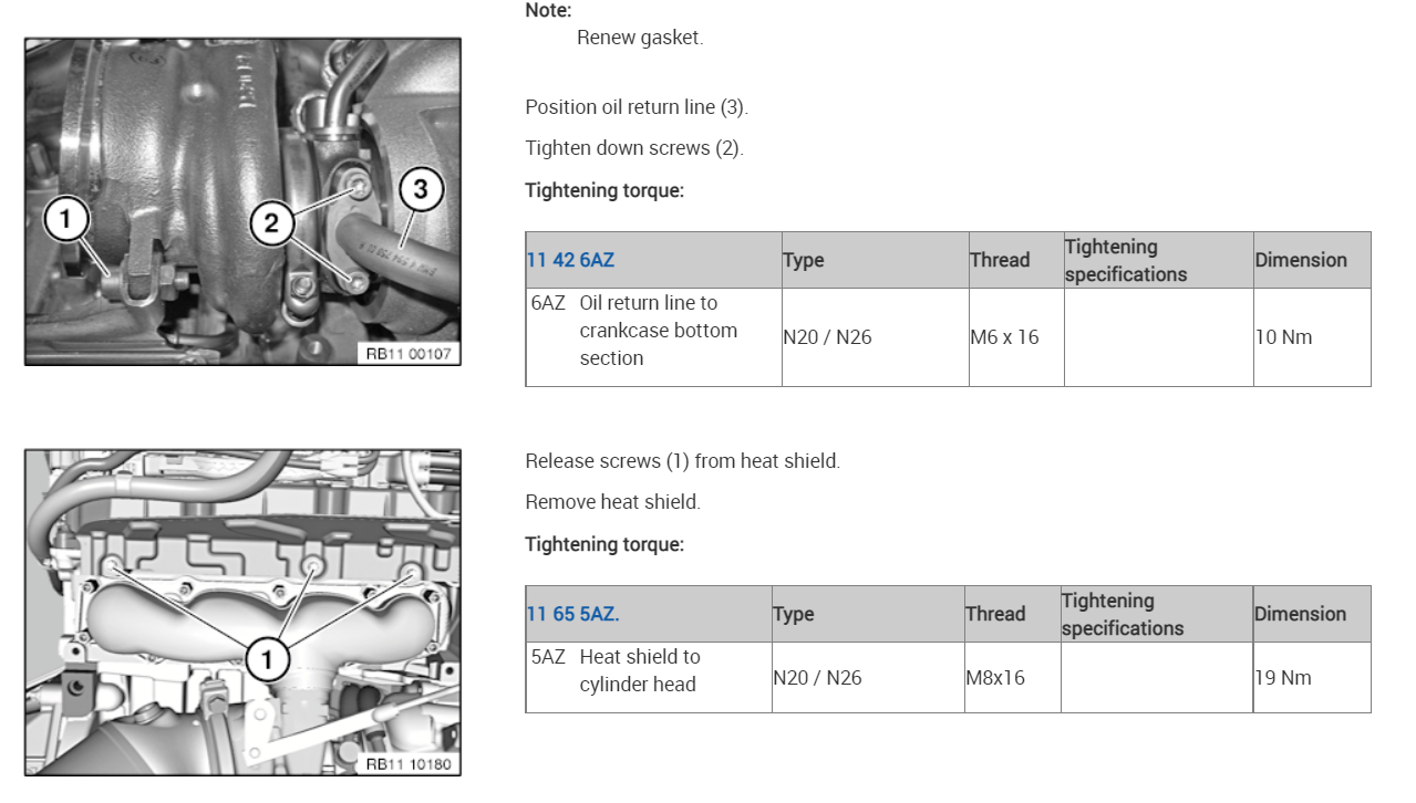

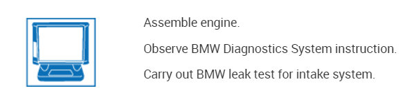

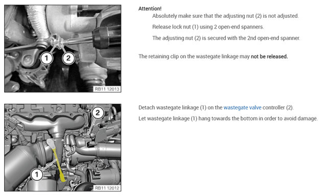

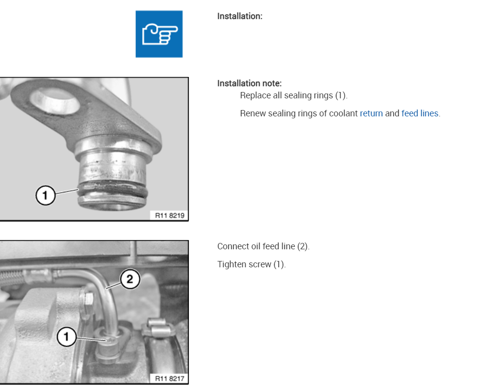

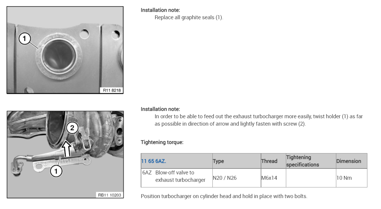

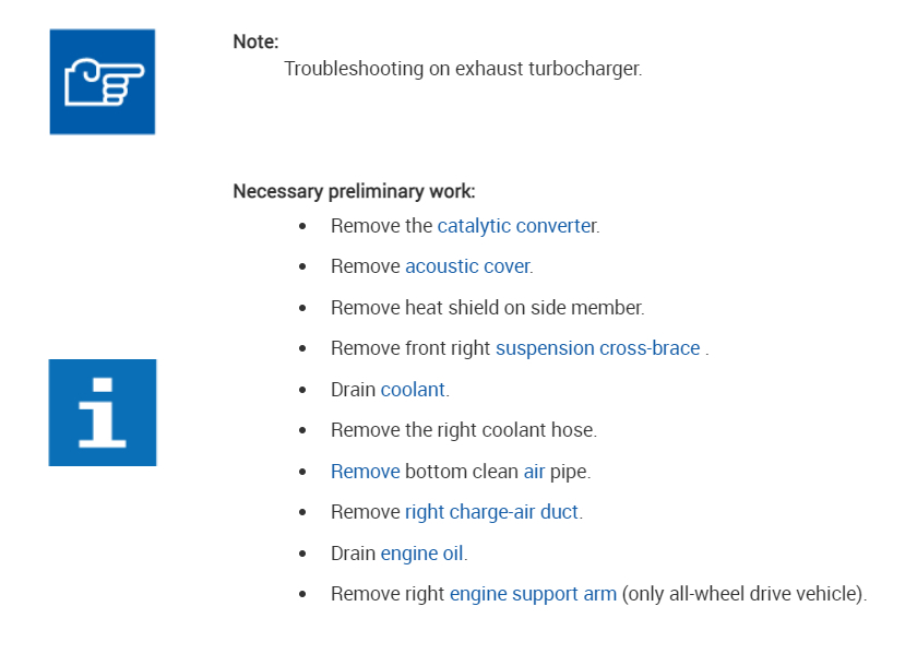

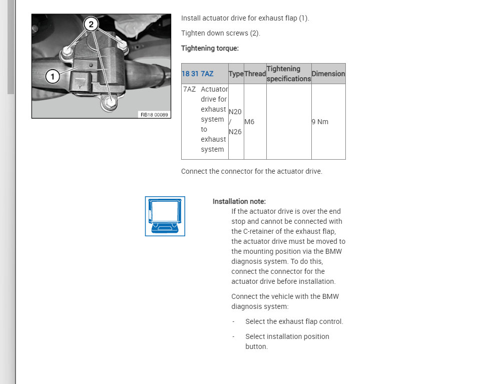

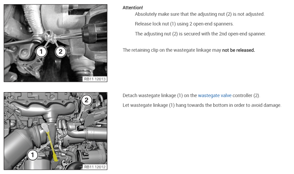

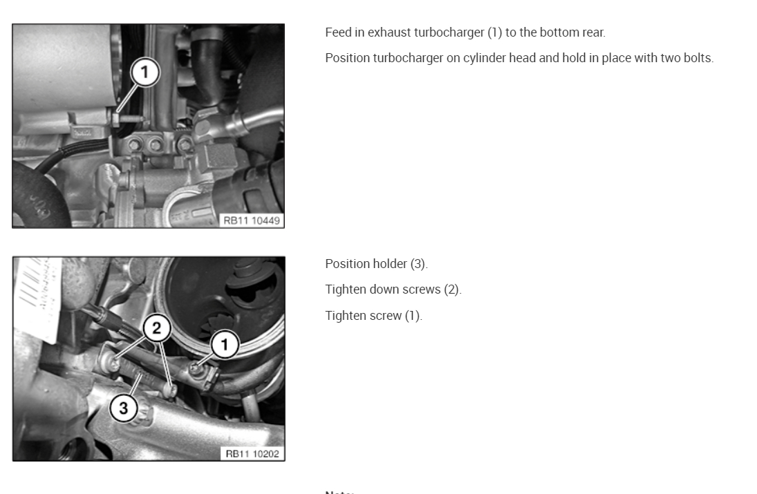

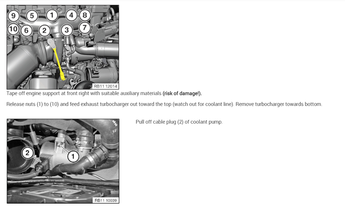

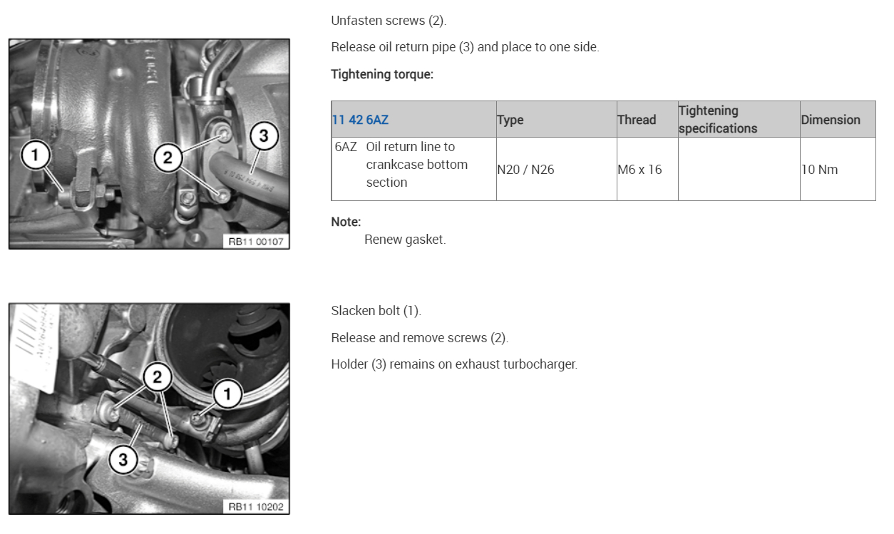

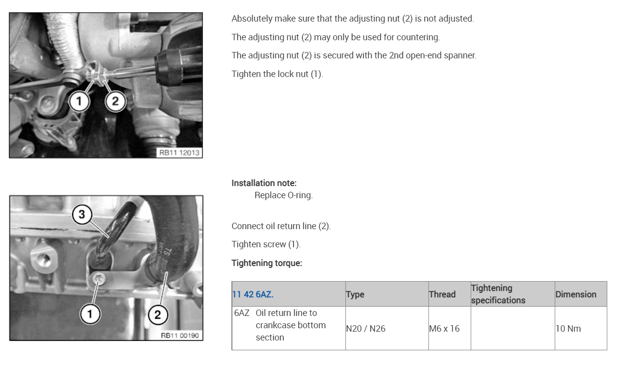

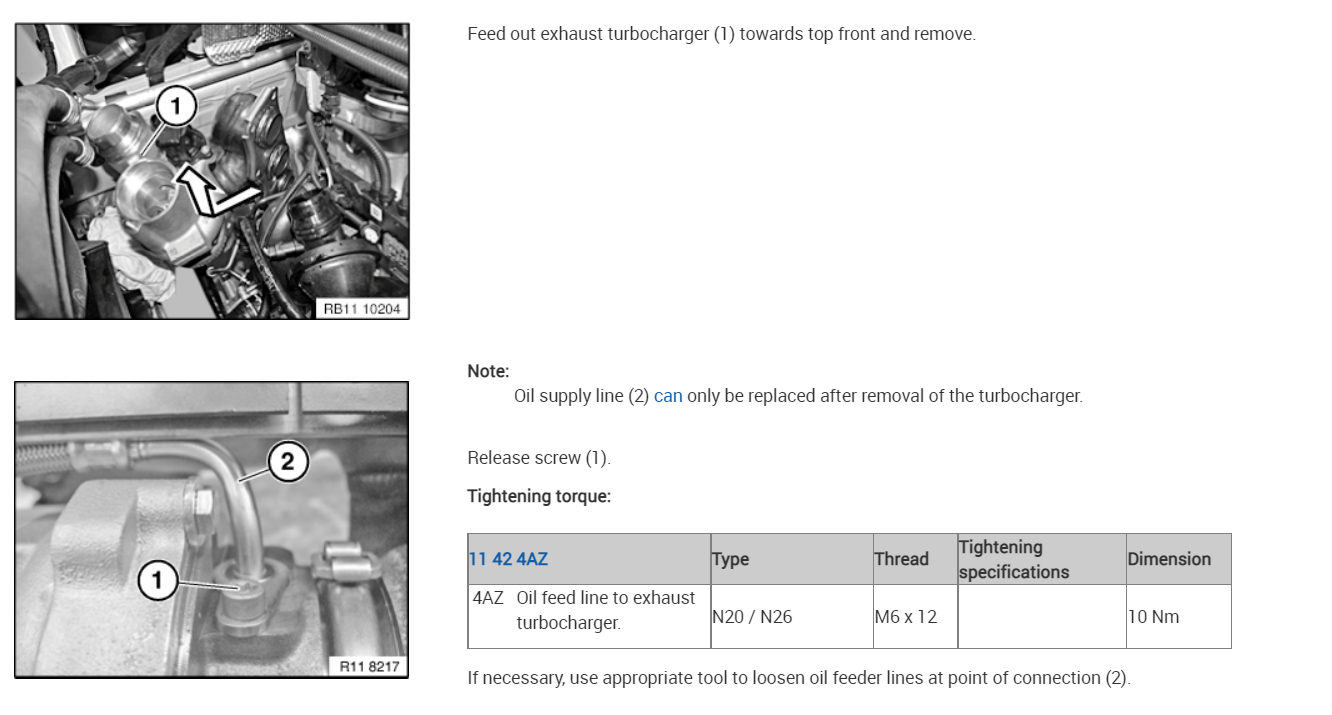

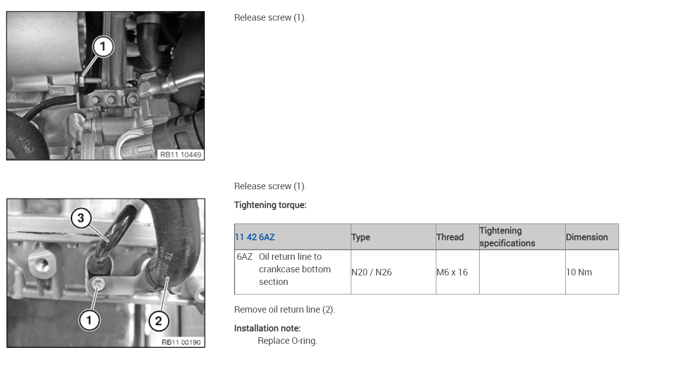

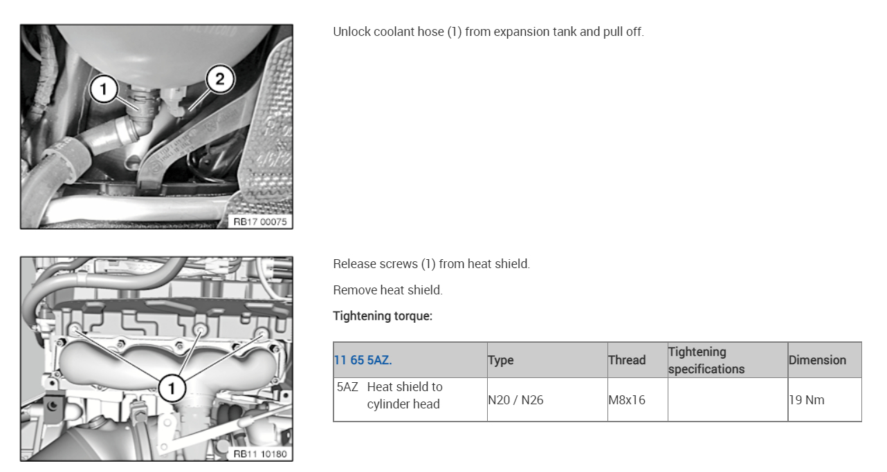

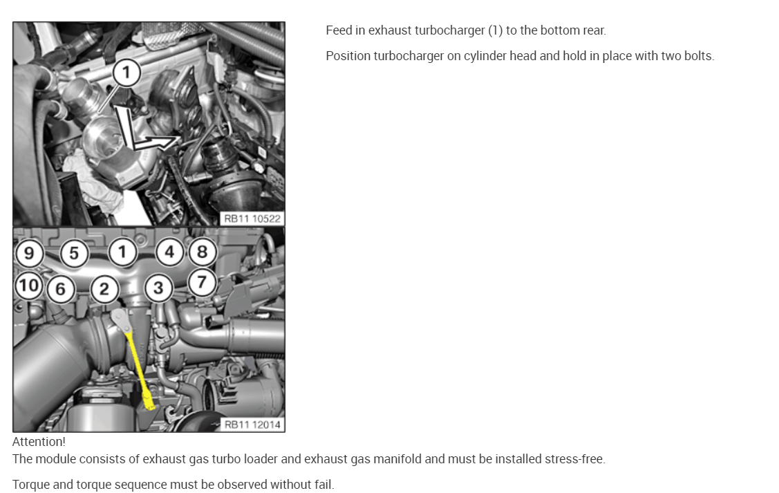

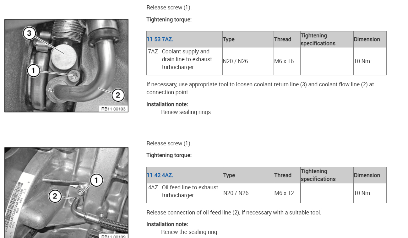

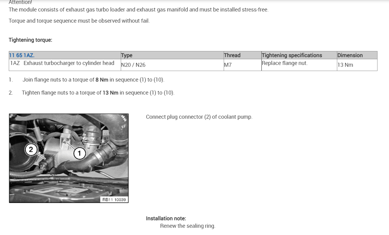

The flap is there to control exhaust flow to the turbo during low or no boost needed situations.

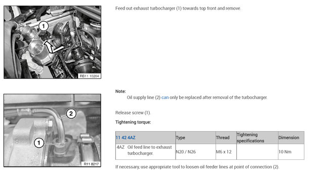

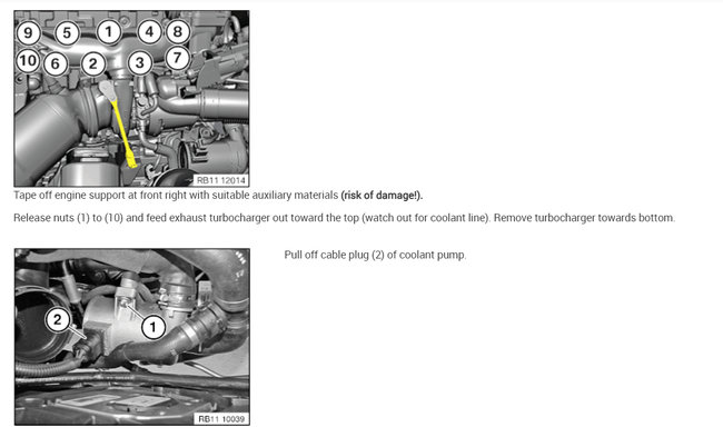

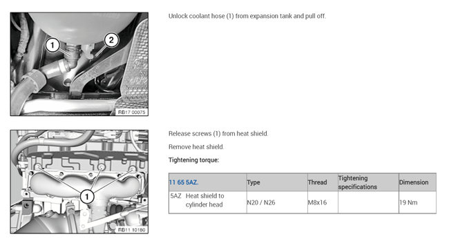

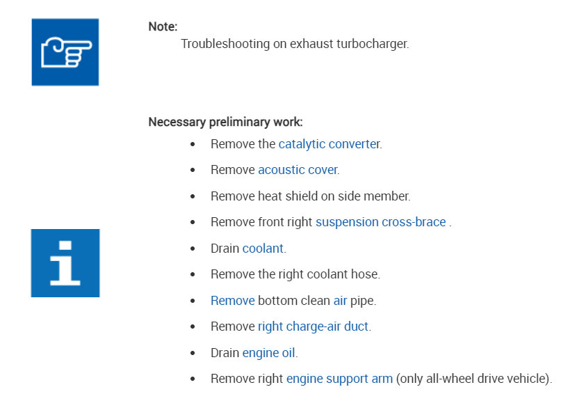

I am attaching more details about it below. The replacement of the actuator is below the previous post.
However, if this is hanging open or closed then it will cause the boost to be different than commanded and set this code.
I would access it and check for carbon build up as that will cause it to stick.
Take a look at this info below.
