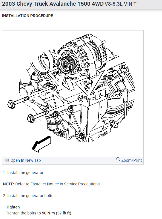

I need to replace my alternator, however, it doesn’t say on bad one what amperage it is. Will it hurt if it’s a 105 and I just install a 145? Please advise, and if it does need to be that specific amp where would I be able to locate it.

You want to make sure that the replacement alternator has the same output as the one in your vehicle. So if you have a 105A that is what you will need to install.
The best way to know what came in your vehicle from the factory is to call the dealer and provide them with your VIN. They can tell you what is the part number and the Amp rating that was installed from the factory.
