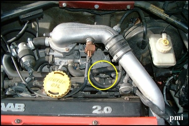

My check engine light is on with code 0340. Camshaft sensor. But I cannot fund the unit.

Hello, I am Danny.
Here is a picture of the location (attached) and circled in yellow. It is located on the front of engine, next to the camshaft gear. I have also attached a link for you showing how to replace. Hope this helps and thanks for using 2CarPros.
Danny-
https://www.2carpros.com/articles/camshaft-angle-sensor-replacement
