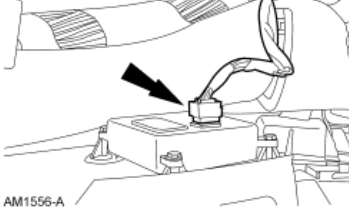

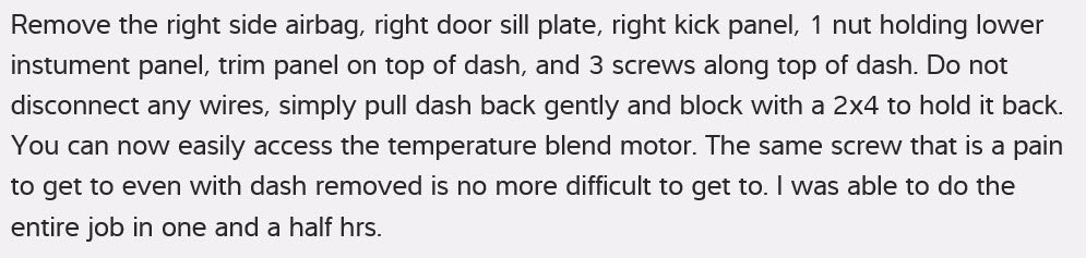

How to replace blend door actuator?
I have hot air blowing through the vents when I should have AC.
Jul 21, 2017 at 8:11 AM
HMAC300
  • 48,601 POSTS
try pulling fuse with key on first it may reset. then check for a broken door which dash and HVAC unit will need to come out to fix that. manual says to remove dash and console, but picture shows a shortcut, but you have to remove the airbag on right side. so if not familiar with working with those I would advise having it done professionally.
