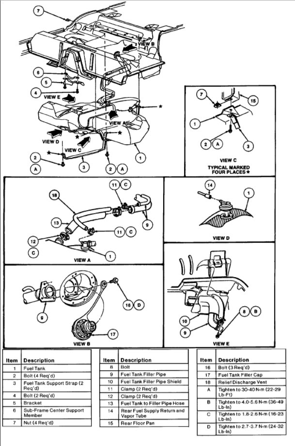

Yes, it sounds like you need to replace the fuel pump.
Here is a guide and some diagrams to help you get the job done:
You will need to raise the car up safely to begin.
and this guide will give you an idea of what you are in for when doing the job.
https://www.2carpros.com/articles/how-to-replace-an-electric-fuel-pump
Diagram (below)
Please let us know what happens and upload pictures or videos of the problem.
