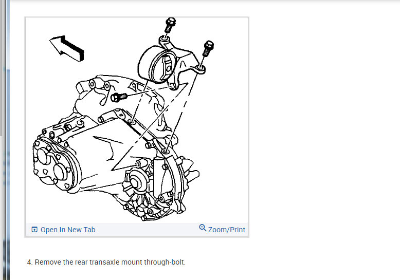

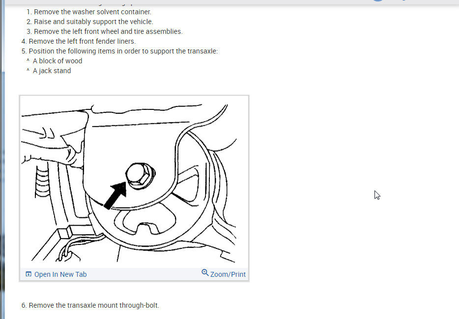

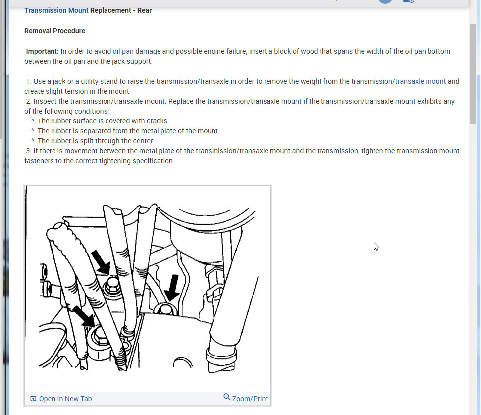

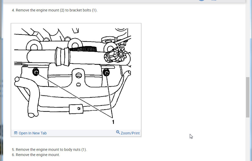

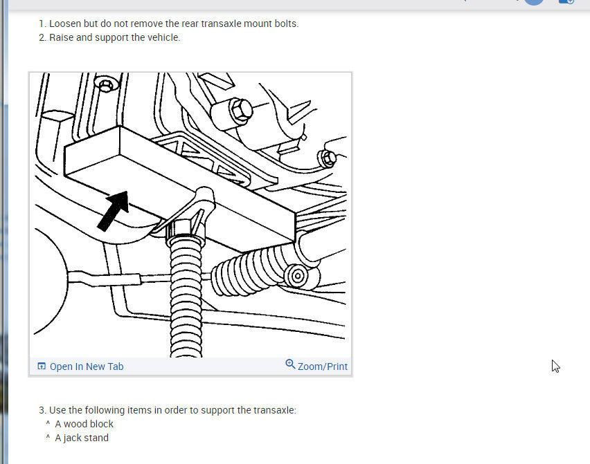

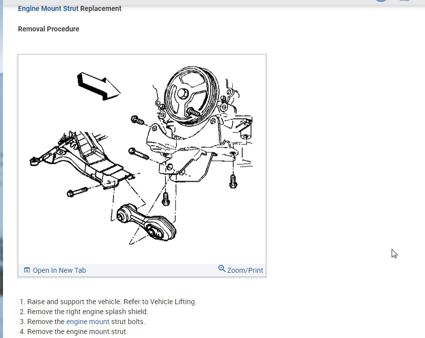

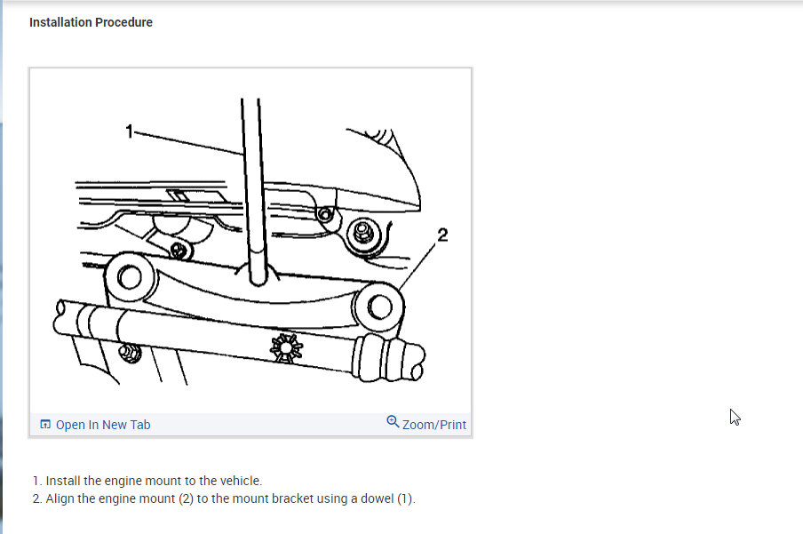

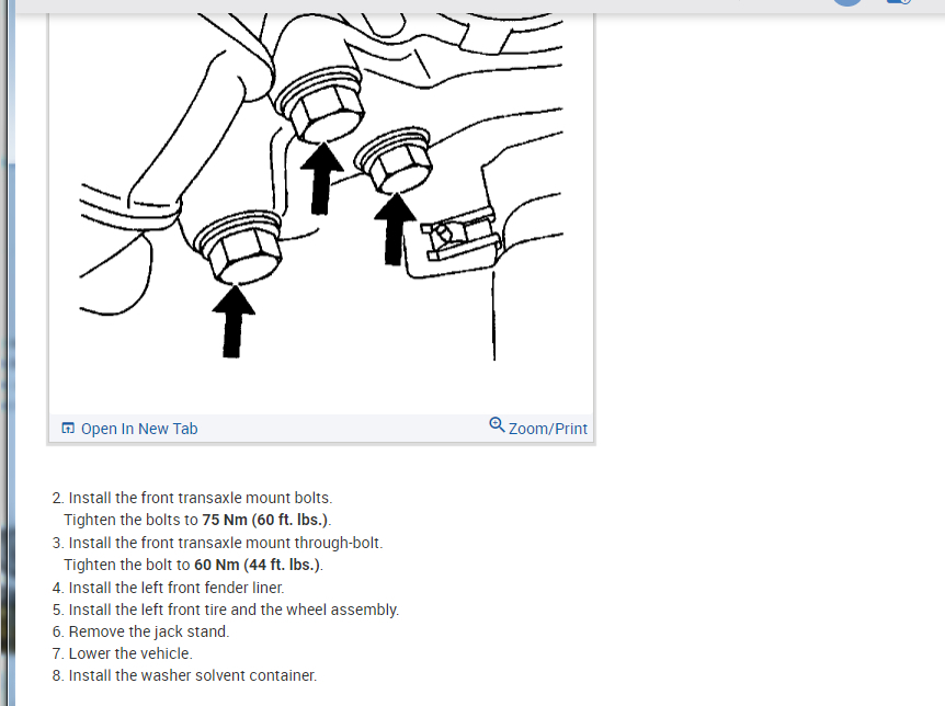

I have been told 4 in total, then I've been told there is only 2 in total.
Thanks so much!
Sabrina Mauhar
Jan 7, 2021 at 2:38 AM
Experienced Mechanic
18,907 POSTS

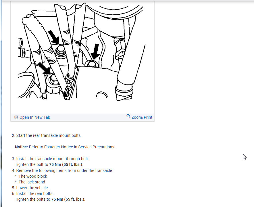

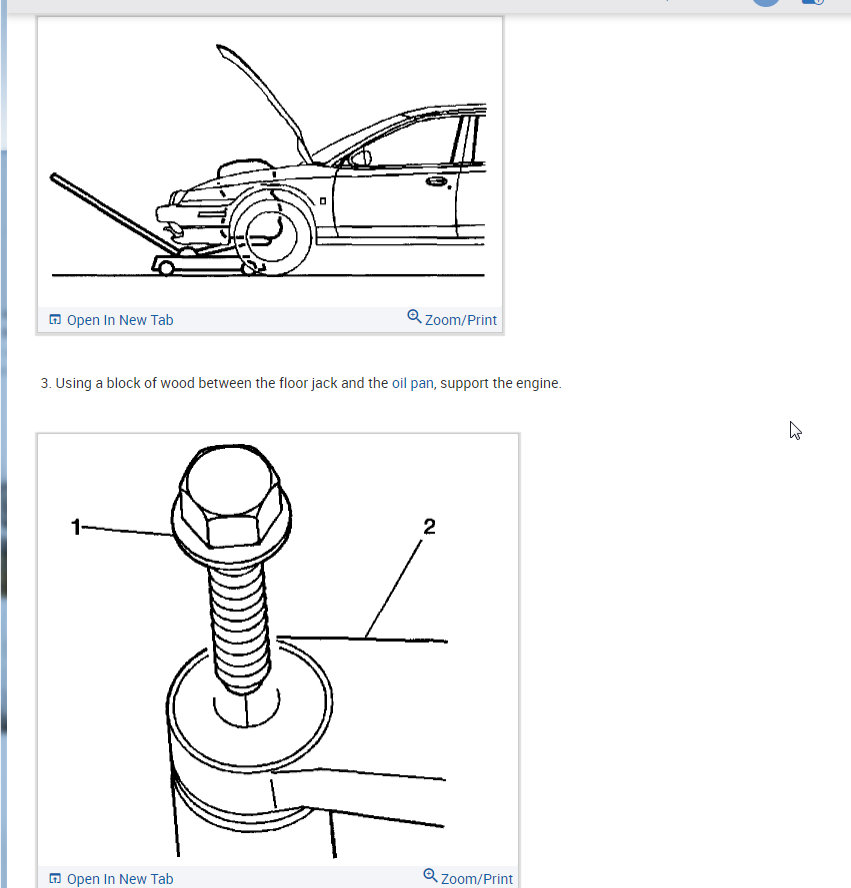

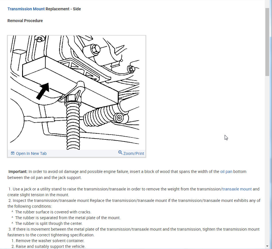

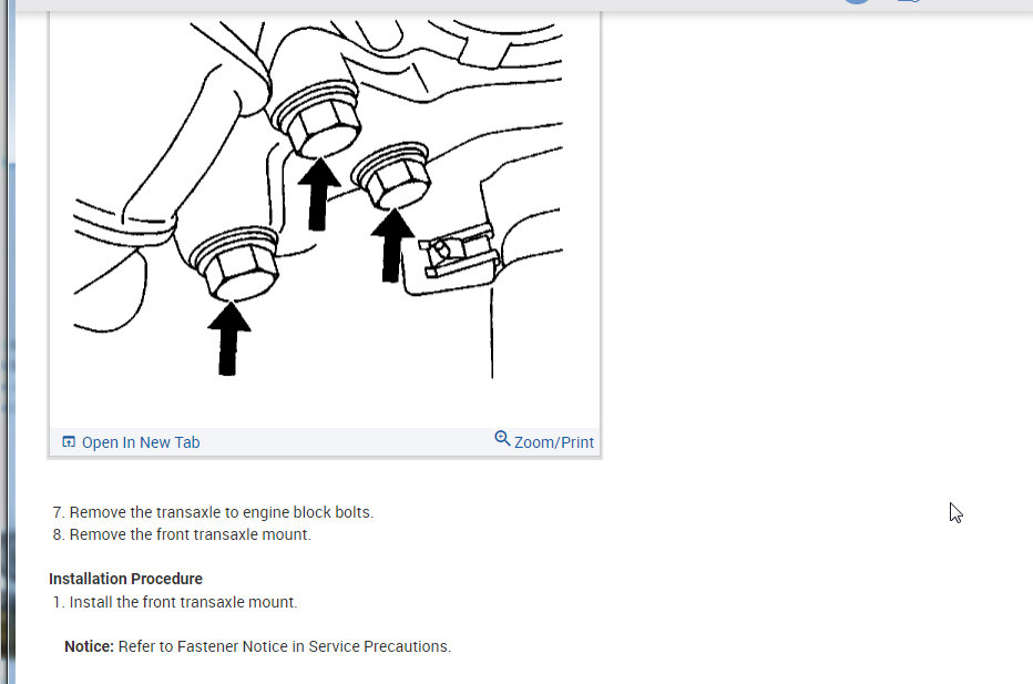

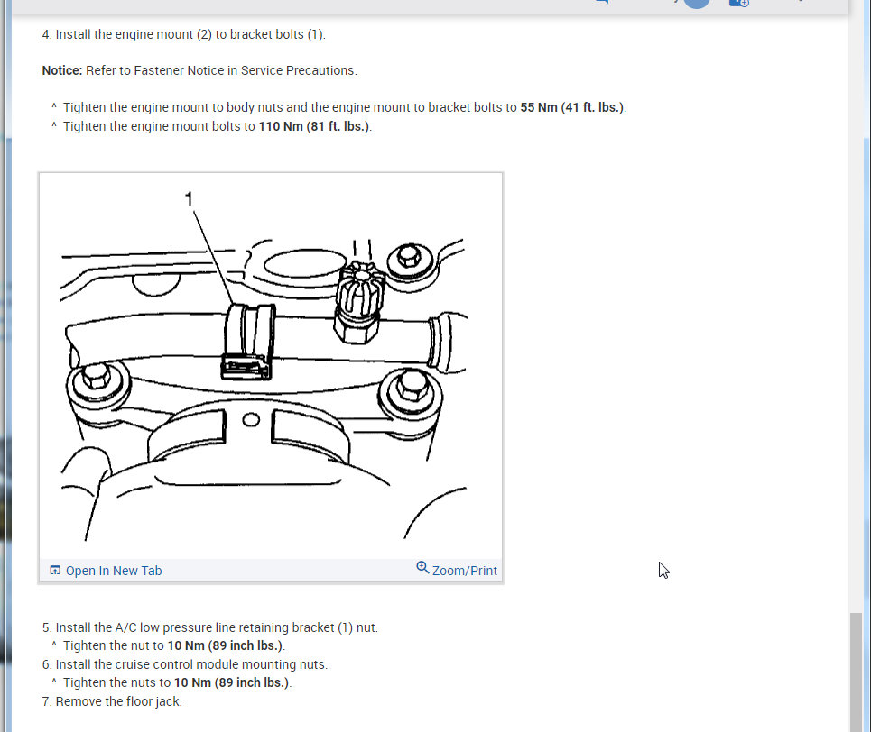

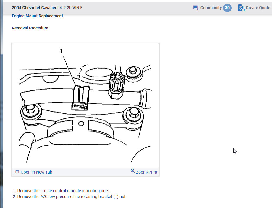

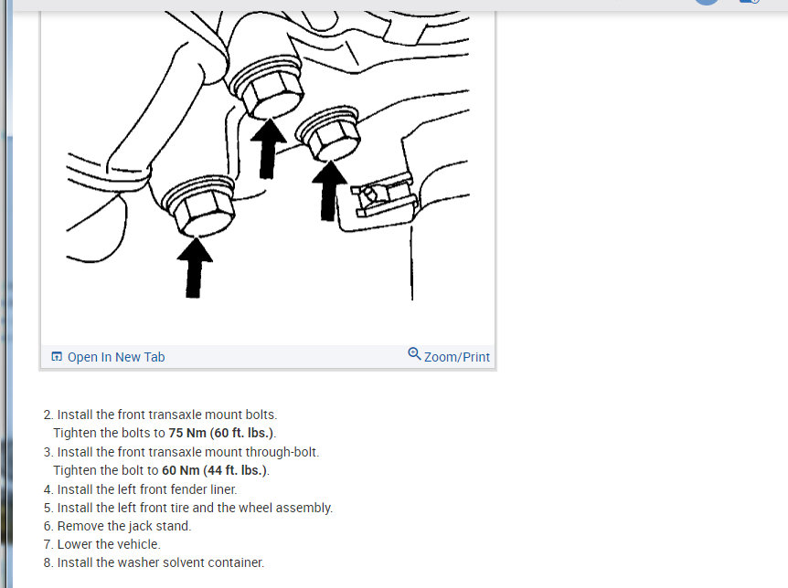

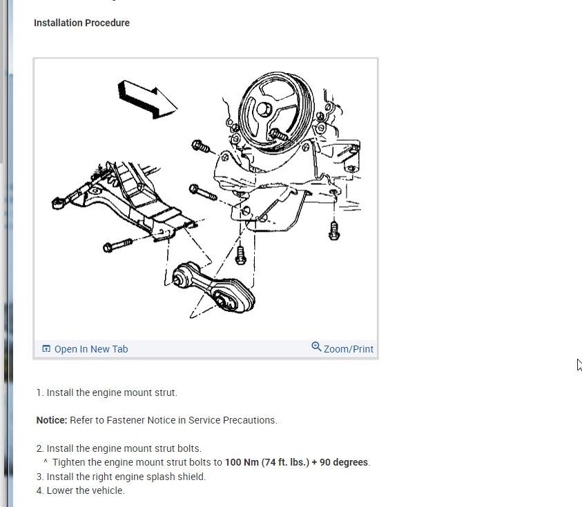

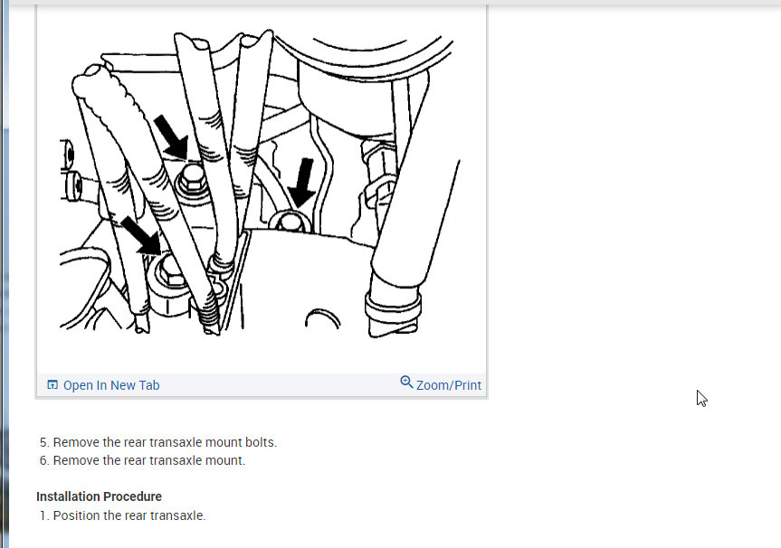

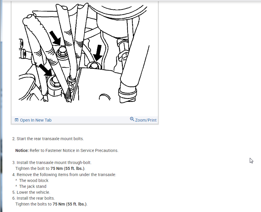

They are both correct but technically there are 2 engine mounts and 2 transmission mounts. I attached the process below for each of these.
Plus here is a video that will help with this as well:
https://youtu.be/mFDRuoF4NWk
Let us know what questions you have. Thanks
