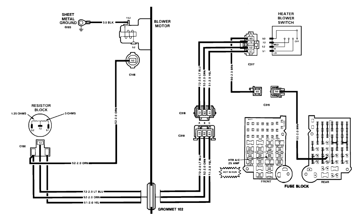

Can't define what color or #number vent door dial correlates with the 2 Actuators under dash on left side for the plenum flaps 1 has 2 ports and has 1. Number two (Electrical)? also, I can't clearly define were the extra single wires plug into the fuse box Eg: The pink brown orange etc..

Here is the heating system wiring diagram you requested. I've attached below. Let me know if you have any further questions on this issue. Hope this helps and thanks for using 2CarPros.
