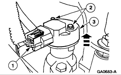

Can somebody please tell me where to find the camshaft positioning sensor location on my vehicle listed above? I t is a V8 all wheel drive 5.0 liter.
Oct 19, 2017 at 10:05 AM
STEVE W.
  • 15,410 POSTS
Up front of the engine mounted in the block above the water pump and timing cover. Where the distributor used to be. Has a three wire plug and two screws holding it on.

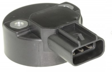

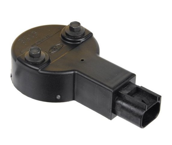

Thank you for the quick response. I will check there in the morning before I go to work. I found a sensor that looks like it just under where all the spark plugs meet up over where the distributor would be. However, when I un-clipped the clip it did not match up with the one that I was given from the auto parts store. I will have to check and see if maybe they gave me the wrong one.
Oct 19, 2017 at 11:17 AM
STEVE W.
  • 15,410 POSTS
There are both two and three terminal sensors. Yours could be either one depending on actual build date, but the three pin is the most common.
