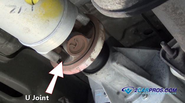

Universal joints are used at either end of a driveshaft to serve as a flex joint as the suspension moves while the vehicle is in motion, the rear joint is connected to the differential via the drive shaft.
u joint

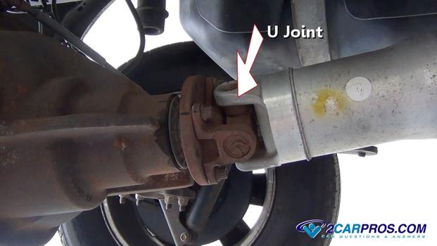

The forward or front U joint is located near the rear of the transmission and connects the driveshaft to the transmission tail shaft using a yoke. On 4WD vehicles the yoke is fitted at the rear of the transfer case in the same method.
u joint front

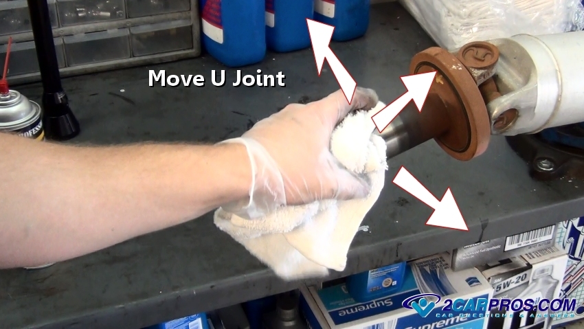

To check a U joints condition and wear remove the driveshaft, move the joint in every direction looking for hard spots or excessive play, a rust colored powder will also be present if the U joint has failed and needs replacement which is the result of metal contacting metal without lubricant under extreme pressure causing rust partials to be extruded.
