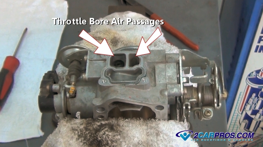

Step 3 - Air passage bypass ports are used to route air past the butterfly and through the idle air control valve.
throttle bore air passages
