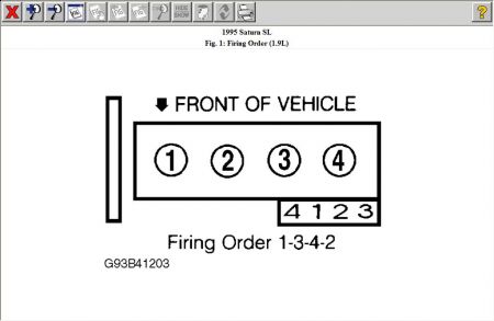

I need to see a diagram of the spark plug wires placement order for my 95 saturn, I think there may be one placed wrong.

There you go as requested for 1.9L

Can u tell me in whitch order to place each wire please because im still not getting any fire thank you

If you're not getting spark and you got the firing order as shown correctly. You need to bring it in-this one can be tough to deal with
