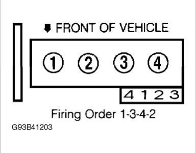

What is the firing order for a 1995 saturn sl1? Its 1.9 l 4 cyl.

Welcome to the forum.

I had to replace a coil so I was wondering but thank you for the response
