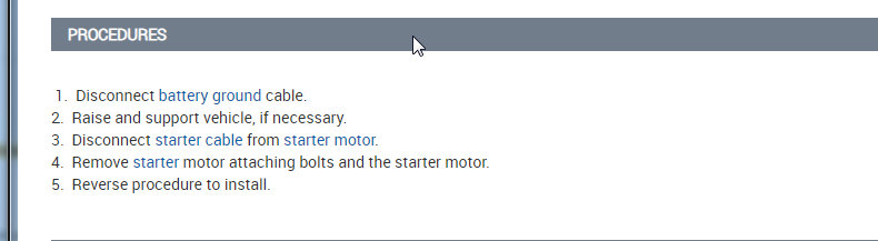

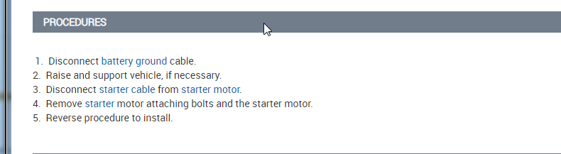

I am attaching the instructions plus some videos that will help with locating and replacing the starter.
https://youtu.be/5Jd2-wfIKOw
Please see the attachment below for more info from the manual. Let us know if you have questions. Thanks
