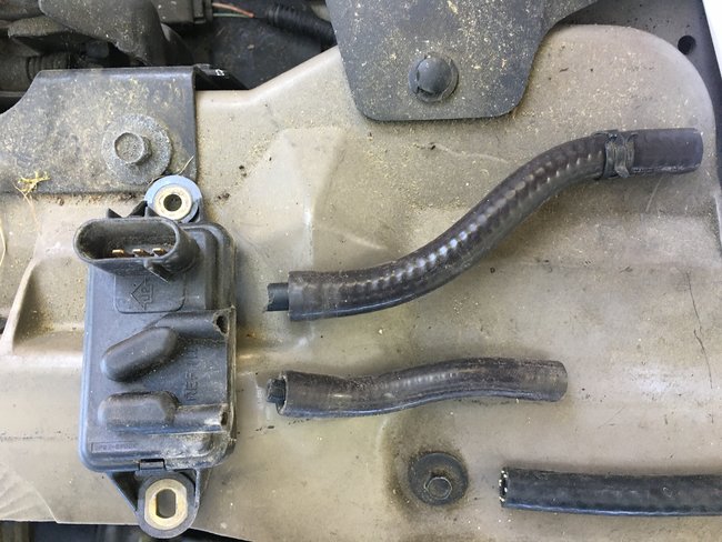

No I did not. I was under the impression that there were two different PTFE sensors and one had to have replacement hoses and one did not. And thinking I had the one that didn’t require new hoses, I didn’t replace them. So I guess I should try to find replacement hose for this? And will I need another new PTFE sensor? Or will this fairly new one still be usable?

Yes, replace hoses. They are special hoses and different sizes.

Okay so I’ve replaced both hoses on the DPFE sensor. After starting engine, check engine light illuminates. I turn off the engine and extract 3 TDC codes: P0102- Mass Air Flow sensor circuit low, P0113- Intake Air Temp. Sensor, and P0191- Fuel Rail Pressure sensor. From what angle should I tackle these codes?

Oh I also replaced the DPFE sensor with a new one.
Sunday, September 22nd, 2019 AT 1:59 PM
DOCTORD453
  • 46 POSTS
A picture of the old DPFE sensor and the hoses with the sensor tips broken off in the ends of the hoses.
Sunday, September 22nd, 2019 AT 2:01 PM

Okay so scratch that last message about the 3 DTC codes. I found that the Mass Air Flow sensor was unplugged for some reason. So I plugged it back up, erased the DTC codes from memory. Started the car and drove it less than a mile and it’s doing the same thing as before. Complete loss of power transmission very, very hard shifting. Didn’t think it would make it back up the hill I live on, but surprisingly it did. The hoses haven’t blew off the DPFE sensor but it acts just like they have. Don’t know where to go from here.
