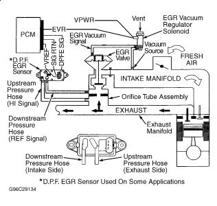

Differential Pressure Feedback (DPF) EGR Sensor
Faulty EGR Valve
EGR Vacuum Regulator (VR) Solenoid
Orifice Tube Assembly.
DPFEGR Sensor Pressure Hoses
Vacuum Lines
Wiring Harness Circuits (DPFEGR, EVR, EVR PWR, SIG, SIG RTN & VREF)
Faulty Powertrain Control Module (PCM)
