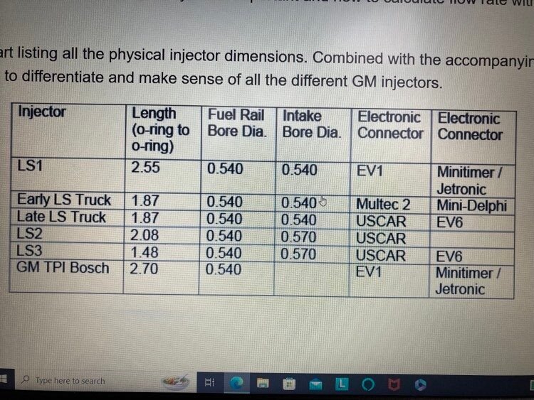

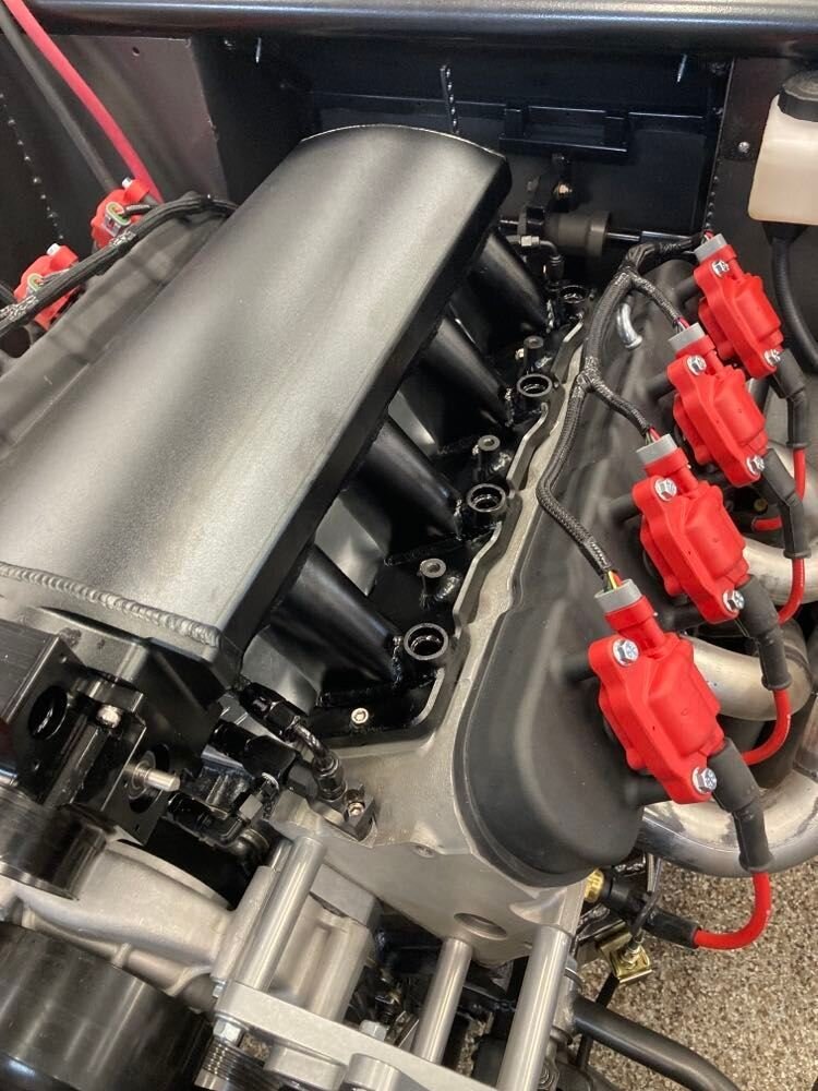

I need some help please. I am trying to install DeatschWerks Fuel Injectors 35U-01-0044-8 into a Summit manifold SUM-226125B and I'm having a great deal of difficulty getting the injectors installed. I have ruined almost all of the O-rings on the end of the injector that goes into the manifold despite using the supplied lube. I can't even get them into the manifold by trying to install them individually. This is the manifold/injector set that was featured on your 2Car Pros YouTube channel that Summit sponsored, so I know the manifold and injectors are correctly paired. I am not a beginner at engine building so something seems off. Please help. Between the manifold and the injectors, this is a big investment for me. I have attached some pictures. The manifold injector bores are .540" and the o rings are about .575". That sounds like a lot of interference to me. I saw in the comment section when you installed the injectors that someone else was having the exact same issue and you recommended some kind of generic Amazon o ring kit, not the kind of response I hoped for. Did the issue ever get resolved? Please help!

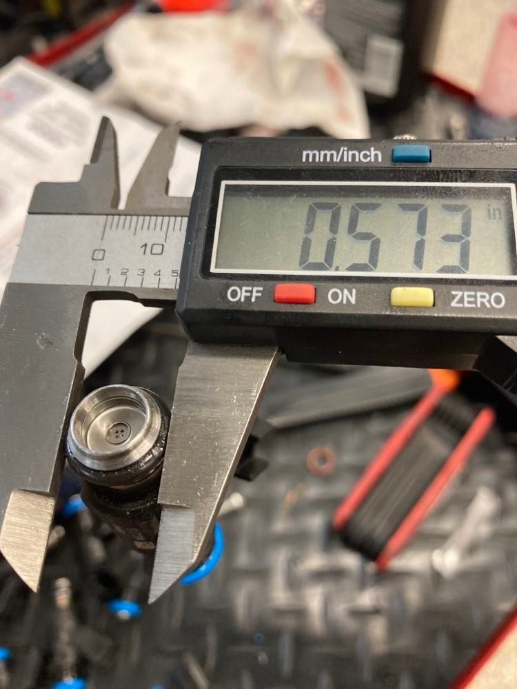

The injector o-rings are correctly sized per spec by DeatschWerks. They have been helpful. I've ruined all the injector o-rings trying to install them. DeatschWerks has confirmed that the 35U injectors are not suitable for the small-bore Summit intake and have spec'd out a different injector set for $500.00 which I can't afford right now.

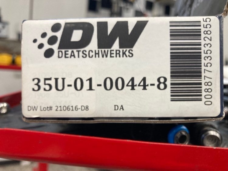

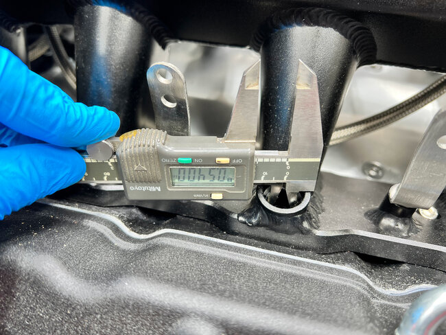

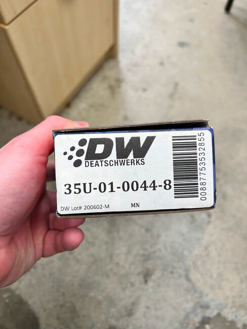

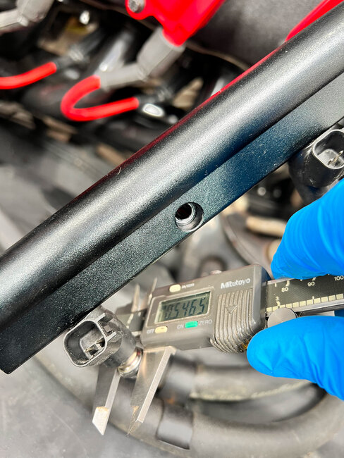

Have you looked into getting different sized O-Rings? It would be much cheaper than getting new injectors. Because I measured mine just now, I found a gap in my schedule, and they are at 0.05465 which is perfect. I did not get different O-rings and I can confirm they sent me 35U-01-0044-8 see pictures below. I even confirmed the injector hole size my Summit intake is right on the money and so are my injectors. Maybe they put the wrong injectors in your box or maybe my box?

This is very helpful information. It appears that there is no issue with the manifold as mine measures the same as yours. The o-ring you have measures .025 smaller than mine. That is the issue. I will now follow up with the injector company and Summit and I will let you know what I find out. You have been very helpful, thanks!

Well, that didn't go well. I forwarded all the info and pictures you sent me on to Levi Graham at DeatschWerks and he basically accused you of fudging the measurement on the o-ring to get what you wanted. He emphatically stated that the 35U injector in question has never been shipped with anything but a .571 diameter o-ring and that "somebody" put a mongrel o-ring on there to make it work and they are absolved of any responsibility. So, I know it's not your problem but with you being in the repair business, is there any way you can determine what o-ring you actually have on your injector and a source for it? I'm thinking if you order a replacement set of those 35U injectors today, they won't fit your manifold. I appreciate all that you've done to help me, but I'm still stuck.

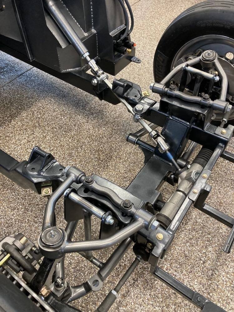

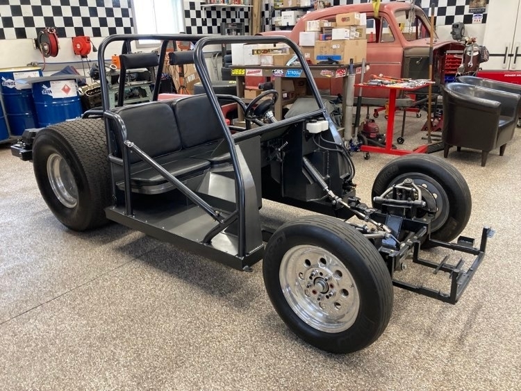

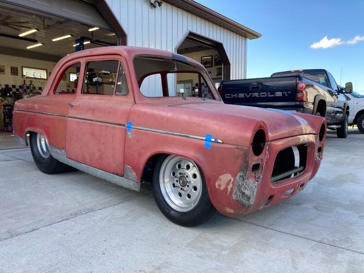

Glad you enjoyed it. I ran it through 4 heat cycles and then changed the oil and filter. It's going in a 1959 English Ford with a custom chassis I made. BTW, it's a 408. Also, a pic of my 1958 drag car. And video here if it works and you are on Facebook. It was a licensing pass. I was only supposed to go 1/8 but did the quarter.
