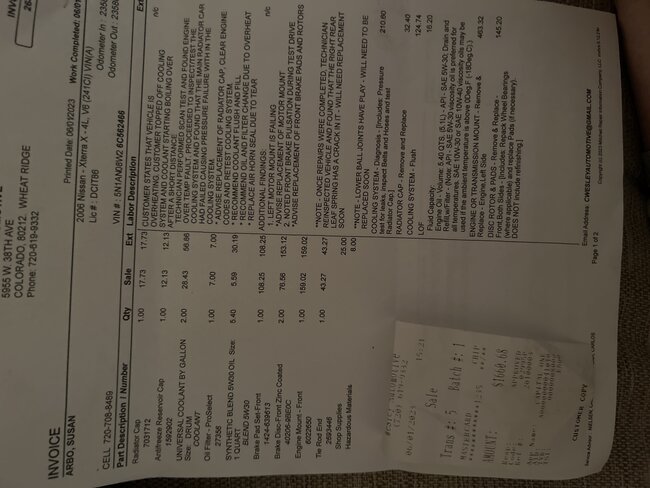

Outcome after $2100 paid repair, owner states now wants $5,500+ to replace transmission.
I am a single disabled woman and tomorrow I will be chronologically 68. On May 30 I decided to take my vehicle to be fixed. I chose to go to a shop I had never previously used. The vehicle had started having issues with overheating. Initially I tried Auto Zone for the purpose of discovering what information could be gathered from diagnosing the check engine light. The tech determined simply overheat.
The service advisor called and informed me details noted on photo. Since they had found numerous other issues adding much more money, I asked to speak to the owner before authoring the work. I asked him if I could be certain that if they proceeded the radiator, cooling system and air conditioner would be died and he replied "absolutely".

I'm looking at the receipt expecting to see things related to the overheating, but I see many other things as well. For example, brakes, rotors, tie-rod, and then two gallons of coolant and two radiator caps. an oil/filter change. I'm confused.
What are they telling you as far as the transmission? Did they provide you with evidence or a reason they suspect the transmission needs replaced? As far as getting money back, that is a tough one that leans toward the legal system, so I'm not sure what to say, but I still don't see what was done to repair an engine overheating issue.

They only replaced the cap. I trusted them and that is why I agreed to all the other things. He also gave me 2? additional estimates totaling around $4000. I could not afford it so he said do it as fast as I could.
The only thin that needed to be done was soil change , service air condition and the overheating. I was shocked he did not replace the radiator. The front brakes
Seemed fine to me. Unfortunately I did not question him.
After only approx 26 miles of driving it would not get out of first and only 6 miles an hour. I was told by the rude Louie the radiator fluid had leaked into the transmission. When I questioned him he blew me off rudely saying there was no way to check if the part that caused the fluid to leak in to the transmission. He continued saying they could not tell the future and I must have bad luck.
Charming
Sorry that was a long way of saying all they did was not enough. The bill says he pressure test for leaks and inspect belts hoses. However there are posts that say you find the problem doing those things. You find a crack with pressure test. So I guess he just changed the cap.

If it was two gallons low on coolant, it went somewhere. One of the places it can go is the transmission. Inside the radiator, there is a cooler used by the transmission. If the trans cooler in the radiator fails, it can allow coolant to mix with the transmission fluid and trans fluid to mix in with the coolant. Is there anything on the receipt indicating things like the transmission fluid or engine oil was inspected for possible coolant mixing with it?

Joe, there is nothing. The copy I sent originally was everything. I was told that it is not something that should have been checked. Spoke to a few Nissan representatives and they confirmed everything you stated.
