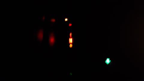

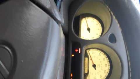

Car started with stalling put a couple times at low speeds/idle. doesn't seem to respond to gas pedal being pressed most of the time. Loud popping sound from engine compartment. Have replaced every component on throttle body the apps sensor AIC, and TPS. Still stalling out after starting. wont even run for maybe a couple seconds then rpm's get low and it does repeatedly.this is only car so what to check next would be greatly appreciated. thanks

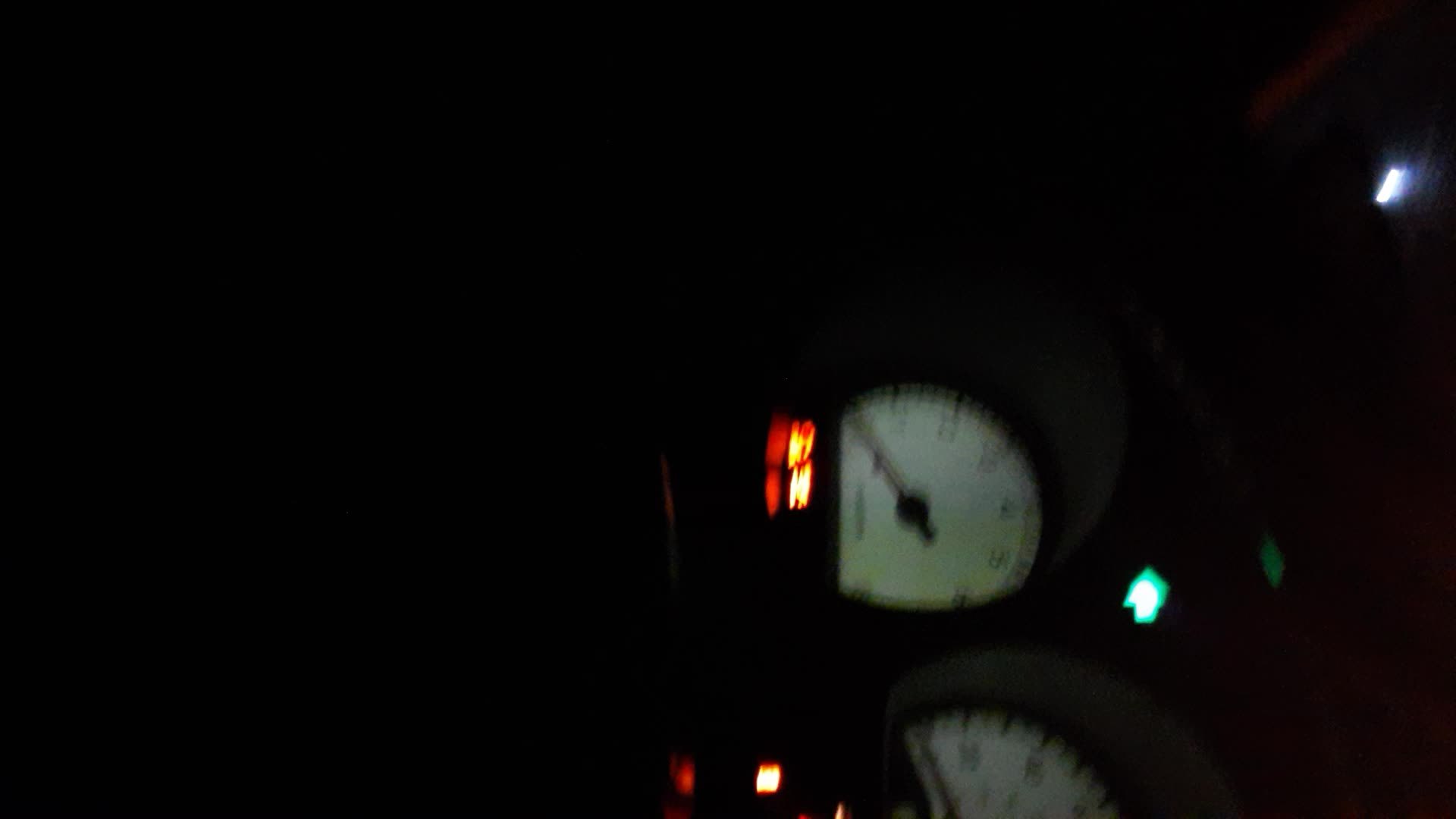

Also, just adding. have replaced pretty much everything on fuel system in past couple months but did get used from junkyard . Just now went out side to listen for fuel pump I heard it clicking but it is hard to hear on my car. then it started and ran perfect until I get it to about 3,000 rpm's it started shaking and then another minute or two just letting it run I was not revving it or anything it shut off again and now it's doing the same thing bnb just cranking it wont turn over and run. Any help would be appreciated.

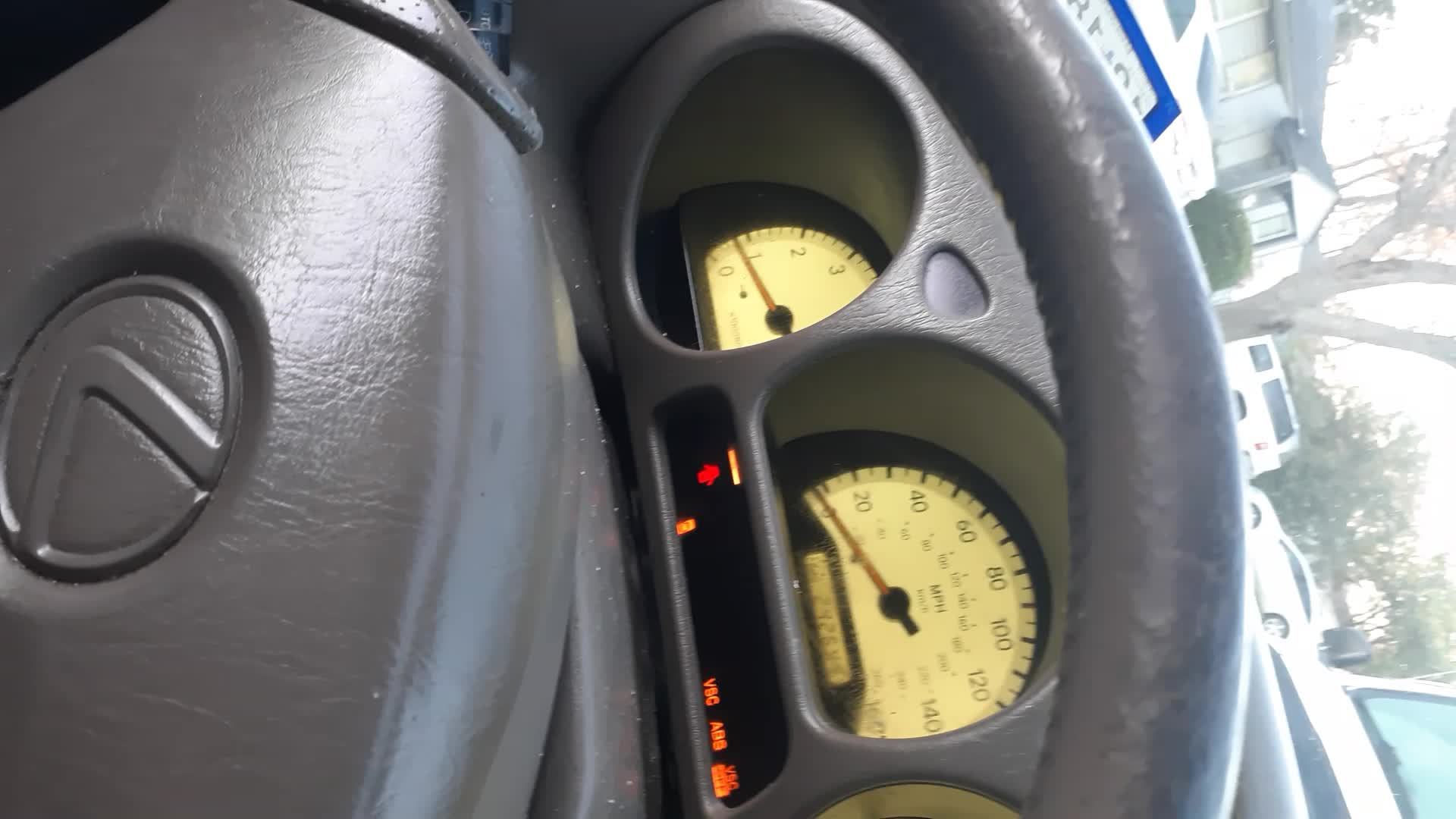

In the video you shot it appears that the check engine light is on indicating there are trouble codes stored in the computer as would be expected.
Here is a link to our tutorial on checking the codes: https://www.2carpros.com/articles/checking-a-service-engine-soon-or-check-engine-light-on-or-flashing
If you could retrieve the codes and let us know what they are that would be the best place to start. Please let us know what you find and we will be more than happy to help you further and thank you for using 2CarPros!

I managed to push it home went back out there a hour or two later and the check engine light was off! It's weird because it's been coming on and off by its self without resetting it and right now it's off. I'll barrow my friends scanner if I can find a ride over there and update you when I get a chance.

The check engine light only flashes at about 5,000 rpm's then goes back off. any idea why but would do that or what it means?
