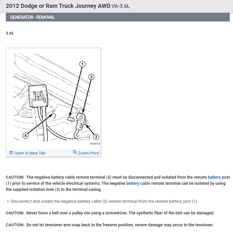

When getting a boost, it will stay running soon as it comes off the cables it cuts off. Why is that?
Jan 26, 2022 at 11:30 AM
SQM
  • 6,383 POSTS

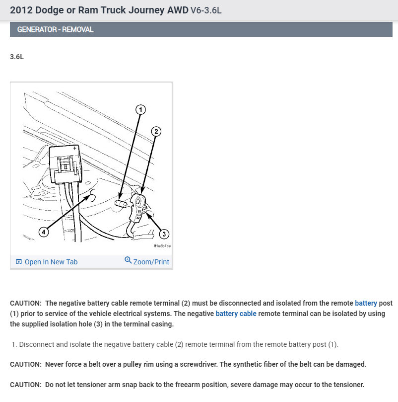

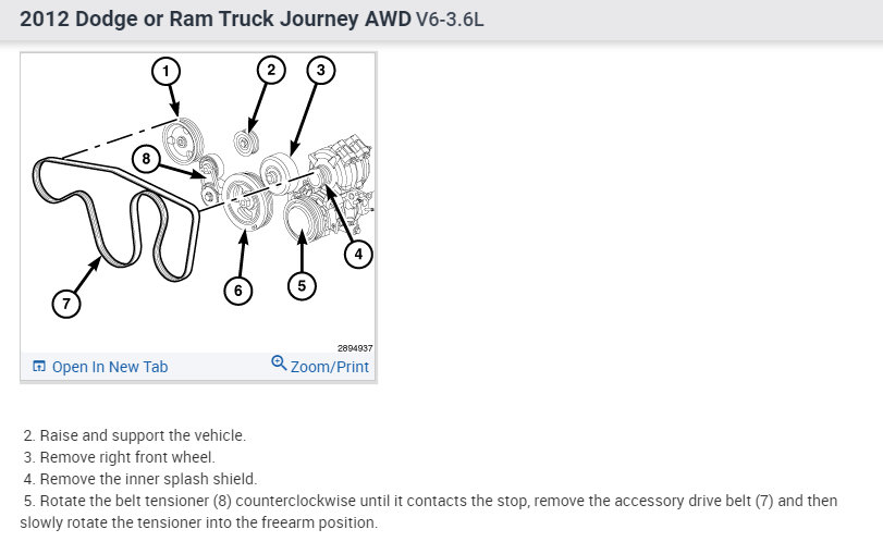

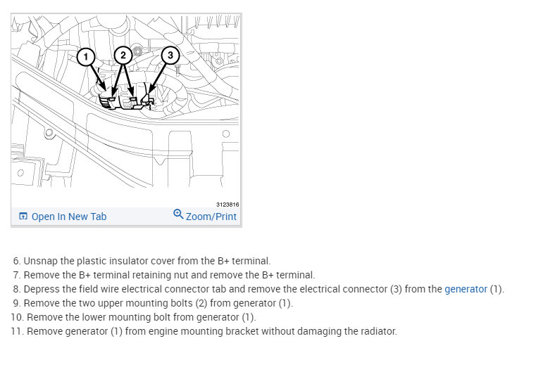

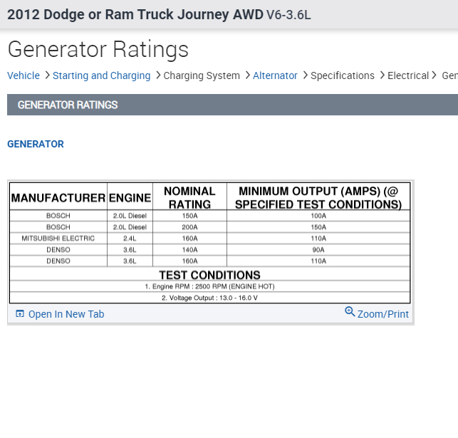

It sounds like you might have a bad alternator.
When the alternator fails it is unable to charge the battery and that leads to the engine shutdown.
One way to test the alternator is to check the output to the battery with the vehicle running. But since the vehicle stalls as soon as the cable is removed, the best option would be to remove the alternator and have it bench tested.
Most auto parts stores have bench tester that you can have them test for you.
https://www.2carpros.com/articles/how-to-replace-an-alternator
