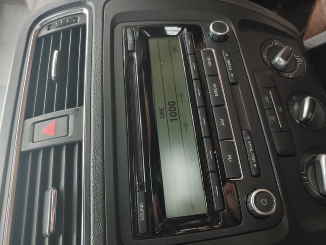

My husband checked the air filter under the hood, and I don't think it's related. My lighter outlets have not been working, and my horn wasn't working. He found the fuse that belonged to that and checked it. It was blown so we put a new fuse in. We went on a drive, and when we came back, I turned the car off. Forgot to put the windows up so I started the car again and it will turn on but won't stay on. Now my windows won't roll up either. The button in the glove box was also pushed. On top of that, my instrument panel where the speed is, lights won't turn on. Belong with my radio giving an error code that says "Safe".

The idea that the radio says safe mode means it's been locked down. It sounds like power was lost to it.

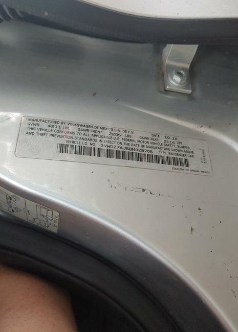

I will need to have the manufacturing date from the vehicle. VW loves to change fuse locations constantly. It should be on a label on the driver's side door frame.

The radio now doesn't work, and i did not purchase this care brand new, and when i got it, there was no owner's manual to find the code.
I believe the manufacturing date is 10/10/2011.
I attached a video of the issue, and a picture of that lable in the door frame, along with a picture of the radio.

That's the date, but it's 10/2010. By 10/2011, the 2012 model year vehicles were being produced.
