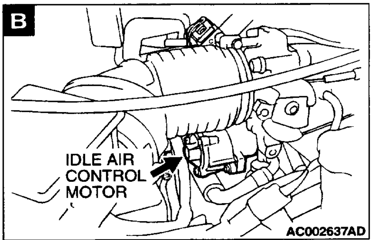

Got a tune up and bought a new battery. Car will start but won’t stay cranked.

So it sounds like the engine will not stay running, correct? Can I ask if you have a check engine light on? If so, let's run the codes to see which ones are stored, this guide can help:
I can tell you have seen the IAC motor stop working and cause this issue. Here is the location so you can remove it and either clean it or get a replacement.
This guide can help as well:
Check out the images (below). Please upload pictures or videos in your response of any problems so we can see what to help you with.
